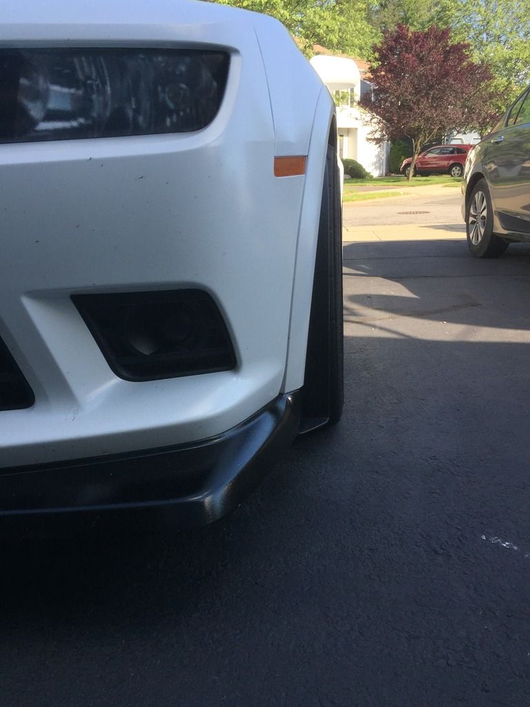

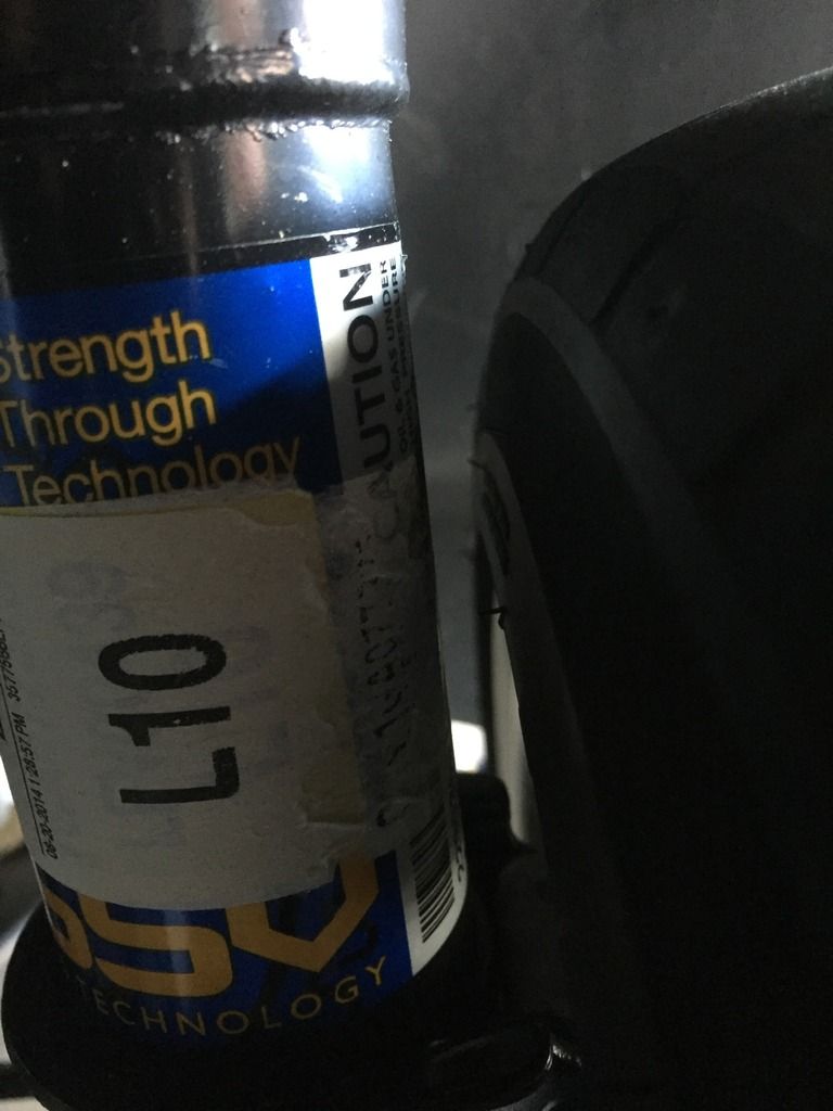

I have been running this setup for a few weeks now, I wanted to wait to post until I was able to fully road and also track test this to see if there is any adverse affects.

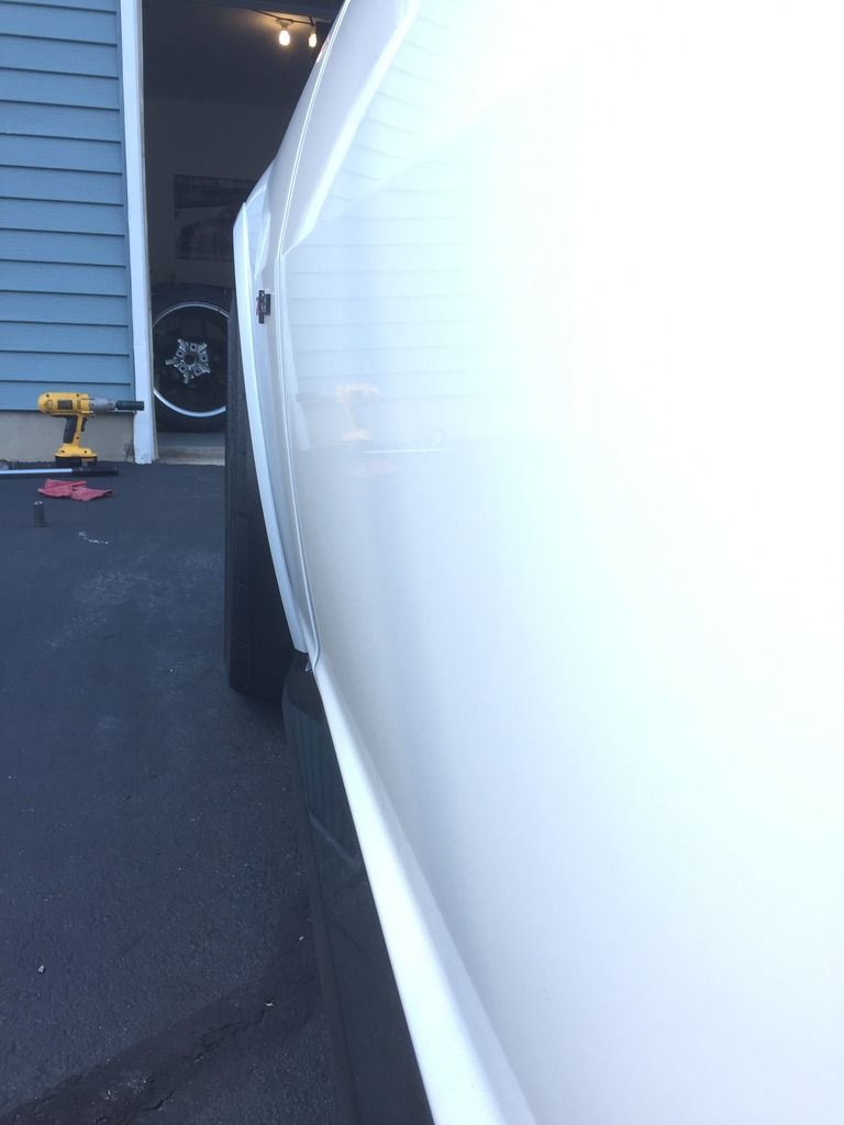

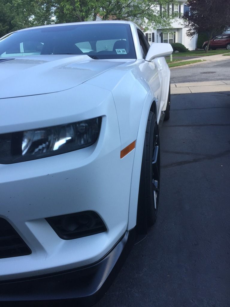

This is basically 4 OEM 19x11.5 rear wheels with a 25mm spacer up front to make up for the offset difference. I have done similar setups to several cars I have owned in the past, being able to rotate the tires increases their life dramatically if you don't mind the heat cycles.

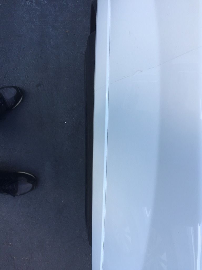

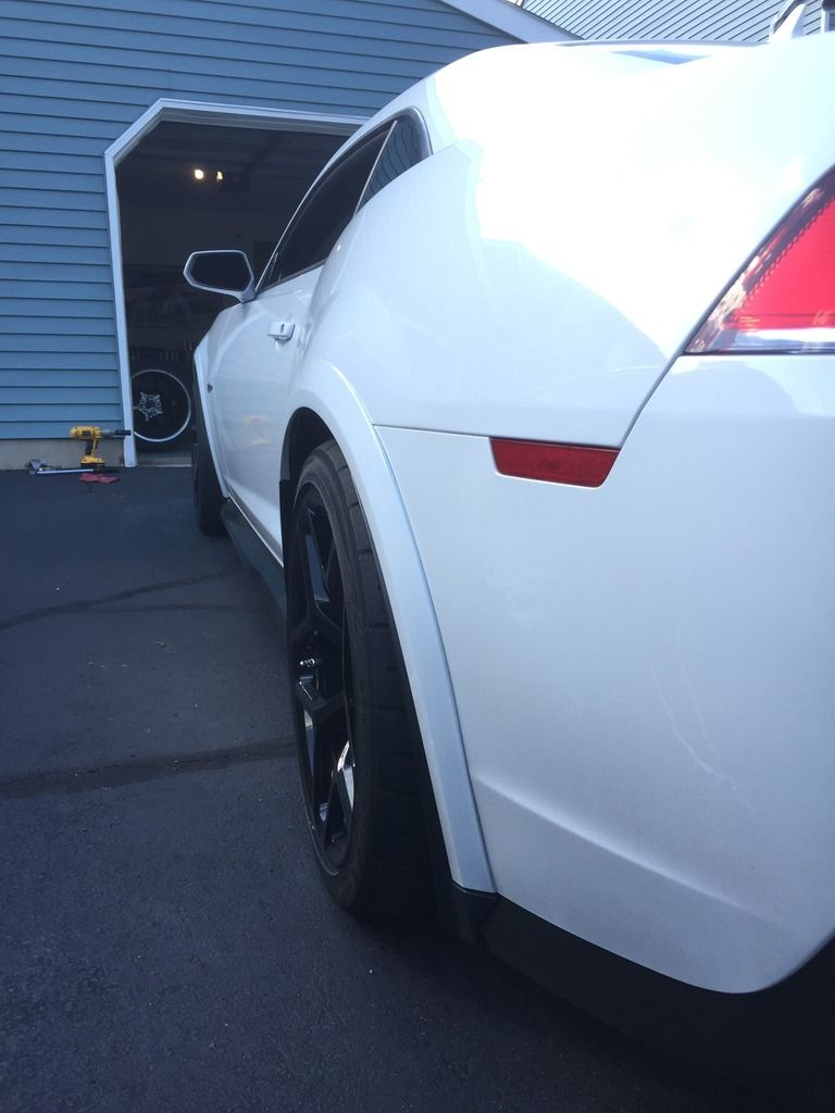

I can report that its hardly noticeable, seems to have a slightly better turn in response both on street and track at the cost of some slight increase in "tramming" I mean slight on the BS RE-11s, more so noticeable on the Tofeos.. My car has -2.7° camber so the wheels don't stick out too far, according to my math the outside should be about 5mm in vs a stock no camber Z/28.
Below: stock OEM 19x11 front with BS-RE11 325
Below: stock OEM 19x11 front with BS-RE11 325, inner tire to strut clearance.

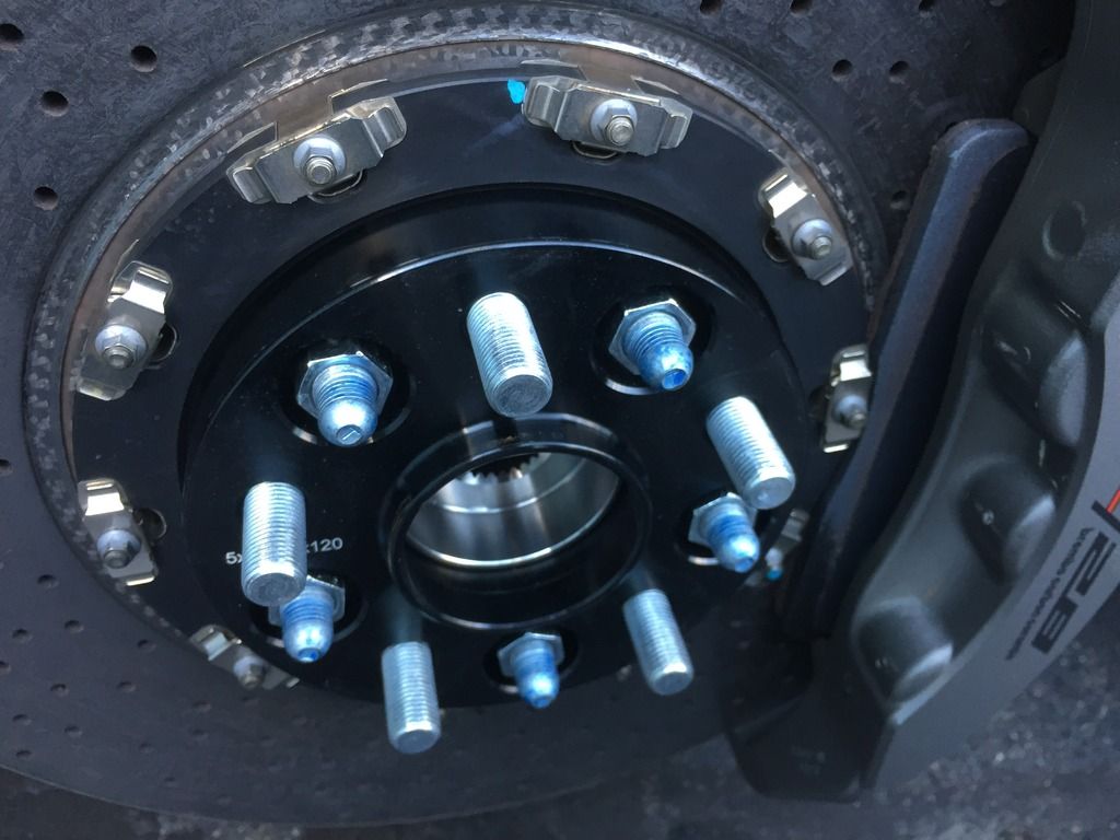

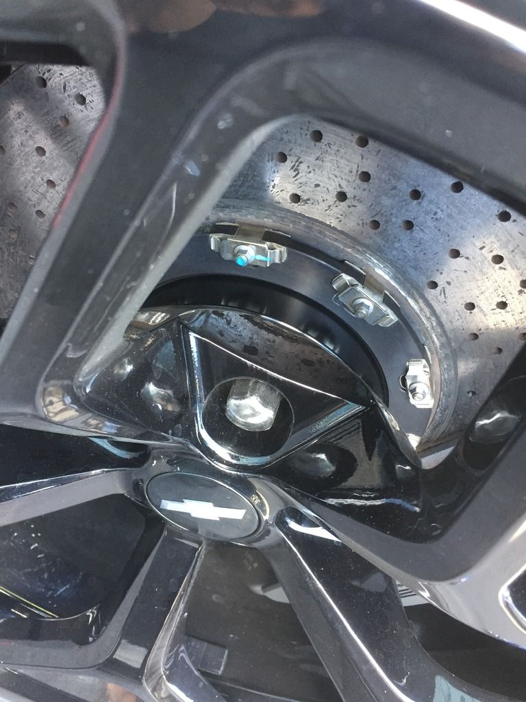

Below: 25mm bolt on spacer
Below: Wheel with spacer installed.

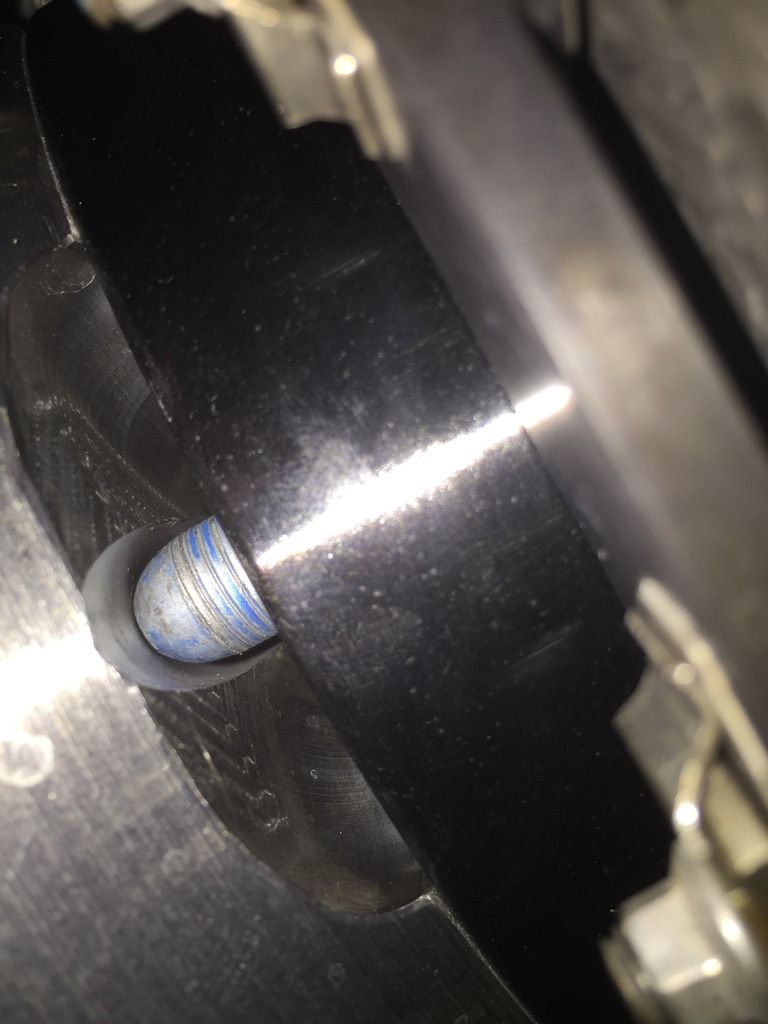

Below: The OEM rear wheel only has 4 "pockets" machined into the back of the mounting area, the fifth is a U shaped channel. Fortunately it clears perfectly with the 25mm spacer, no stud trimming required.

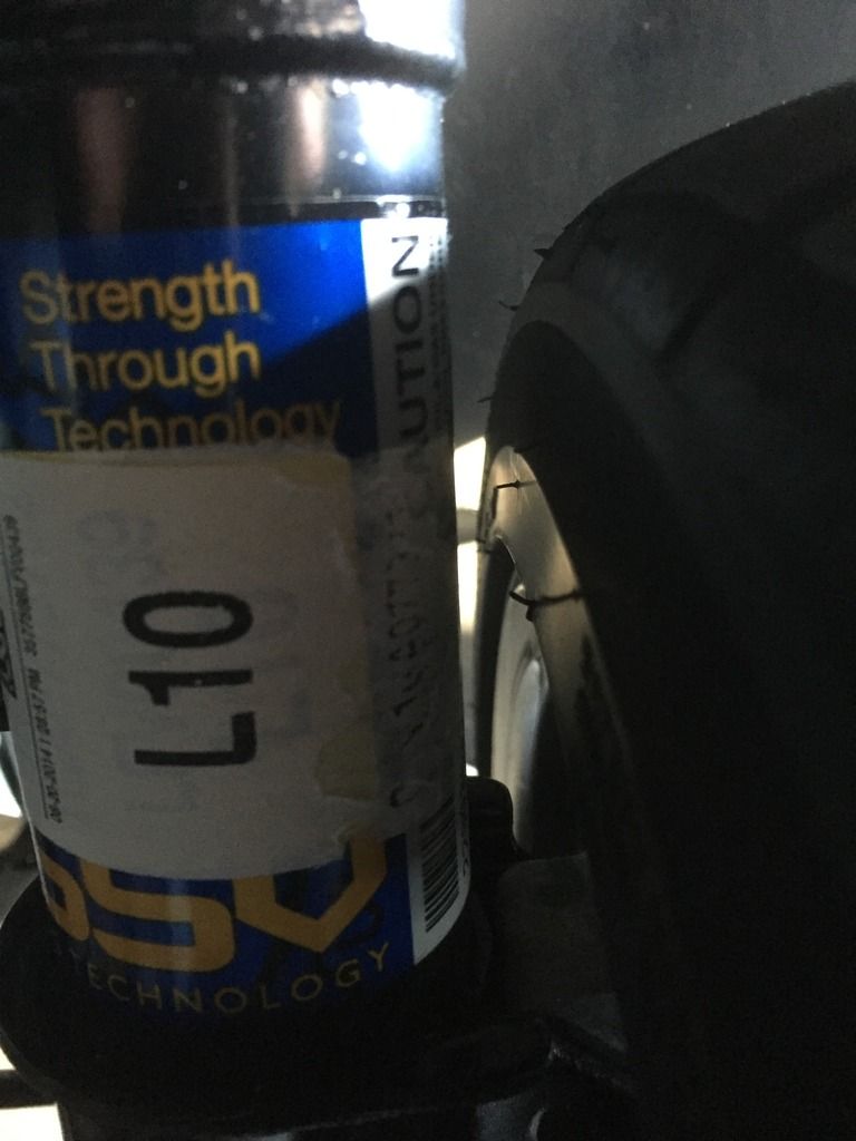

Below: stock OEM 19x11.5 rear on the front with BS-RE11 325
Below: stock OEM 19x11.5 rear on the front with BS-RE11 325, inner tire to strut clearance.
Below: 19x11.5 square with Pirelli Trofeo 305s

The spacers are hub centric, this is a absolute MUST for any spacer and any vehicle.
As for the thickness of the spacer the answer is not so simple. The minimum thickness of the spacer will depend on how much negative camber is dialed in at the strut / knuckle bolt adjustment. The more negative camber you adjust in thus moving the top of the wheel / tire closer to the strut the thicker minimum thickness spacer you will need. The less negative camber you have adjusted in the further the top of the wheel / tire is from the strut and a thinner spacer can be used. A drawback to a sub 25mm spacer is that the OEM studs ( or at least one of them ) must be trimmed to fit inside the wheel mounting recesses or replaced with longer studs to go though both the spacer and the wheel, like JTRAX is using on his aftermarket wheels. For my application a 25mm is the absolute minimum thickness as I am maxed out on the negative camber adjustment at the strut / knuckle bolt. As you can see in the pics the clearance has not changed, top is 19x11 no spacer, bottom is 19x11.5 with 25mm spacer.
