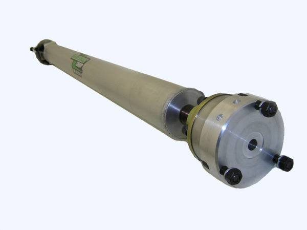

Originally Posted by NOT A 45 View Post
OK now I get it....that should work fine. I'd probably try to find the measurement that puts that slip yoke midway in it's travel. Do they still use the rubber couplings, or does it bolt directly to the flanges?
No rubber couplings on my DSS one, just bolts directly to the trans and diff..

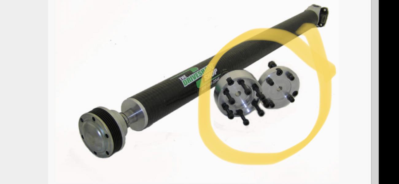

Yeah that’s a ‘Rzeppa’ joint on the front. Did they furnish these to put on the trans and diff?
Attachment 1102167
Yes sir! They DID provide those 2 couplers and all the bolts to make it all complete. No issues to date, or with the install.
