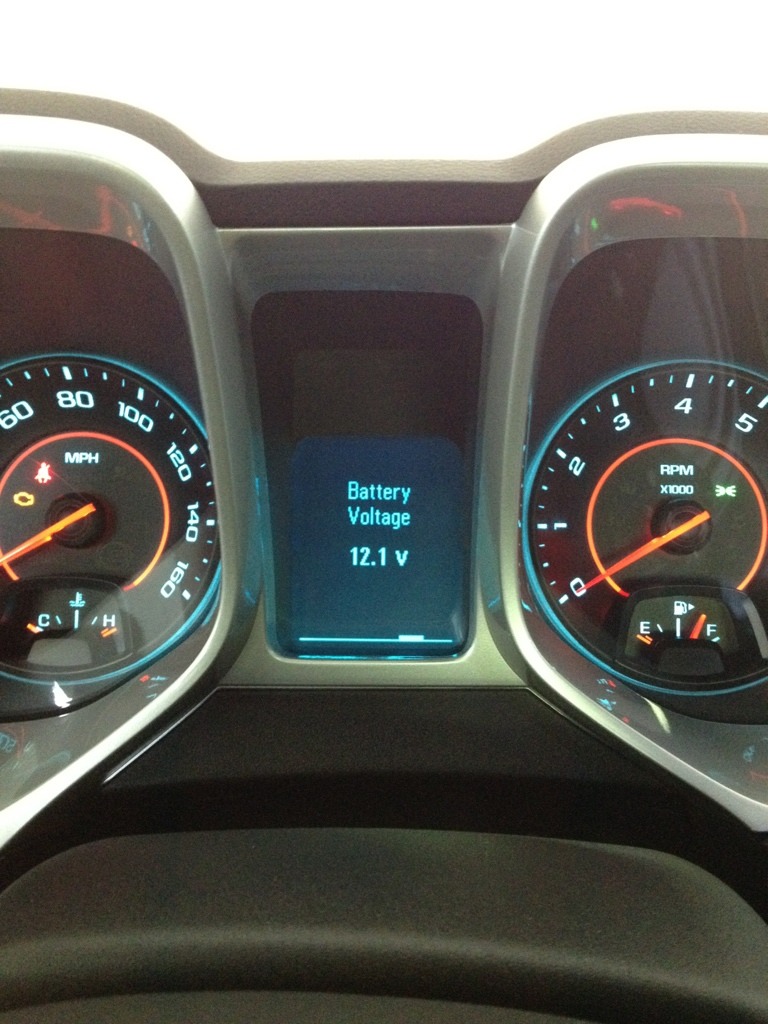

Battery Voltage (Pictures)
So I am just curious how far down can your battery voltage go and still be able to turn your car on?
I am talking about this

Voltage does not really matter, it is the AMPS that deliver the power to start the car. A starter will crank at least as low as 7.5 volts. Voltage with no load tells you very little...

Ohhh ok. Is there anyway for me to know how many AMPS my car has easily? Lol

probably 11.9v w/o a load(engine not running)

The battery is rated at a certain number of Cold Cranking Amps. On top of your battery, you should be able see what your CCA is.
To do a starter current draw test.... You'll need a " clamp-on" ammeter and voltage meter.
1. Connect the tester leads to the correct positive and negative terminals and then connect the clamp-on amps pickup around one of the battery cables.
2. Set the voltage meter to Int 18V and adjust ammeter to read zero.
3. Disable the fuel or ignition so the engine will not start during test.
4. Crank the engine as you observe the testers ammeter and voltmeter.
5. Never crank engine for more than 15 seconds and allow the starter to cool for 2 minutes between cranks.

No I'm not having problems I was just curious.... Thanks for all of your input though!

Battery should put out 14.5 volts with no load. A battery only putting out 12 volts has a dead cell.
With car running, voltage tells you how well charging system is working.

I don't know this is what my car say its running. Let you know my car is also off in this picture

Three years out of a battery in Phoenix is pretty good.
I'd take that 12.1 volt battery in to have it load tested, probably. Colin's car is brand new.
