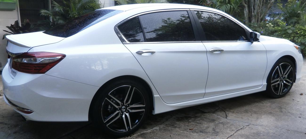

those type R wheels look familiar. i love my honda.
