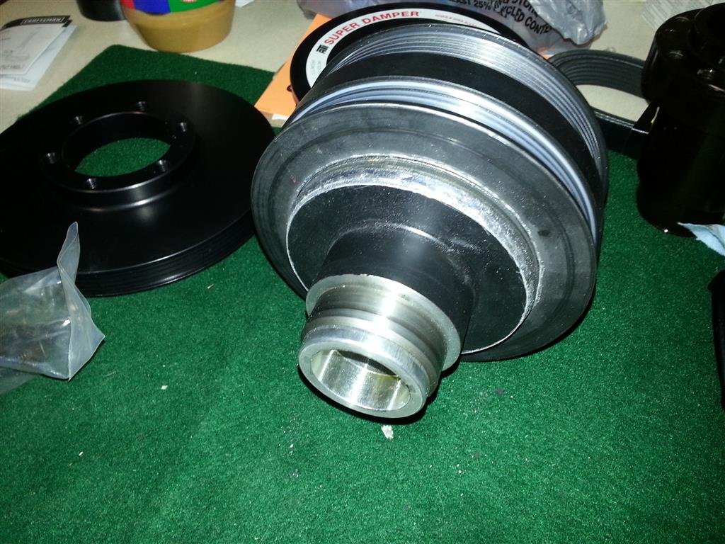

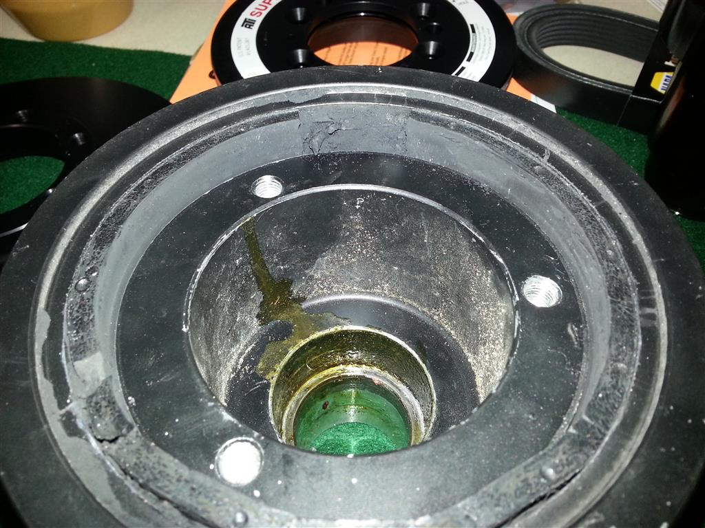

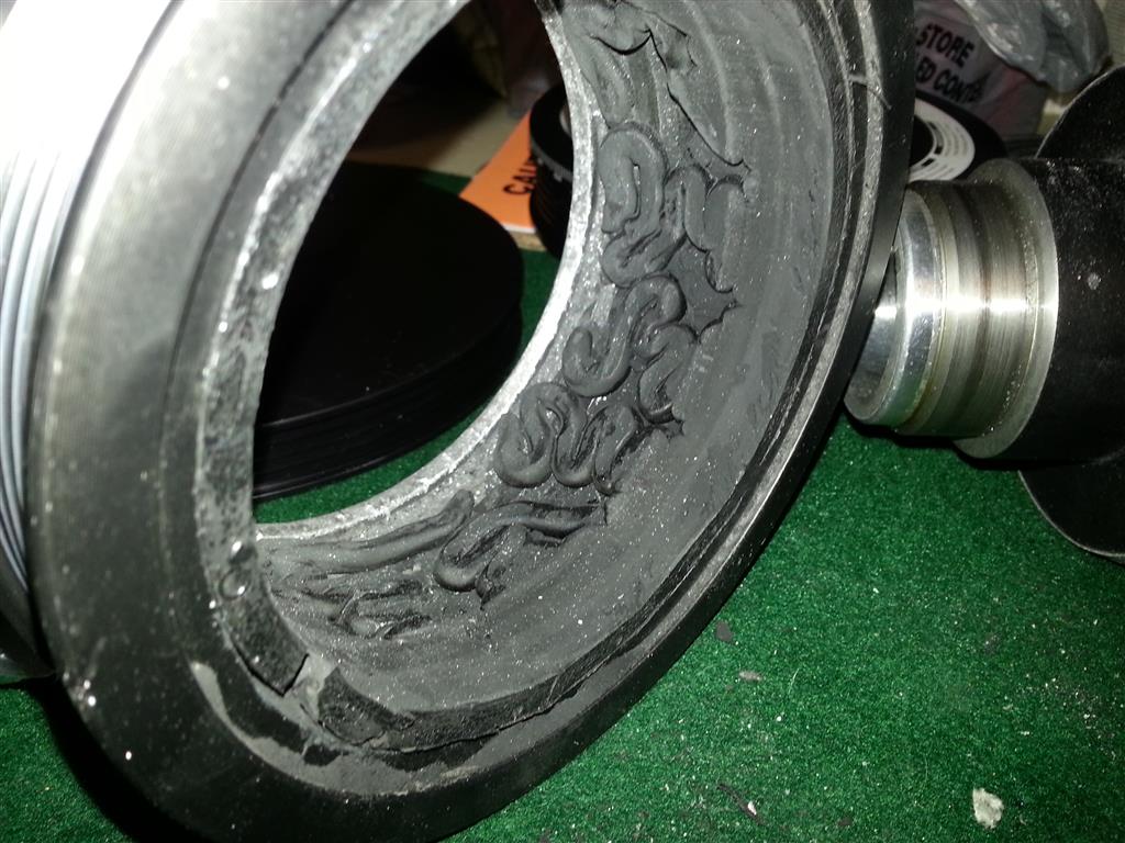

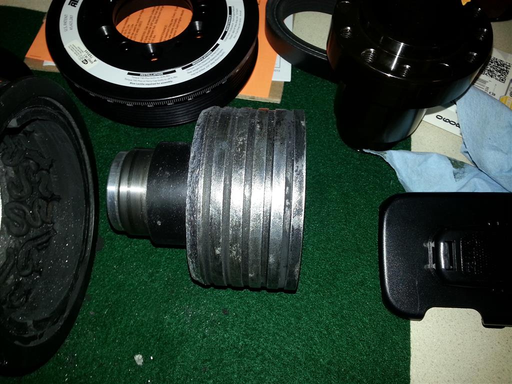

Well today, 7/21/2014 got the pulley from JDP -- ATI -- looks nice and once you put the hub on, you can remove the front pulley for rebuild (back pulley is for AC and is the standard belt/pulley).

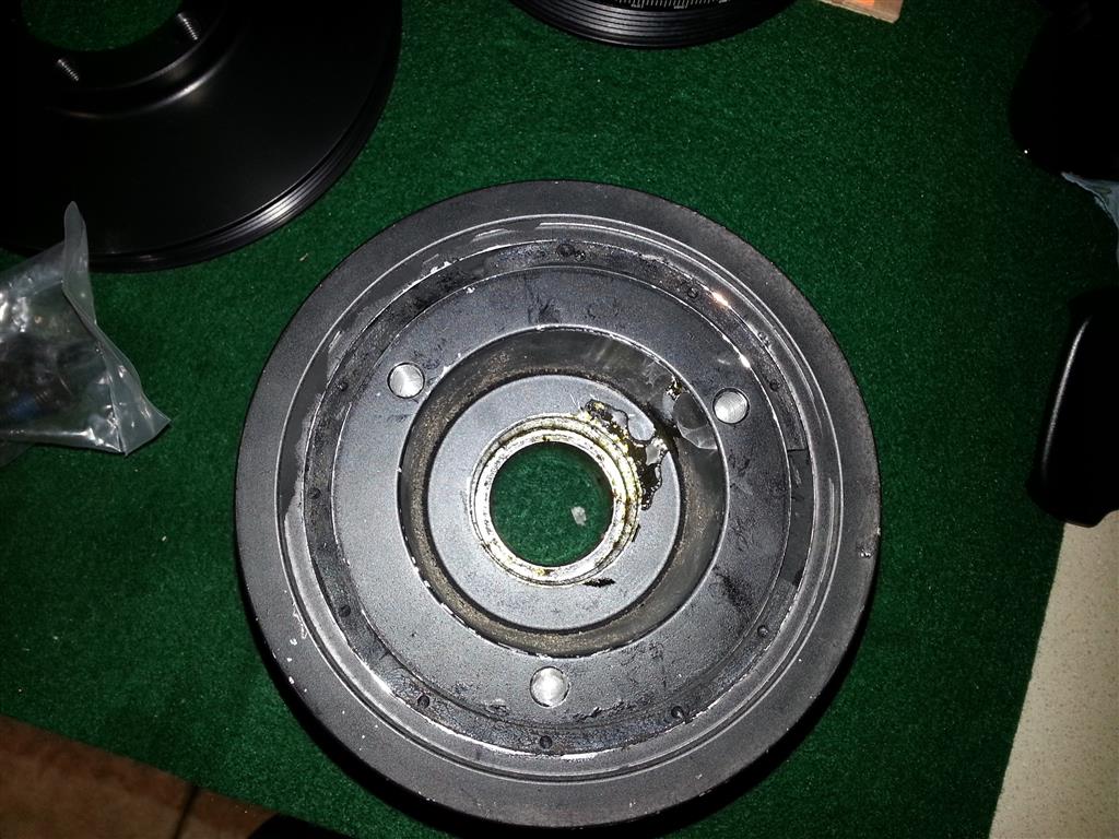

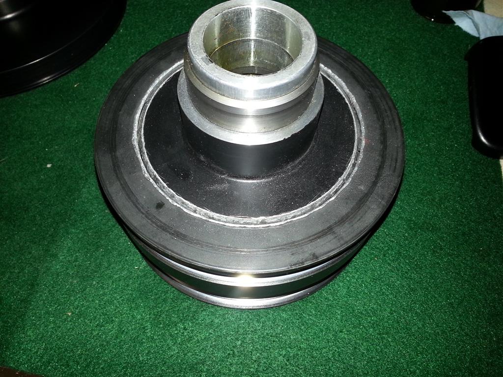

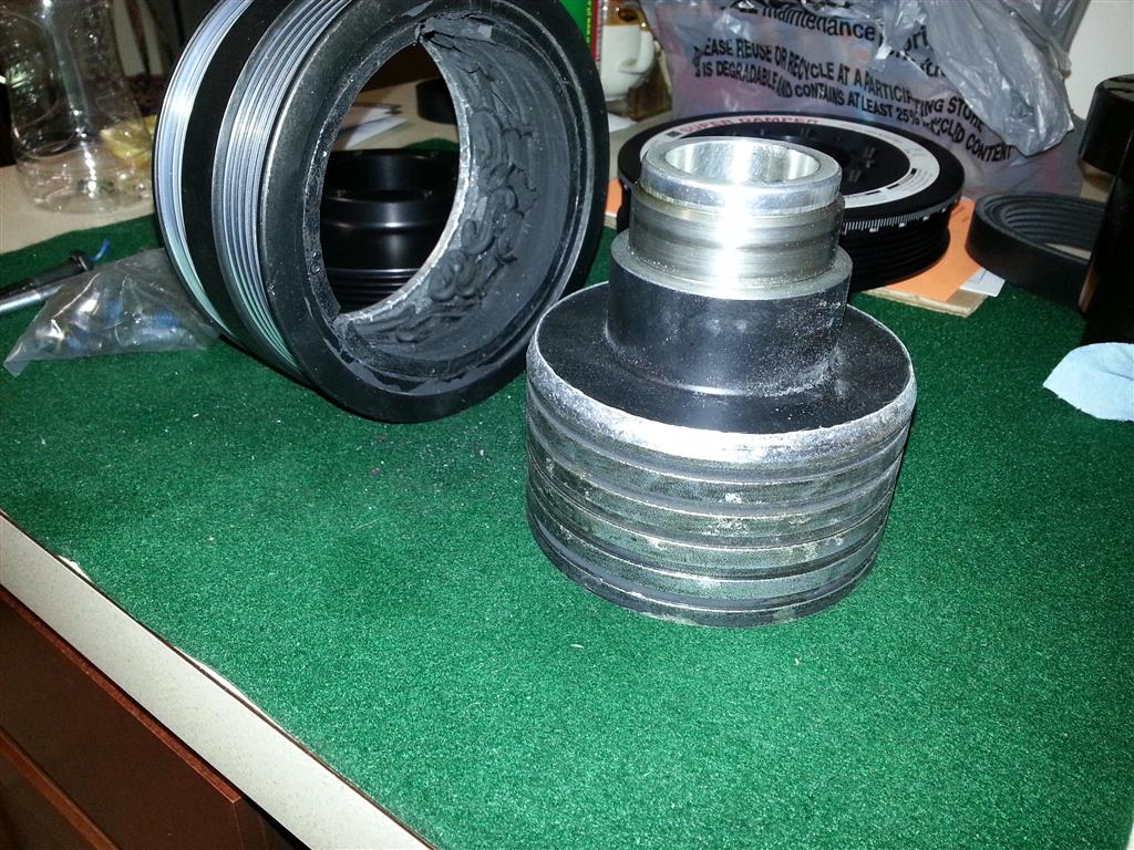

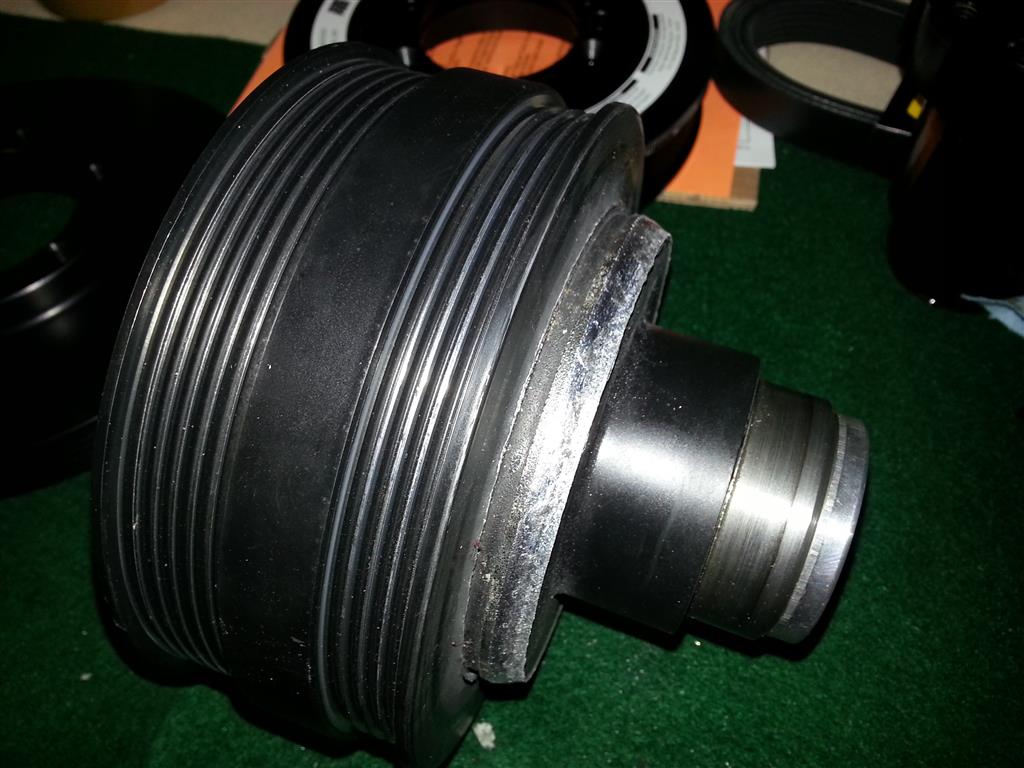

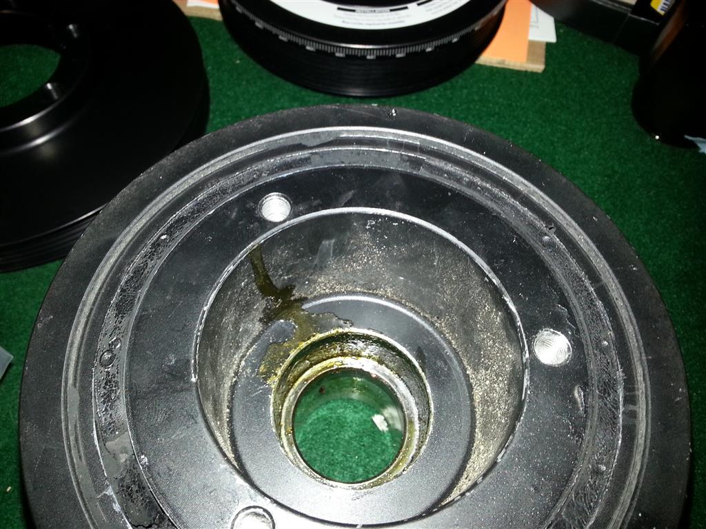

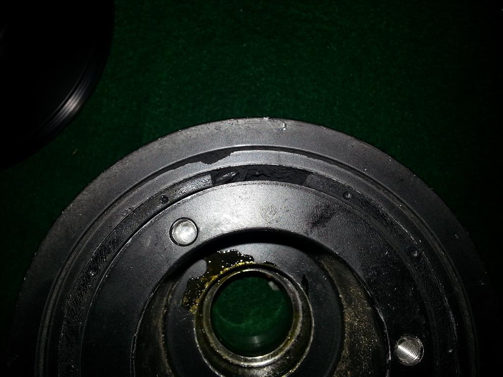

SO, wanna see a defective PULLEY?
This thing just blew up -- I mean, junked.
I have about 1500 miles on it in 3 weeks -- wow
BTW, still have NOT heard back from Texas Speed and they've known about my situation since Monday of last week -- go figure...
JDP (Tyler) FTW!
Here we go:
Here, the GUTS are fried:
The pulley is 'raised' here...
Now, this car has never been raced or to the track with these updates -- No races what-so-ever
The SAGA on what I had to do to get this thing off -- is another story -- I'll detail the steps I had to follow to get this off - Automatics are different than sticks!
Tranny lines get in the way ;o)
-Don

yep, it uses what appears to be vulcanized rubber to hold the 'belt' pulley on. It's separated and wobbles now -- thus causing both belts to slip. I can grab that part of the pulley and its wobbles by hand. I may have been that '1' where you get a bad one, but Ryan has seen this on another one. SLP has had these for a while and I'm not seeing too many complain.
