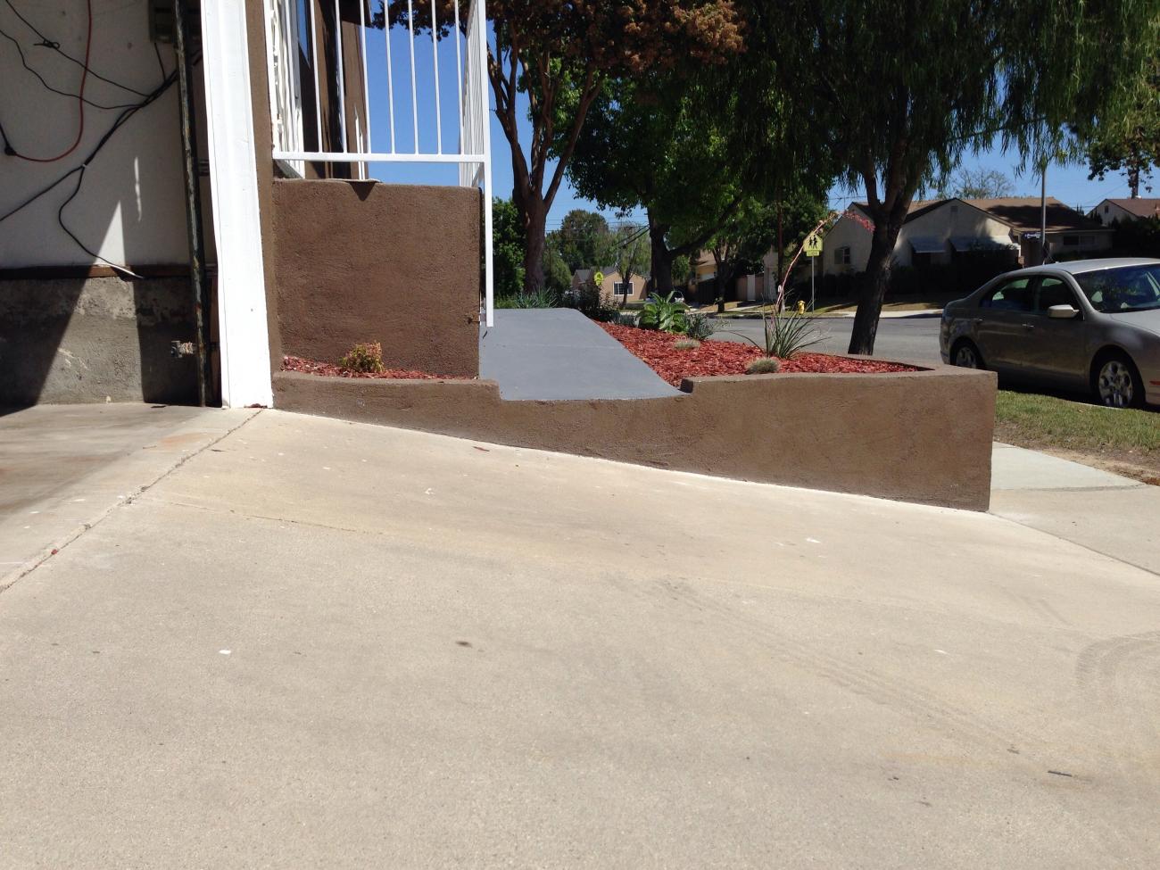

just bought a new house in Lakewood and thought i was cool in the driveway going into the garage...tried it out today with my car and nope..this is basically what i'm doing on the left. i need a solution so i can park in the garage!
help me!
i could try the right pic there, but might need to add a block for the rear wheels to simultaneously have the front and rear wheels raise the car up. also need to make sure it's long enough i don't come off and just high center another spot on the car. does anyone know of a product to solve this? without having to build something? like those ramps you can buy to change your own oil etc. something like that would be nice.
thanks!

pull in at as much of an angle as you can... might wanna try that before dropping a couple hundred bucks on ramps!

Tried that. The garage is a two car, but not wide enough.
I'm trying to avoid the cement route, but may have to. I'll likely just use some wood for now until I can save up for cement.

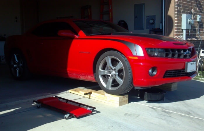

This is not my car...copyright. ..But I made a similar ramp to crawl up underneath. ..
12 feet long and cut for rear wheels to climb up and down into the garage...what do you think?

What about 2x8 or 10 one for each side. Cut a angle on each end for ease of driving on it. Probably about 6 feet long. One end at the crack in concrete at grage door entrance. As you drive up and the front wheels come off the boards the back will still be on the board and will give you about an inch clearance. This all depends on how much clearance you need.
The board will probably want to move as you drive on so you could attach it to the concrete with bolts.
Just a thought. A temporary fix at least.
