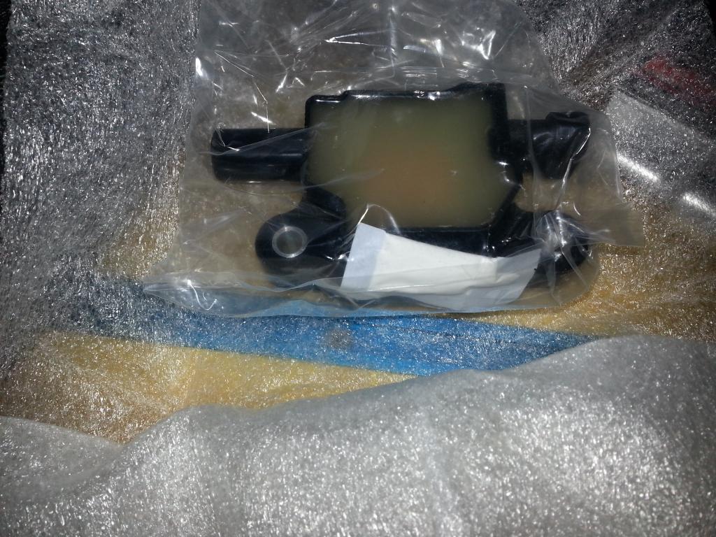

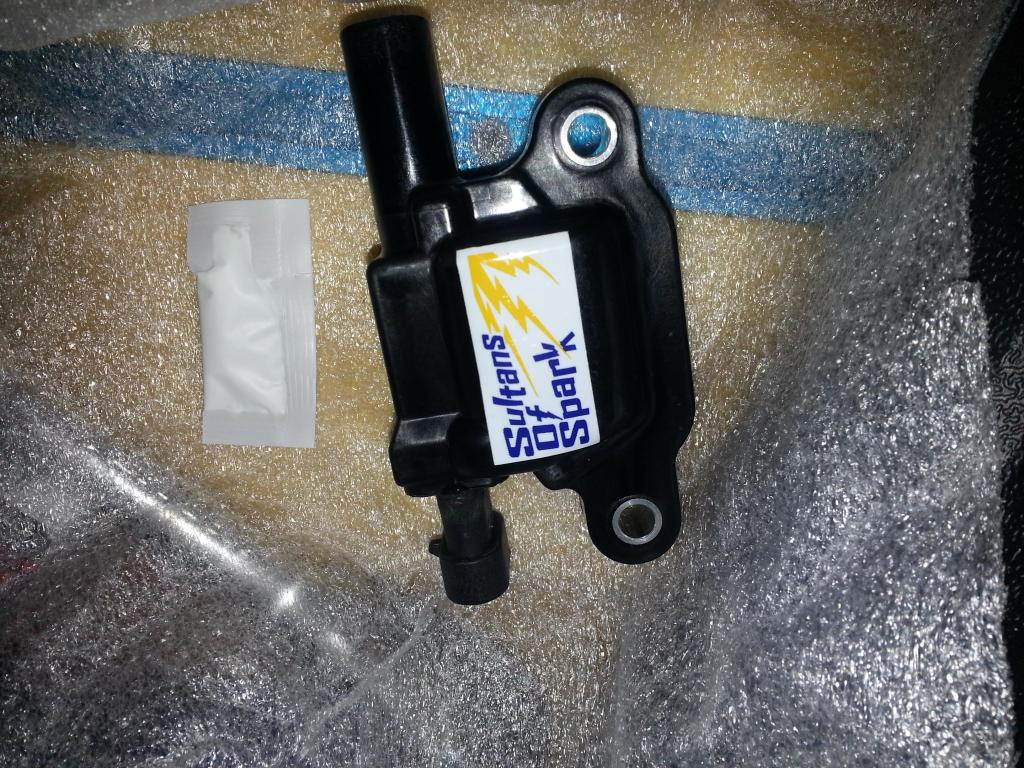

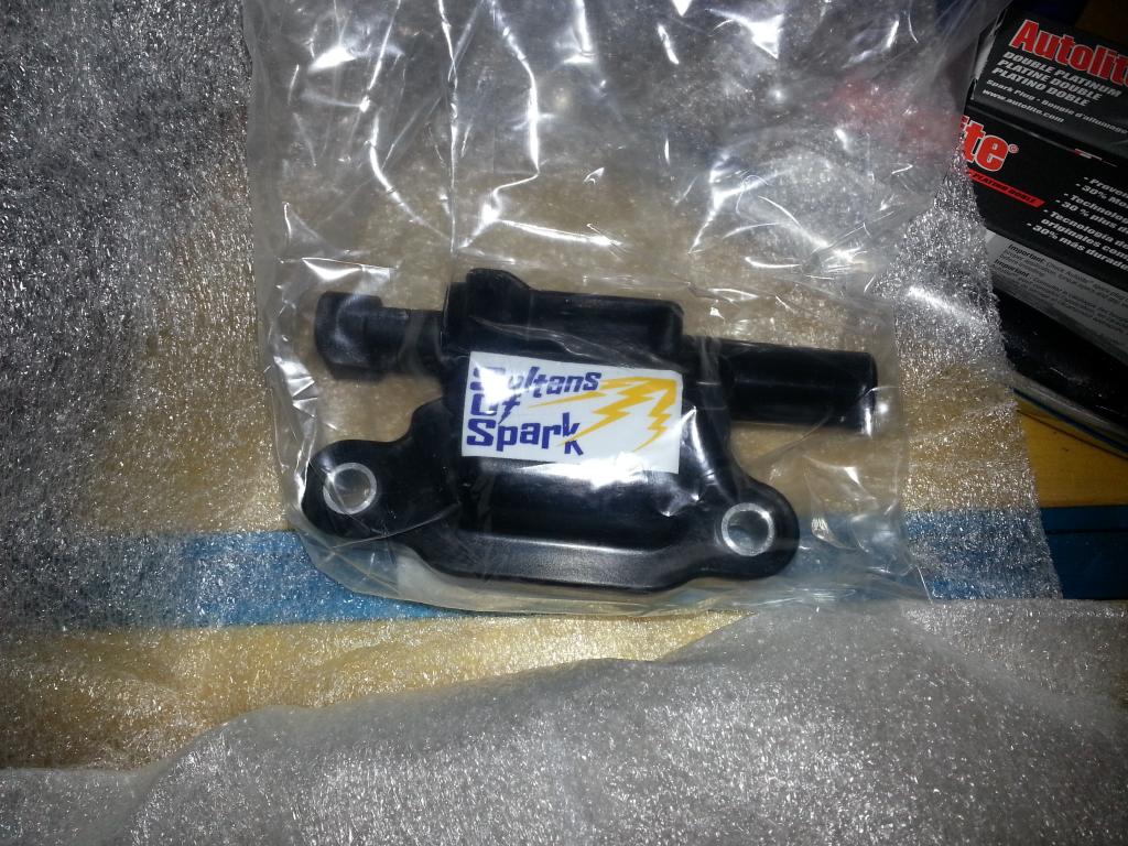

So, the first thing I did was unpack the coils. Workman ship is what you'd expect and outside of the markings, there are no physical difference. They bolted in the same location as stock. Here is a front and back. BTW that packet you see is the di-electric grease for the spark plug boot. DON'T put too much on and KEEP it off the plug/connection. That KILLS the spark. They give you one per coil but I used 1/4 of 1 -- so you have a LOT left over.

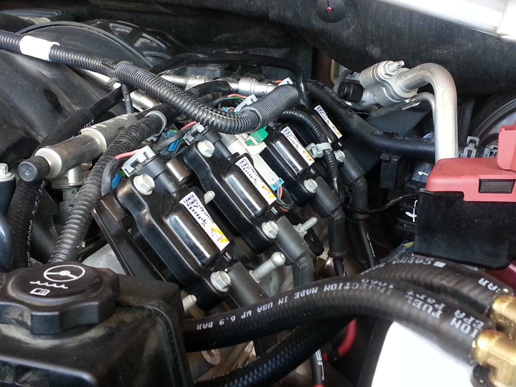

Here is a pic of everything installed:
Left Side:
Right Side:
Took a little over an hour to do the plugs and coils -- I did take my time and I did mark all coils (stock and replacment) along with the original plugs so I could evaluate what the engine was doing before I made the changes.
