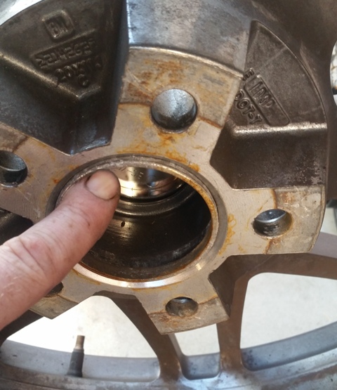

are they hubcentric wheels?
possibly the centering ring has slid away from the hub on the rotor.
here is a wheel with the ring in it.
the ring should be at the edge of the mounting face.
