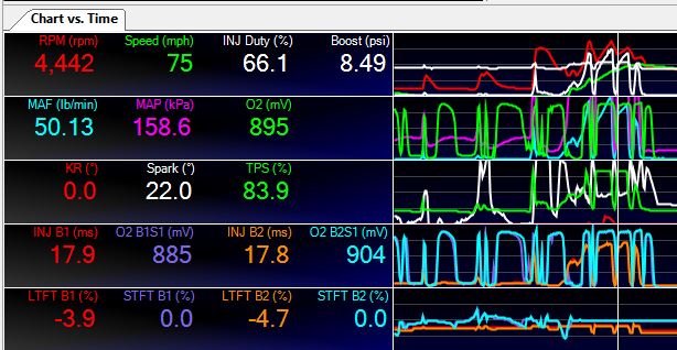

edit: see attached log from last night. Just messing around and first time i logged my car. 8.5 psi of boost, 84% TPS, and 22 degrees timing. Normal timing?

If you want to see if you are in the low octane table then log "knock learn factor". If it is 0.00 you are in high octane table. If it is 1.00 you are in the low octane table. If it is anywhere in between you are in a mix of high and low tables. For instance if knock learn factor is 0.50 you are half way between low and high octane. Get it?
