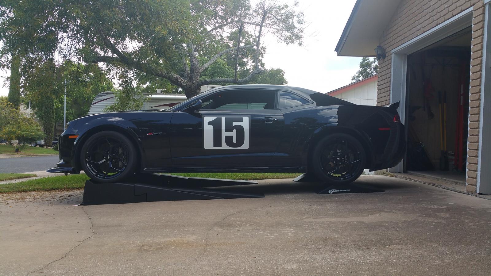

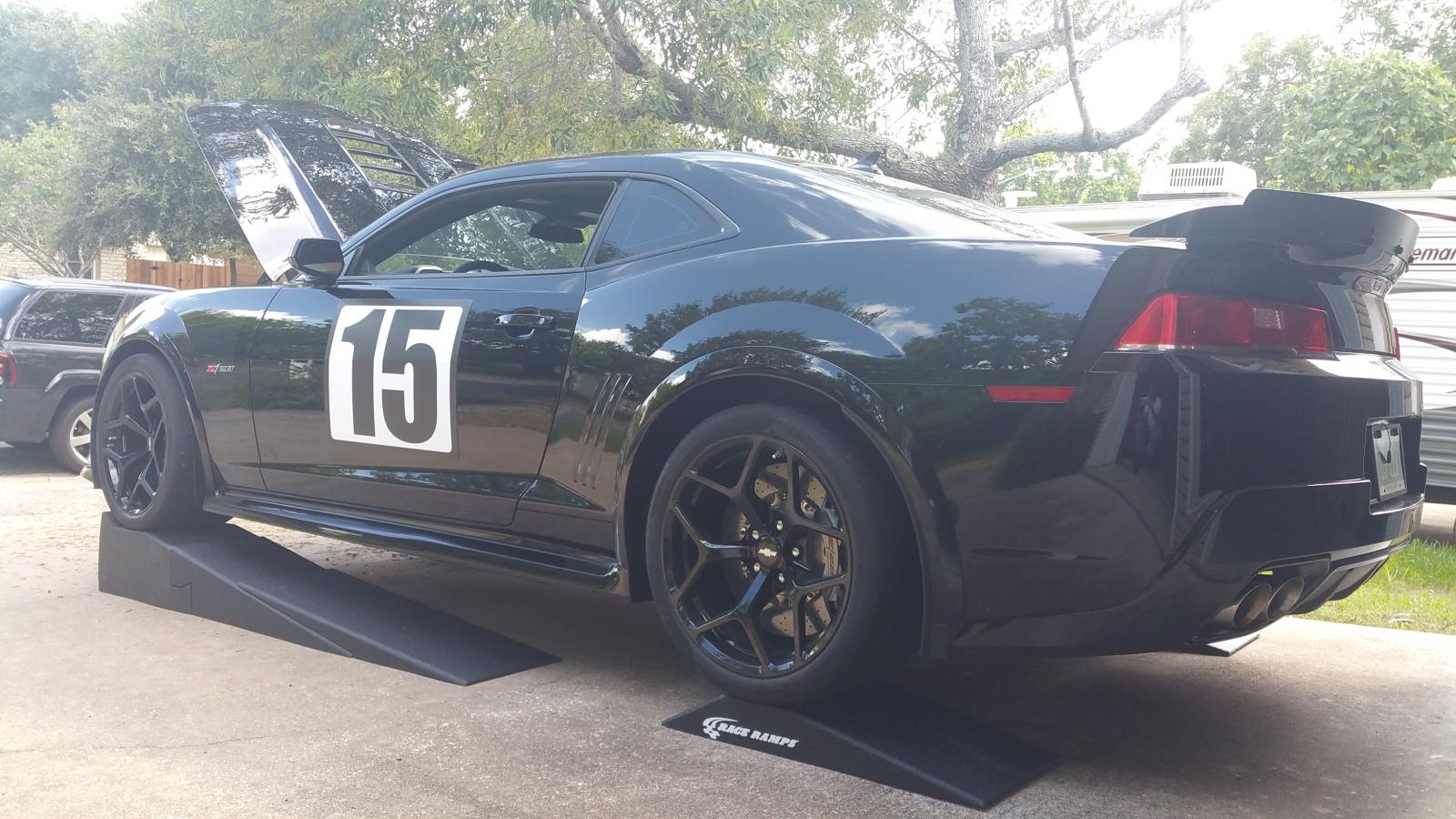

Ok folks, I need to change my oil for track duty next week, and I am contemplating using the race ramps wheel cribs pictured below. Anyone use them? My driveway is gravel so I can't use a quickjack or anything just yet (I am going to borrow my neighbors concrete pad for now).
For now I am contemplating going with this. I guess my question is, any driveway changers in here? Anyone have the issue I have i.e. having a flat driveway and no easy way to get the car up and level?
(not a jackstand fan).

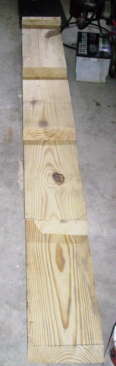

Made my own ramps out of 2"x10" planks. It's a pain with the car being so low and having a belly pan to remove. There is a couple of threads on how to, here is a picture of a members homemade ramps. Mine are similar but are like 7ft long to be able to clear the Z28 splitter. I made them so each ramp is two pieces, I can use one for normal height cars and then add the extension to do my 1le. They are heavy.

those wooden ramps look exacty like mine, i use those too since I can barey get lift jack under my car how low it is.

A word of caution, race ramp product data indicates to only use on flat surfaces, being that said I have used mine multiple times on an inclined driveway. You can easily find yourself in a difficult position getting the car back off the race ramps when at an incline depending on the steepness of the grade and the car being a standard, it is gonna roll and you can't aggressively left off the clutch.
