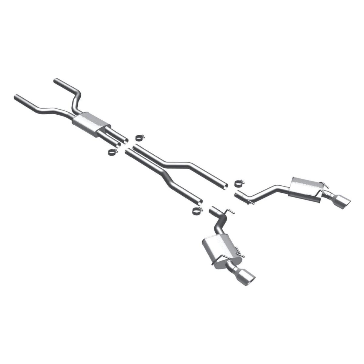

i took my good sounding drone free magnaflow off my ls3 and put it on the l99 it no longer sounds good to me. it has a forward resonator the l99 needs more than a cat back exhaust to sound good. the tune will fix the dod fart sound. i'll will do the ls3 conversion at some point.
https://www.autohance.com/magnaflow-...yABEgLF8fD_BwE

you had this? because i was thinking the resonator with a muffler delete could sound good that looks like what that is with j pipes.
https://shop-solo-performance.com/en...automatic.html
the video with the sound clip might be more than i was hoping for LOL
sounds nasty in a good way
