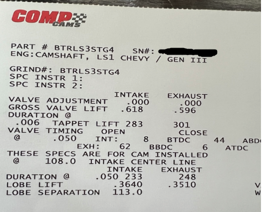

Spark Plug Recomendation - Cammed LS3
Looking for a recommendation for new set of spark plugs
currently using NGK TR6
mods:
cold air, LT Headers, under drive pulley, cam and supporting mods
Cam specs
CAI Inc, Dynatech 1 7/8 Headers, Dynatech Hi Flow Cats, Magnaflow Competition exhaust, Dyno Tune by SPI Inc., BTR Stage IV Cam, 10% UDP, Hurst Billet Short throw shifter

Are you currently having issues with the current plugs? A lot of modded guys such as yourself have been using TR6's without issue.

nope not really, they actually have been pretty good. would get the TR6's again, just wanted to see if anyone else had any other recommendations or experience with something better
i've inspected them a few times and seems to be normal wear on them. one had a bit of oil on the top part of the threads, but could of been just me not tightening that one plug enough last time i checked them

NGK TR6IX's for most cammed guys here..

Another vote for the NGK TR6IX - have used pretty much the life of my car, multiple cammed setups, always been a good plug, stays clean, good tuning margin for stock-ish compression on 93 octane. The last set I pulled out probably could have just went right back in - but when you have fresh ones sitting right there, you pop 'em in.
AC Delco 41-104 is a good equivalent to the TR6IX for heat range and material.
