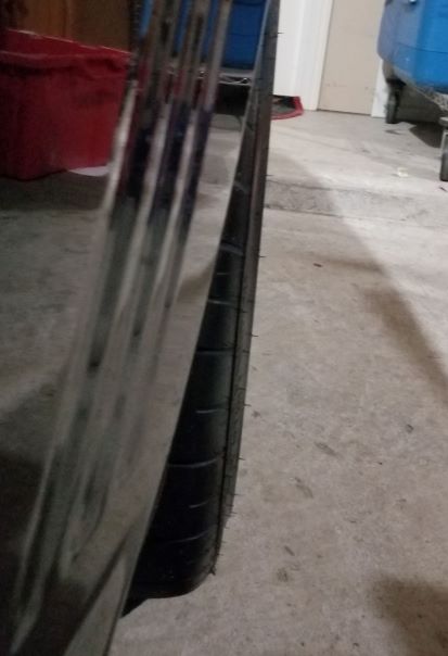

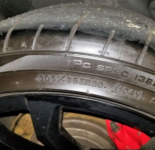

I bought my Car and it has 305 on the rear. handles just fine for me. I have not taken to the track yet though. Here are some pics of the looks. Of coarse i'm assuming you have the black wheels for it? (This is a question for sure)
