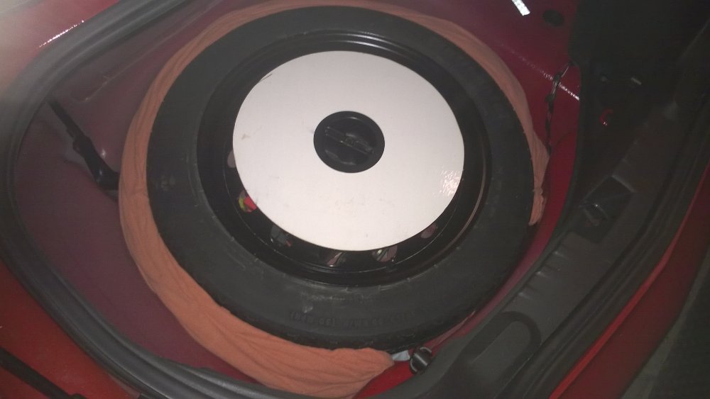

I got a space-saver rim and tyre from performancespare.com
Lies in the wheel well flat under the boot (trunk to you guys) carpet. Came with luq wrench and small jack. Good quality kit.

I bought a spare tire for mine. Took the compressor out. I don't have OnStar, nor AAA. I prefer to be back on the road in 10 minutes instead of waiting 3 hrs to have a wrecker pick it up and bring to a closed dealership only to have to wait a weekend to get your car back form a flat lmao

x2 I got a brand new spare on the internet $350 with jack,tire wrench, lug nuts
