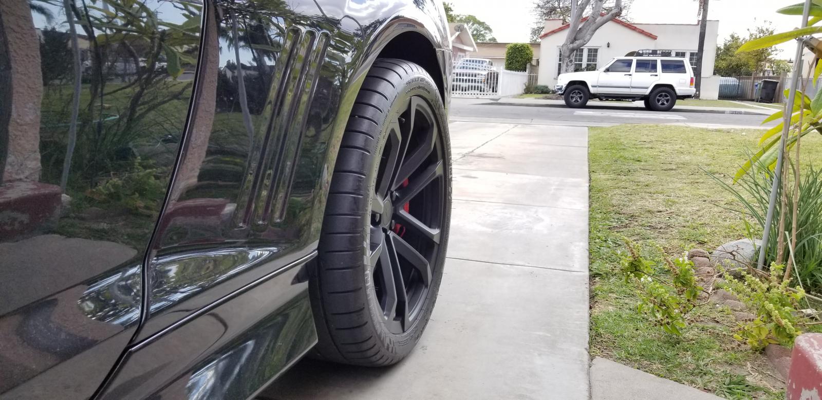

ive been running michelin Pilot SS 335/30/20 since 2017. no issues

atm (till they're worn) im running factory goodyear eagle f1 G2s right now 285/35/20 on the factory 20x10 wheels. No rubbing issues at all. Factory front wheel and tire on all 5th Gen 1LE and ZL1 cars
they are identical overall outer diameter as the 335/30/20 tires on factory 20x11 wheels im using in the rear
27.9"
Bone Stock
sixty9fordkiller is offline   Reply With Quote

the car in the first post has MPSS in the rear. I can tell by the treads.
if you have an 11" wheel then you'll be fine as long as the offset is correct. the car literally has 1/4" of an inch clearance inside with the suspension on the ground. ~5/16-3/8" in the air. ive never had issues with rubbing even with passengers in the car
here are some pics so you can see what the clearance is like
