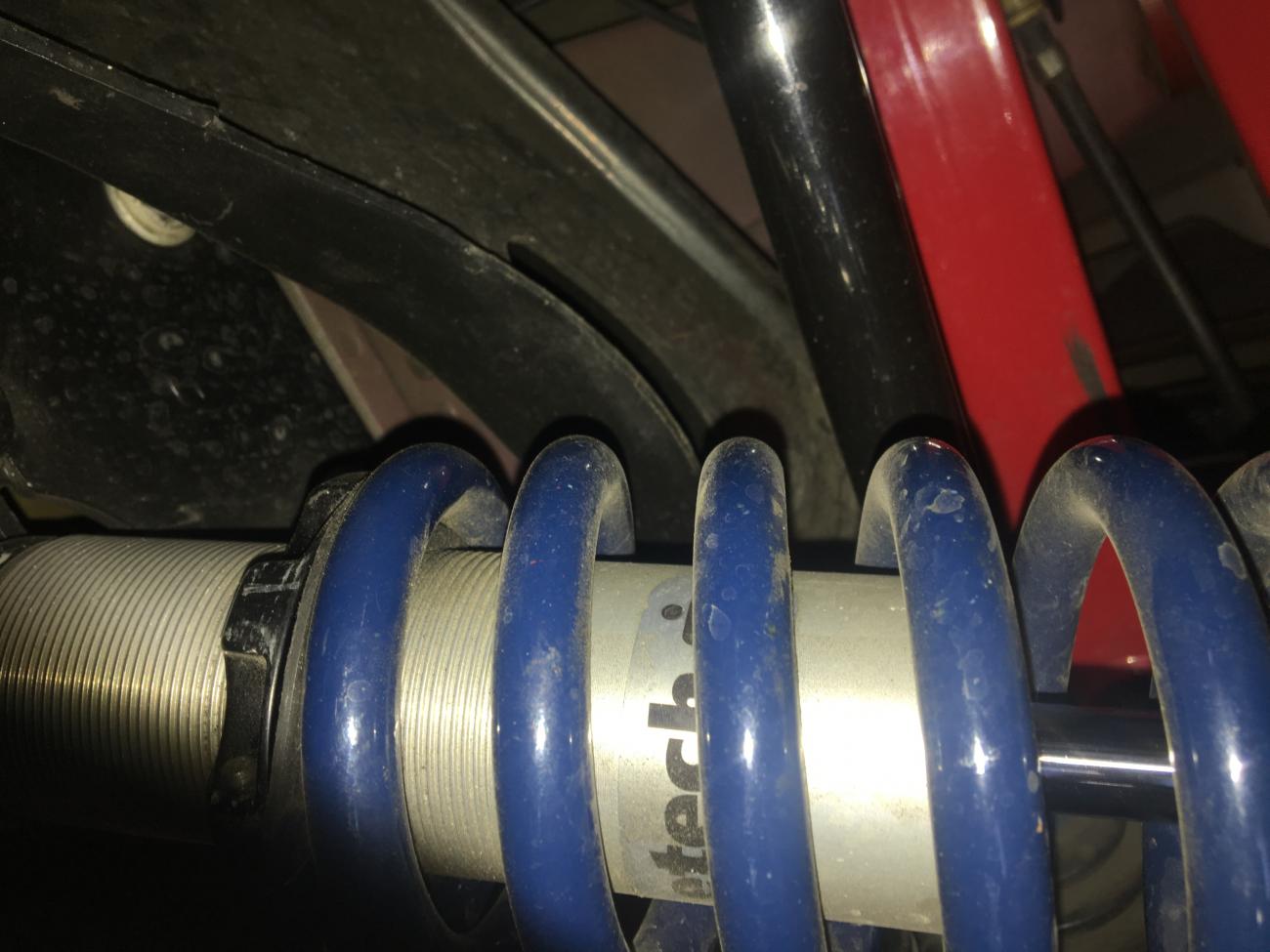

Ridetech HQ coilovers, anyone?
I’m trying to get the rear ride height a bit higher but the spanner nut is really close to getting to the end of the threads for my taste, especially compared to the front. I’m including pictures of the front and it’s location with no weight and then the rears. If anyone else has this setup please let me know if this is close to yours. I’m thinking a higher ration spring is needed for the rear but I’m no expert.
Front coilovers spanner nut & spring location then rear, same deal. I’m about to need a breaker bar to tighten the nut on the rear more.

Yep, mine looks similar but not knowing a distance dimension from you it’s hard to tell. Mine at 26.25” rear height from lower lip to fender. I tried to measure from bottom of threads to the “valley” notch in the adjustable ring. It’s about 35mm. My rear springs aren’t stock but 550 lbs per inch. Don’t know if that made a difference as I don’t want to go higher
Thank you for responding.
Stock wheels, the measurement from fender to ground is right around 28 1/2” all around.
Does this sound correct to you?

Yeah, the rears you have to tighten, or turn it clockwise to raise it. 28.5 to the ground is about 25.5” from lower wheel lip. Measure from lower wheel lip to fender arch to be accurate. With 20” tires you are a bit low for safety of the rear axels if you are racing or road course work. Should be 26” minimum. With a 1” drop from my stock hieght I am at 26.25”. Measure on a 1/4 tank gas. Full tank drops another 1/8” or so.

Also, I only have rebound adjustment and it’s really bouncy unless I’m almost all the way to zero rebound.

Doesn’t sound right. I run 18 and 20 from full stiff, or the soft setting they say to start with. No bouncing. Make sure you aren’t at full soft thinking it’s 0 or stiff

I agree with VR Baron. I ride mine on a fairly stiff setting. Im lowered but not slammed. Mine isn't bouncy at all. It is firm but not kidney jarring. I also have shorter, I cannot remember the lbs...500??, springs in the front. I got them from Ridetech. Needed them to clear some CCW wheels I had.
