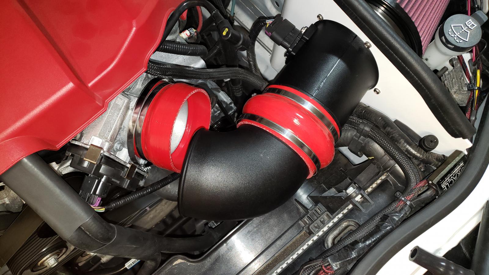

Has anyone ever had issues getting a Roto Fabb to line up in their ZL1? I'm installing my Roto Fab right now and there is absolutely no way this elbow will be able to mate with the throttle body fitting. I have tried bending and forcing and it's just not happening. I followed the instructions closely step by step and I lined everything up like they say. I feel like either I have something on wrong or this thing isn't made properly.

Here is a picture of mine...

Might want to push the two plastic pieces together more into the coupler

Did you buy new? That heat shield does not look right for a zl1. Looks like an SS heat shield

You are 100% correct. I just got off the phone with them. They sent the wrong heat shield. Theyre sending the correct one but it won't get to me until Tuesday at the earliest.

Oh I pushed! Lol. Turns out...I have the wrong heat shield. They sent me the SS shield and not the ZL1. Is this all because I haven't updated my avatar or signature pic?!?! Lol
