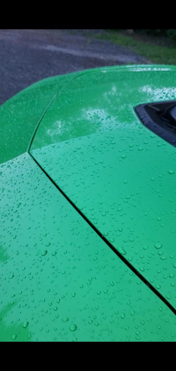

Looking good and you'll be free to use any hood.
To do the reverse bolt method you need t-nuts you thread and glue in. It'll be quite the while before I do the mod but its not 100% needed.
This is my alignment / no sag with only mending plates.

dam thats some good spacing! makes mine look real far apart
