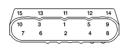

Is the torque sequence for a LS1 head the same for a LS3 head???
starting from the center and working out???

hey thanks, I had found it..
forgot about this website..
wwwLS1howto.com
it gives you the basics.. pretty much the same. you just have to double check the torque specs..
