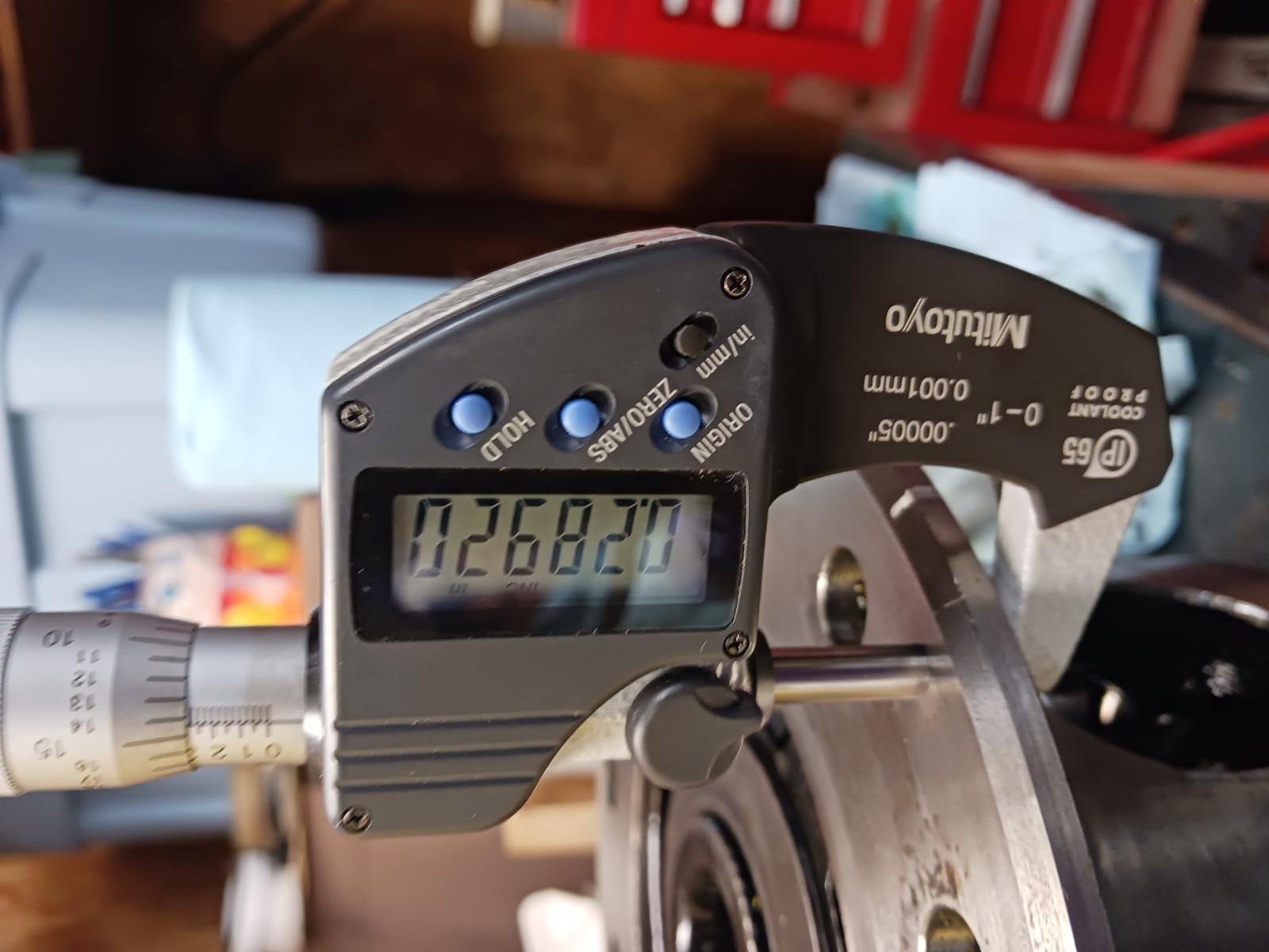

I removed the carrier assembly and measured runout on the edge of the carrier. I positioned the dial indicator as displayed in the pic. I started at the tooth that had the least amount of backlash .004 and rotated until the tooth that had .019 (which is 180 degrees across) and runout hit .012 and went back down to .000 when rotating back to the tooth with .004 backlash. So the edge of the carrier is machined improperly.
Next I removed the gear and and found that 2 ring gear bolts were not as tight as all the rest were. I measured runout of the carrier face where the gear mounts and I measured runout of .012 Again I started at the teeth that were at .004 and again directly across from this point (180 degrees) measured .012 and back down to .000 I also measure the top surface of the carrier and came up with the same measurements. The case is warped. Did it warp because the ring gear bolts were not torqued properly?

I next measured the thickness of the carrier and measured between .289 and .291. Only has .002 runout. That appears good.
