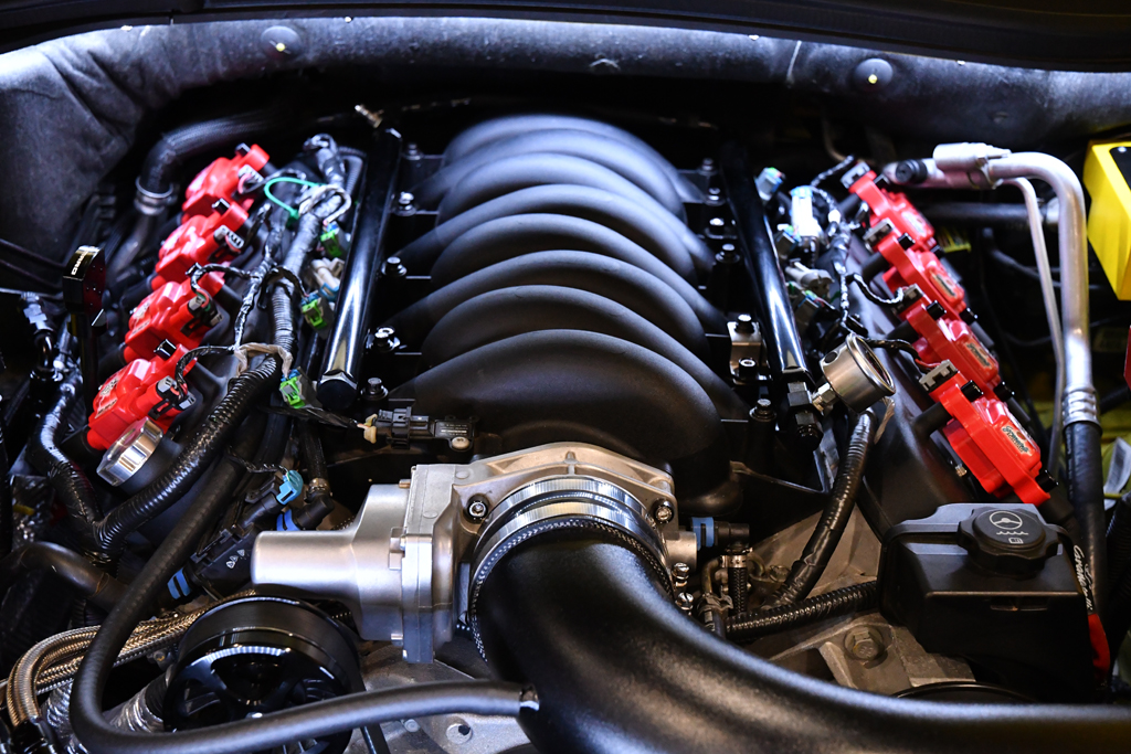

Are you talking about the Schrader valve on the factory fuel rail (located at the front of the rail on the driver’s side)? If so, I think most simply forgo including it when upgrading to aftermarket fuel rails. However, when I did mine I ended up getting a fitting that accepts a 1/8th NPT thread and worked it into the rear passenger side. The fitting I used is Summit part number EAR-AT100199ERL if you want to check it out. I figured at the very least, I could de-pressurize the fuel system at the Schrader value or plug in a different fuel gauge for diagnostics. Although, I also mounted a fuel pressure gauge on the driver’s side so I can see it right away whenever I pop the hood open.
Here's a picture of my current setup in case it helps.

On my 1LE, I did almost the same thing as Bee. Used the Holley fuel rails and added a gauge. I did not add another schrader though. On my Z/28, I did the Fore rails and did not add a gauge or a schrader

No that helps a ton. What fuel rails did you go with? That looks really good. I was wanting to mount a gauge the same way.

Cool... and thank you! I went with Holley EFI Fuel Rails. I bought the 534-210 kit but in hindsight could have saved money by just getting the basic fuel rail kit since I ended up piecing together different fittings so I could insert the gauge and Schrader value and routed the fuel lines across the back of the intake instead of at the front. Plus, I switched the lines from the braided steel hoses to UltraPro fuel hoses instead.

I did almost the same thing. I bought just the rails though, because like Bee, I knew I wanted to route the hose in the back, not the front. So I ended up piecing the fittings and things together. Plus the added gauge.
