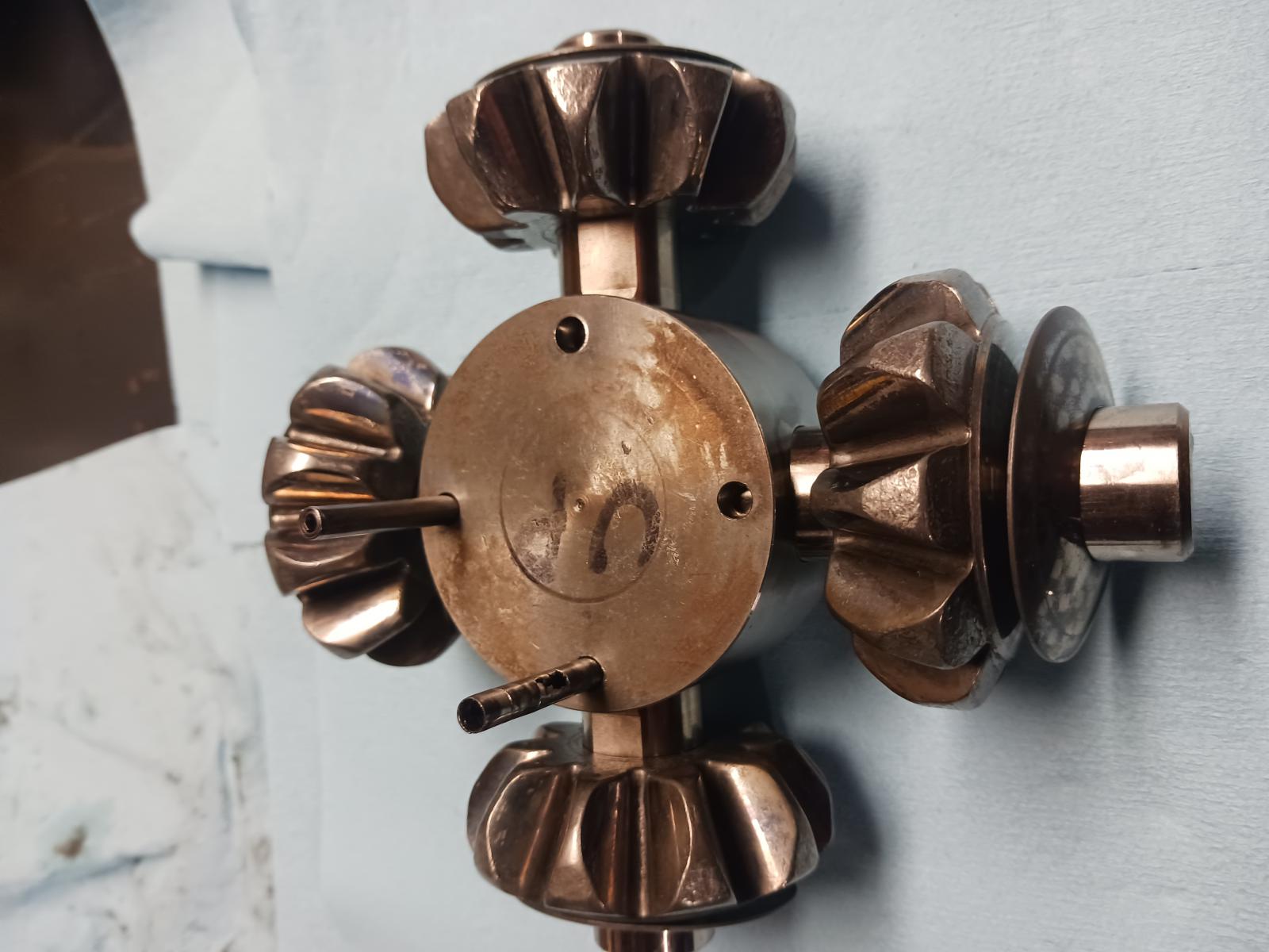

I have finally disassembled the complete carrier. To remove the right side (passenger side) clutch pack the round shaped block that has the 4 spider gears that puts pressure down onto the bellville washer and clutch pack has to be removed. It is all held together with 3 roll/spring pins that cannot be punched through. I had to drill them out with cobalt drill bits. This took me approximately 40 minutes.
Once the roll pins are removed I had to slightly compress the round block in my press to be able to push out the pins that the spider gears rotate on.

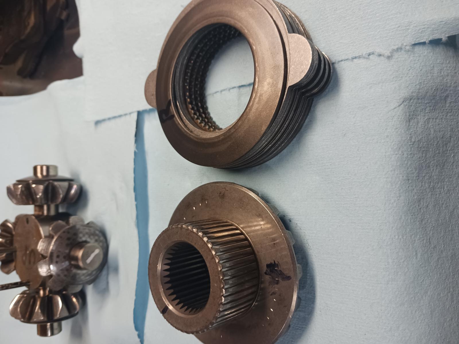

Well I finally received all my parts. The hold up was waiting for the special 5mm X 32mm "S" coiled roll pins (3 have to be installed to hold the pinion shaft and gears). I've been waiting 7 weeks for them. I'm going to include pics of the clutch pack that I have wiped clean and pinion shaft and gears.
I will start to re-install everything into the carrier this weekend and video it. Will try and make in in depth. I will post all measurement, clutch pack stack heights, bearing part numbers etc...

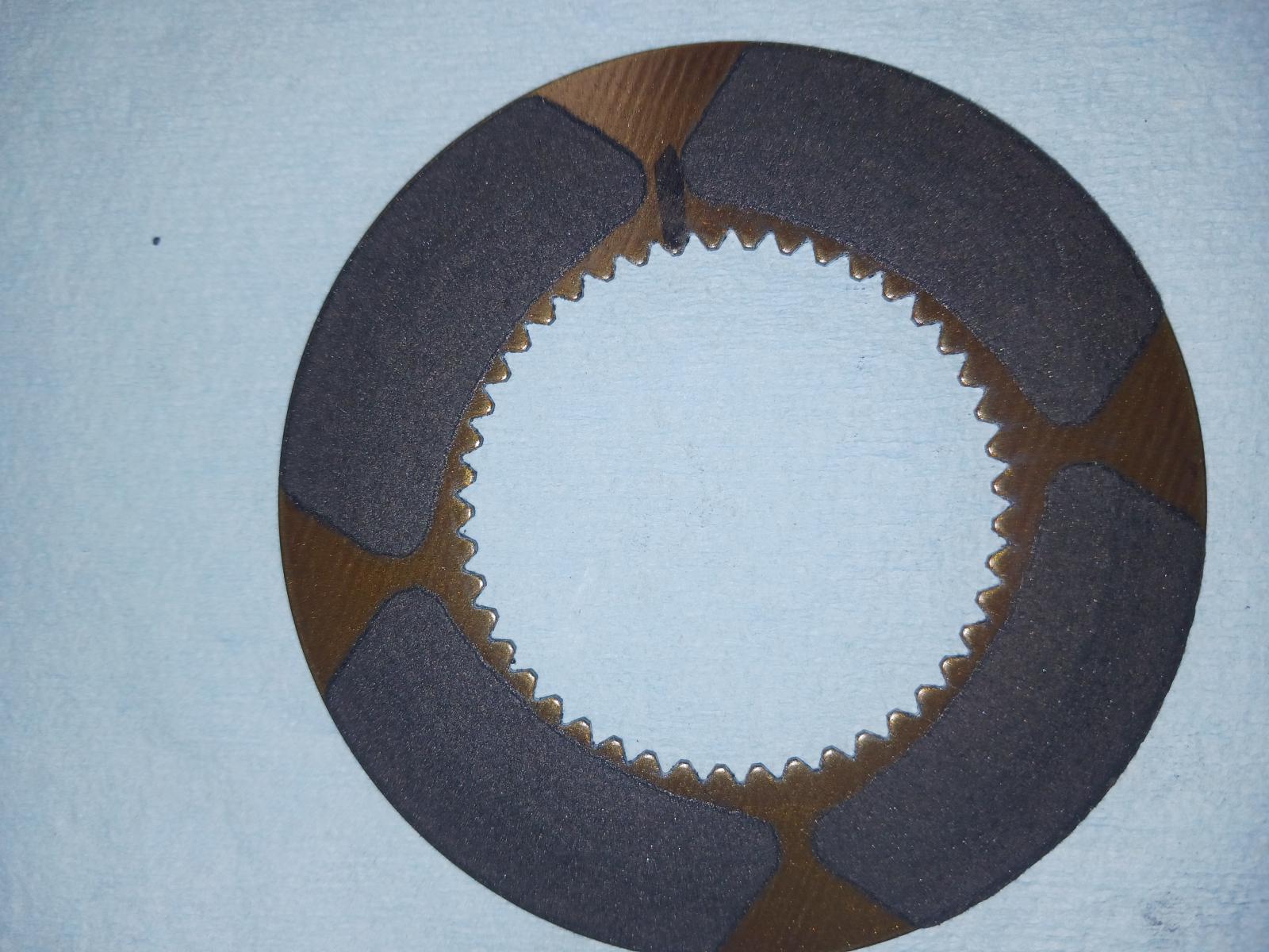

Posts: 25
The friction plates are 45 tooth. The closest tooth count I can find are from Dana diff which use 43 tooth frictions (which we still can't use) As of now, I cannot locate any of the clutch pack parts anywhere. If your clutch packs are worn, we're shit out of luck.
