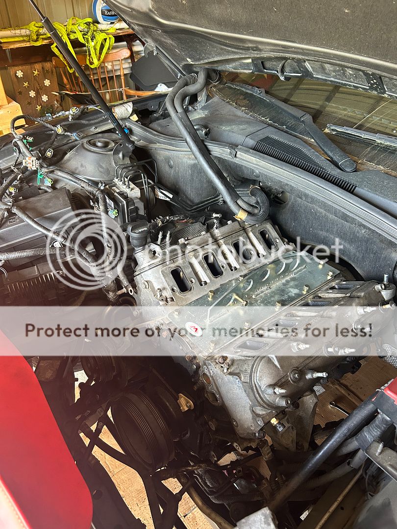

Knowing that there’s metal in the oil, I started the teardown with the end goal of pulling the engine. I went right in and started removing exhaust, PS pump, water pump, alternator and a/c compressor. The a/c was the most trouble- there are more bolts holding that bracket on that you’d imagine.
Here’s the engine ready to come out with a Motion race works LS lift plate in place of the intake manifold.

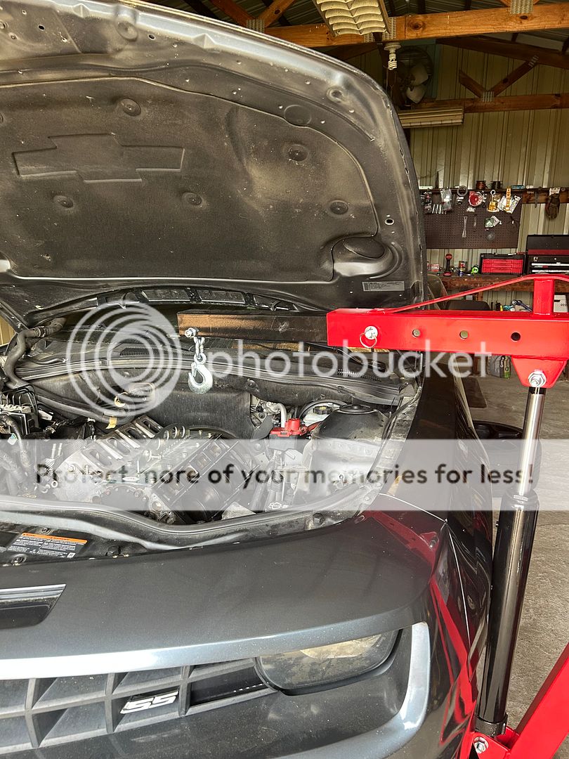

Here you can see that the lift wouldn’t reach the engine. It was way off from the side. From the front it was closer but still couldn’t reach.

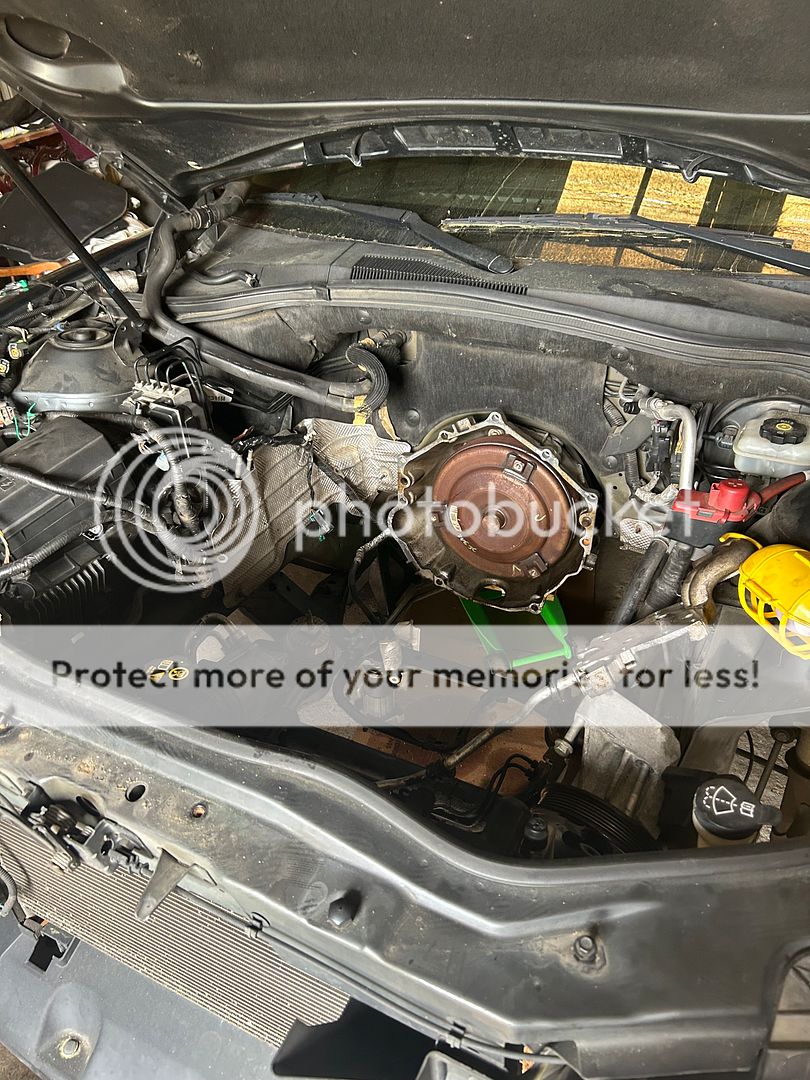

I eventually had to take the bumper cover off and even then do some shenanigans to make it reach. Here it is out of the bay with the harnesses and a/c pulled back.

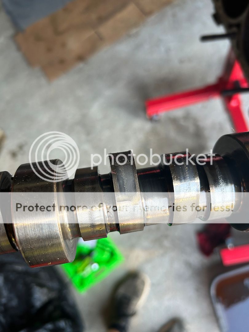

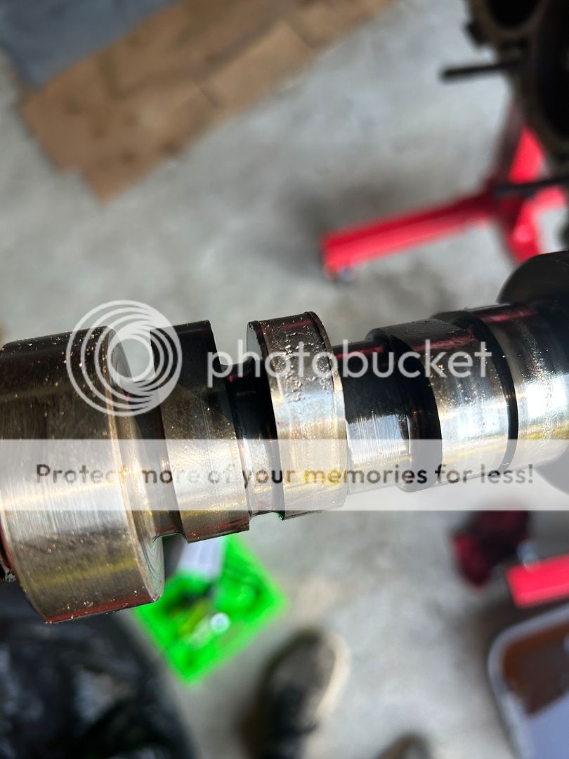

Houston- we have a problem
This rocker won’t budge. It will spin ~45 degrees but doesn’t move in or out. Something’s wrong… whatever it is- it chewed up the cam.
I’m assuming that’s the source of the metal in the oil. Probably didn’t spin a bearing, but hits highly likely they’re all toast with particulate being forced through the oil.

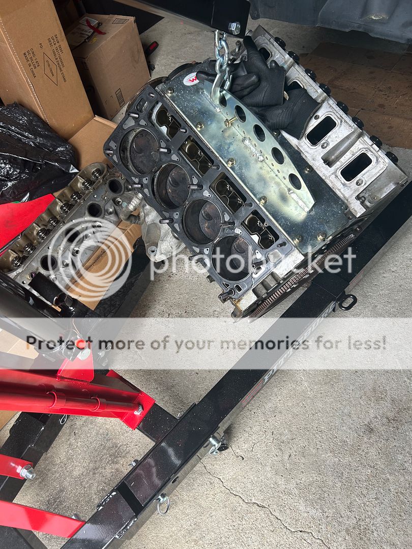

Before heading to the machine shop I wheeled the stand outside, emptied a can of gum out engine degreaser on it and took the pressure washer to it for a while.
I put the heads and intake on it to clean them and also keep from making a huge oily mess.

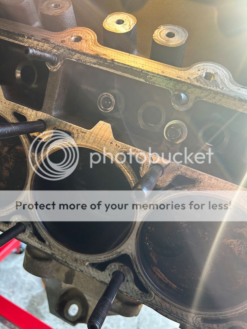

Though they’re messy, the heads and pistons look pretty good. Tune was a bit rich.

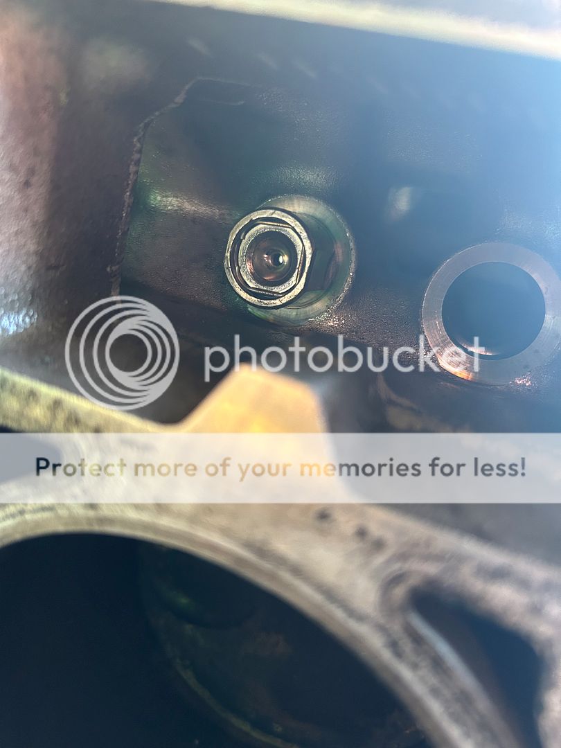

Took the oil pan off and found more carnage:

I initially thought I found the source for the lifter failure. If you can’t see it those are needle bearings that have rebelled and took a hike.
Here’s where it gets interesting- when I put the cam in 20k miles ago, I also did valvetrain, including the CHE trunnion upgrade. It shouldn’t have any needle bearings left in it. Anyone know another parts that uses them?

Looks like maybe the guy who owned in before you (unless you bought it new) hade a rocker failure. To answer your question, no there's not anything else in the engine that uses needle bearings. Also on the engine hoist, it's adjustable. If you take that bolt out on the arm and move it out to the last bolt hole and then put the bolt back in it will be a lot closer. BUT, I think that I have the same hoist, and it still doesn't reach with the arm fully extended. So, I moved the arm out where it was dead over the engine, marked the arm in the bolt hole with a marker, then redrilled the bolt hole on the arm, and then put the bolt back in. While I don't think that I would do this on an iron block it's totally fine on an aluminum block especially with the all the accessories and the heads removed. So, I don't remember if you said that you were ever going to add a power adder?

It was in the last available hole. I thought about drilling one more as well, but made it work before resorting to that.
No, we got it used. Agree- must have had an oem rocker go out. Pretty amazing they can just roll around in there for years.
