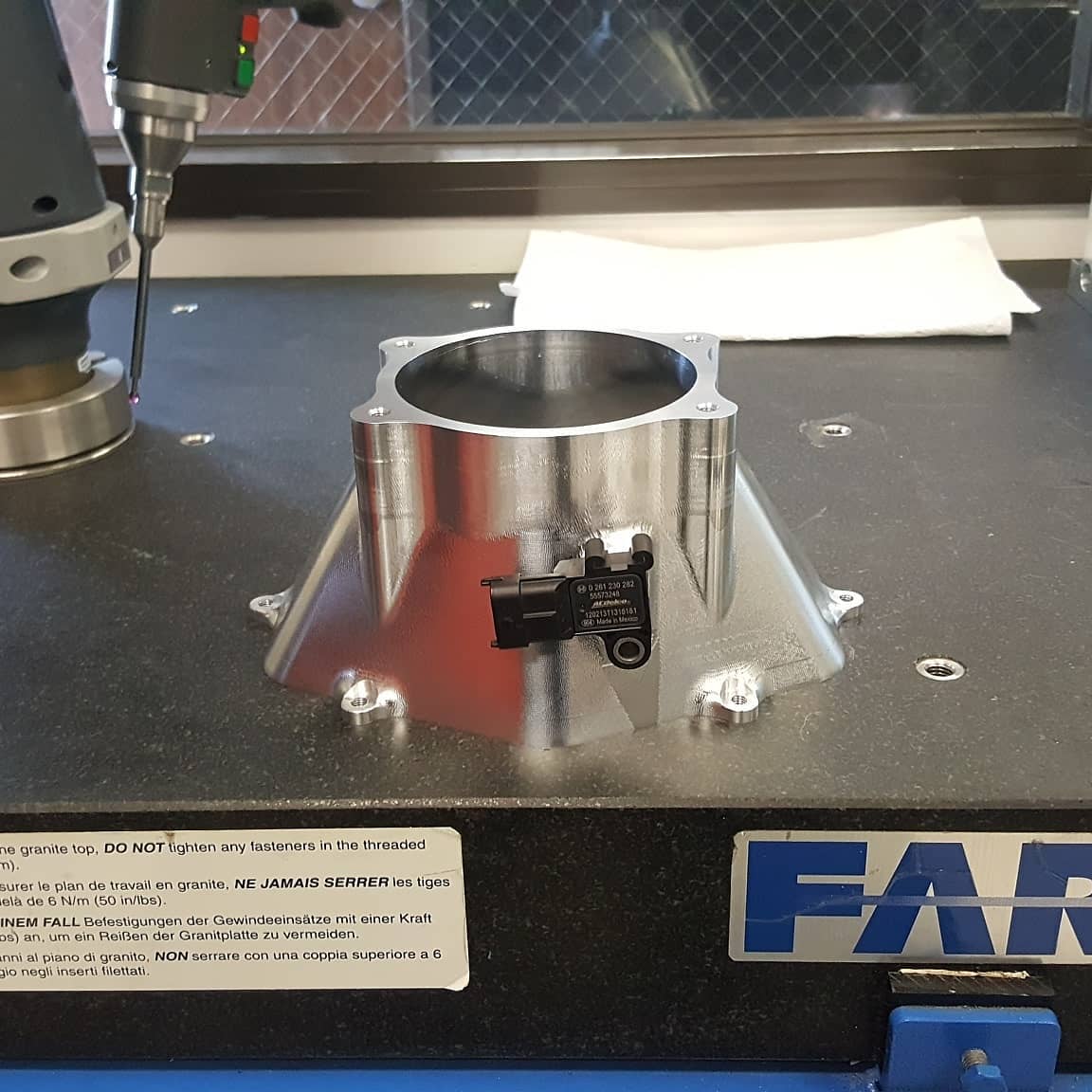

If the MAP sensor is the problem, here is where mine is located on my manifold, and it looks like in one of the pics in the link you posted that there is a provision for it up under the front of your manifold.
Name:  lod snout.jpg
The hoses can be run as needed to clear.
