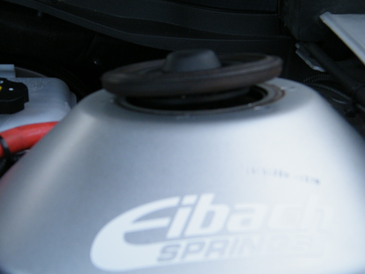

The strut tower ends seem to be out more on the ends after my eibach install.....Even more soo when i turn the wheels is this normal?
Wheels straight
Name:  wheel straight.jpg
Wheels turned left left strut tower.
Name:  wheel turned left.jpg
Is all this play normal after drop springs?
Wheels straight
Attachment 145296
Attachment 145297
That is normal. Every car is like that whether they have OE or aftermarket springs installed. No need to take it back.

The ZETA II Camaro is derived from the ZETA G8. The ZETA G8 is derived from the VZ Pontiac GTO. All are Holden based GM platforms. The earlier versions through the G8 used a rubber donut for the strut mount. Driven hard they wore out quickly. The ZETA II Camaro use a steel 'cake pan' covered in rubber with fiber reinforced plastic bearing plates and spring perch. The ZETA II mount will not suffer the same wear issues the earlier version mounts did.
The articulation you can see through the movement of the strut retaining plate is required to prevent the front suspension from binding when the wheels are turned. It also graphically illustrates why the Camaro does not require massive amounts of front camber. As the wheels turn camber increases due to the position of the strut shaft in the upper mount.
