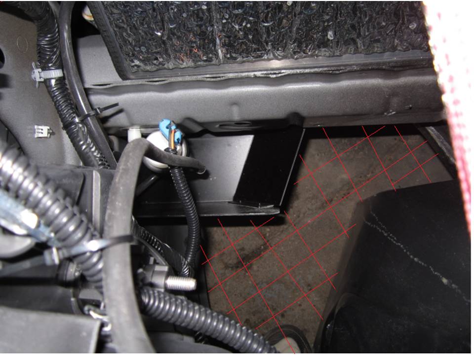

Is there anything that can be done to grab air under the car and direct up to the filter through this big opening?

I did something similar to this last week.
http://www.camaro5.com/forums/showthread.php?t=208229
That pic is actually a bit misleading. That was before I put the wheel well liner back in place. That's why it looks like there's that huge gap. Once it's snapped back in, it looks more like this
Cool, thanks. I may try to work out something.
Gotcha, thanks. I was thinking if the whole is that big, lets design a scoop that draws air that way.
