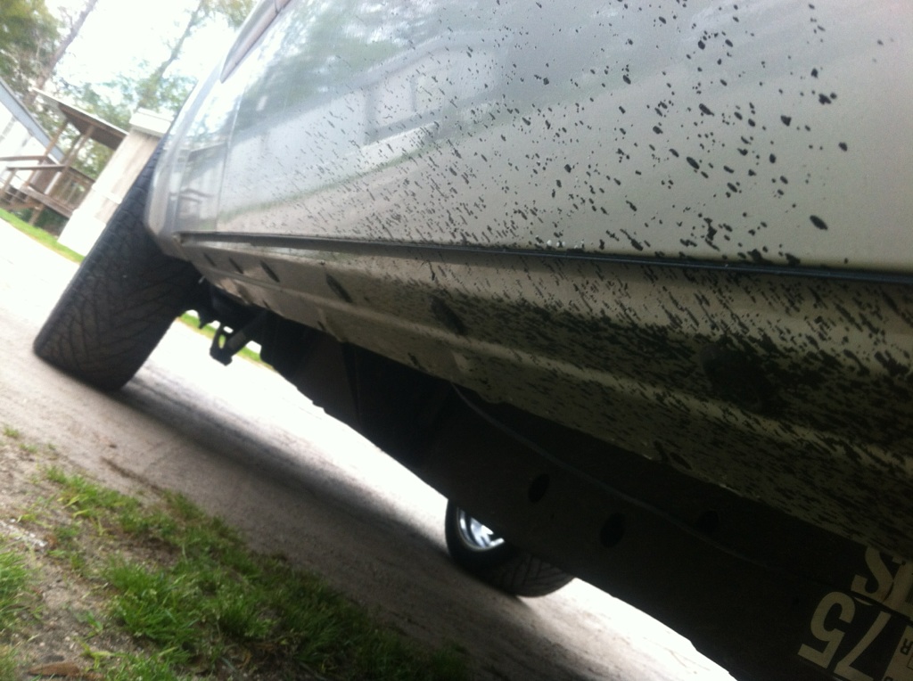

Does anyone know of a good way to remove tar from your paint. Luckily it's not on mine.
My son left work yesterday and they had re-paved the road in front of his shop. He had no choice but to drive through it. It is all down the sides of his Silverado. Ya he's mad. Anyway, I know of most things that will remove a little tar but this is going to need something strong. (it will take more than bug an tar remover to get this off).
Any suggestions out there?

Make the street Department pay.
If they won't, get a product called Tardis.

Tardis, tarminator, or kerosene. Tar x also wouldn't be a bad choice. It is on bogo at AG too.

The best thing I found that works is rubbing alcohol.

He is checking into getting the city to pay. I was just trying to find something that he can use to get that crap off.

Good luck. They should.
WD40 works also and is safe for your paint and is in everyone's garage. But Tardis is the best.

Thanks for the replies. I will tell him to try to find some of these products. I know how hard it is to remove tar. I was trying to find something that would make it a little easier.

wow....

Gasoline on a rag to get the tar off, wash with soap and water, dry and wax. I know some of you just cringed but I have done it a few times with no problems.

I used some adams all purpose cleaner cut 1:1 with water and it took road tar off. I know lighter fluid you use for the Bar-B will work...of course wash off both right away and then wax..same with WD...they do make a goo-be gone for paint...do not use the one that is not for paint...man that is a bad and no way they should have let traffic on that freash of a lay down..

Turtle Wax makes a Tar and Bug remover product that turns that stuff to mush and wipes right off... works great for cleaning off the VHT and rubber from burnouts at the track too..

I ran over a can of spray paint a couple years back and just wetted the area in diesel, let it set 10mins....it wiped off, washed with soap then waxed it. All was good.

He's got APC. I'm not sure if that is strong enough. If I was there I could use something like gasoline or goo gone but I'm not sure if he is willing to try something like that on his paint. I guess I will have to talk him through it. It looks like he is in for a lot of work.
