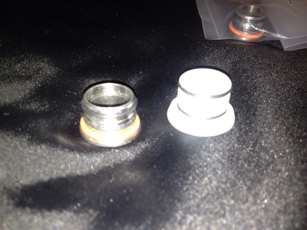

Posts: 659
Here are the pics of the new Hurst (race bushing) !!!!

There are several of the above pictured "extreme-duty" bushings in the field. Construction consists of a stainless steel housing with a high temperature polymer resin inner bushing (rated at +500°F operating temperature). The stainless steel housing is also equipped with various o-rings that create an extremely tight (yet completely isolated from vibration and noise) compression fit within the lower part of the Hurst shifter.
