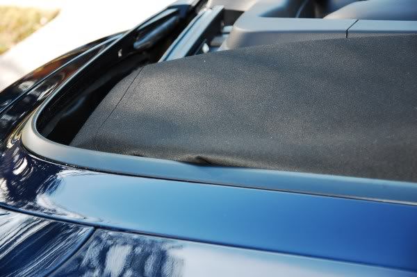

Well crap. This just started happening at 10,000 miles. I thought I dodged the top bullet, but NOPE. Appointment Monday to document my stupid rub marks.

It looks like thats a top down photo, what does it look like up?

With the top up there's a rub mark. Actually I have lots of rub marks starting. The worst is a long one where the first bow is. I'll try to post a picture tomorrow.

This may be a dumb question, but is that just cloth bunched up, or is something underneath poking it out like that? TNX.

Look here...http://www.camaro5.com/forums/showthread.php?t=248940, post #8. In it you will see before(old top) and after(new top) shots of my car. The new top retrofit replacement kit controls the material folding much better than the old top. My car had the exact same problem and if I drove around without the tonneau cover, rub marks appeared.
BOTTOM LINE ---- Bring my thread to the dealer and show them. Then start requesting/demanding a new top. Keep your cool, be professional but stand your ground. If you don't get "ok sir, no problem" for an answer then start the phones ringing at the GM Executive Office and request a case number 313-667-7153. Or private message Brandon on this forum. He should be able to get a case number started for you. Trust me, if your dealer does not seem helpful then you need to get this process started. Also, if your dealer has not worked on these tops it is in your best interest to request a GM field engineer to assist your dealer. You may be lucky and a service tech may be able to teach himself on your car. But the retrofit kit top contains many new tension cords, rivets, tension cord attachment points, the requirement to drill holes in the frame at the correct locations and many other detailed things that have to occur. You don't want just anybody doing this job.

I have the exact same issue with my original top... All is well except the damn thing flapping in the wind and rubbing against the back deck. Your explanation is the best I've seen yet on the topic. Question is... Is this a time tested retrofit? I am really weary to let my dealer touch my top just yet until some time and training has passed. I'm open to feedback.

My top goes down just like in the OPs pic. I simply tuck it under with my hand and no problem, no rub marks, nothing.
IMO this would not be worth having the top messed with....... just my .02

My build 12/11/2011 does the same thing. Same thing from my dealer. Fine.. I'll wait till it rubs enought to become a hole and GM can spend a lot more money fixing it.

cam62, yours does look excessive, protruding more. ours is just on the drivers side and sticks out just a bit.
