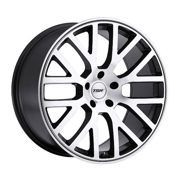

Ive had TSW rims on my last two cars and i love the staggered rims they have. Im looking at these for my soon to be summit white 2SS. I dont plan to go bigger than 20's i like a little fatter tire on the sidewalls. I like the look of these due to huge rear 5"in rear lip.
these measure 20x8 front and 20x10 rear. +35 offsets all way round..i believe. as for tires im not sure, i want to go 275 front and 315 rear...will these work for these rims with this type of offsets? ive done some searching but couldnt find anything in paticular about correct offsets for these size tires and rims. any help much appreciated

i dont think the 275 will fit on the front with just a 8" wide rim. you would need like a 9 plus to run that. But 315 maybe im looking into that too

ya your right the oem fronts are also 20x8 so im guessing standard tire for the front and probably 305 on the rear. im guessing anyways. dang i sure wish they made these a little wider. some 20x9 f and 20x11 would have been awesome.

you could do the 275 on the front, but I don't think you will get a 300+ on the back without have interference problems, talk to the place you plan on buying them from and if they are reputable, they will mock up one and do a test fit on your car, ensure NOTHING rubbs, ANYWHERE, ensure you look BEHIND the wheel/tire.

i tryed the 20x8.5 +20 and 20x10 +35 on my v6 and i dont think they are going to clear the rear calipers on the ss i would run 265-45-20 front and 305-35-20 rear

I like TSW....these are nice (IMO) and i agree with the above....255/265 fronts and 295/305 rears with lowering would work well

The offset on the rear is 39 mm

i cant see the pictures, but I also bought TSW jaramas they clear my bembros
no promblem going with 22s 10.5 rears and 9 in the fronts going with Nexxen tires 25 and 30s. The rims were'nt all that heavy either Good luck TSW were a good choice doesnt knock you up the head with a crazy price tag.

i didnt think they make 22's in this style of rim's according to the web site 20's are as big as they get. I like 22's, however a few that i have seen on here make the camaro look like a charger from the side. Massive wheels on rubber band thick tires. on some cars that look works but for my taste a 22's are a litte much. I would lke to run 305's in the rear...maybe a little spacer can help that
