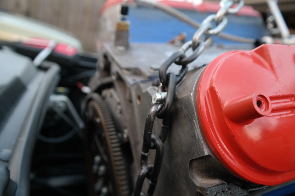

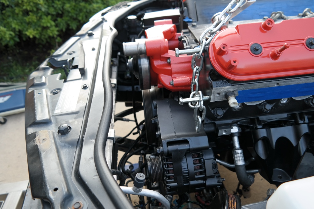

So I bought some harder bolts and had to cut them off because I could not find short enough ones. hahaha
The next guy who takes this engine off is going to need a 15mm socket AND a 17mm socket to get them off.
Here are the only pics I snapped.

Did you have to shear the chain bolt for clearance?
