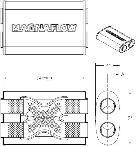

i am not sure if the exhaust shop i went to installed my magnaflow resonated xpipe correctly. i thought that you take out the hpipe and put this in its place. but he said no you take off the 2 stock resonators and put the xpipe there since he said it wasnt actually a pipe? so my 2 stock resonators are gone but my stock h pipe is still there and he took off that metal piece thats bolted on where the 2 stock resonators were so that the xpipe would fit. should i take it back and tell him that he installed it wrong?

Mine is fully custom. But I did what your guy did. Heres my set up. I like the sound a lot.

Also the piece he removed is your tunnel brace and isnt necessarily required but it is not meant to be taken off. I have mine off and have had it off for thousands of miles, but am replacing it with a reinforced one with a different depth, so my xpipe doesnt hit off of it.

thanks guys but i thought the whole point of the x pipe was to remove the h pipe. all he did was remove the stock resonators and put the x pipe there in its place. should i go back and show them those pics u put?
That is the usual location, and yes usually is used to replace the h pipe. But its real purpose is to reduce rasp. Since you eliminated your resonators you will get a louder, but not raspy exhaust set up.
Basically the xpipe will do its job perfectly, but will be a little louder since you took away stock resonators. The real question is, Does it produce the sound you wanted/expected. If not, have him put them back in. This will probably cost you extra as you should've been specific before the install and not after.

As for the sound, I installed the X pipe to take care of the RASP that was produced from the LT headers. Putting it where the H-pipe seemed like the only logical location. Not sure why a shop would drop it in where the resonators are located.
