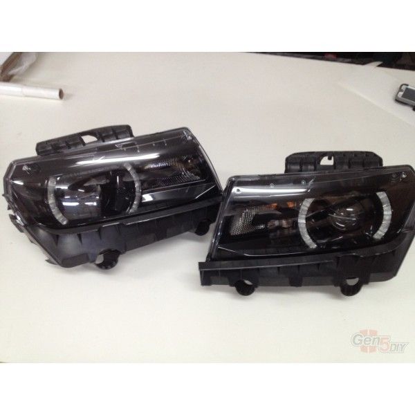

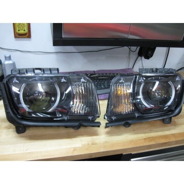

Night owl doesn't make them for 14-15. It's a completely different headlight and a completely different halo also so they won't fit the 2014. Only Oracle has them for 14-15.
2010-2013
2014-2015
From gen5diy sight.
I still use night owl controls. Just was forced to use oracle leds due to no one else offering them
