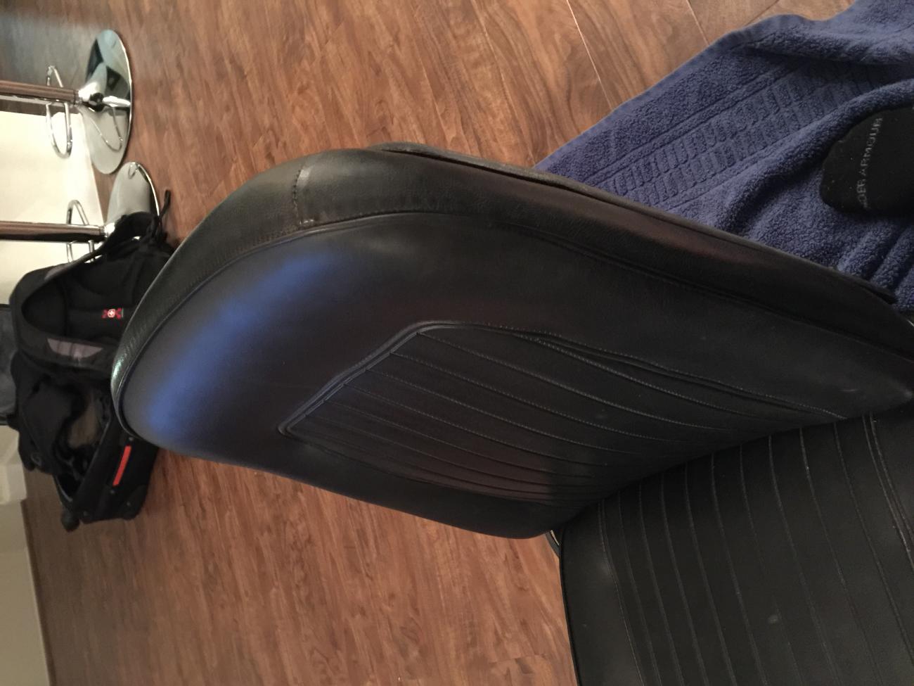

Im finally getting around to posting this. THE project - 1968 Camaro SS/RS 396
Ive dreamed as a kid of owning a first gen, and I was even overseas when I bought this camaro, having to wait 2 years to even start on her! She has been off the road since '78, stored in a barn for the last 37 years! From what I've broken down so far, this camaro is not all that bad! Sure the floors and trunk pan have to go, to include the drivers side quarter, but honestly I couldn't be happier finally able to own and restore this beast! Interior is flawless, it just needed to be wiped down good! Not a numbers matching car, not original 396(has a 396 from 69/70 chevelle), however I didn't buy it for that. I have no reason to believe it was not an original 396 SS though. Clues I've found, and feel free to help me if I missed any, big block heater box, 12 bolt rear, upgraded factory front disk brakes(or if built after april '68 front disk were req'd), rear multi leaf springs, no A/C, all SS badging(I know this could all be purchased back then and added later), rear tail blackout panel(only on 396 camaros other than black color, from what I read), Paint code is cordovan maroon so it had the tail panel, SS heavy duty hood springs, 2 1/4" dual exhaust, 3-core radiator...
Photos to come, as soon as I can get them uploaded...

Just a couple updates so far....Working in a small garage at the moment so im limited, but body is mostly gutted getting ready for a full media blast. Engine out and being broken down for complete rebuild, finding all kinds of knarly stuff!!
