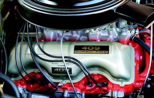

Wasn't the 348 a tall deck or something? I remember there being something odd about it.

yep.....it was called a W block code.....only two engines built with that specific configuration was the 348 and the 409. it was very obvious when you looked at them as the valve covers looked like upside down W's
