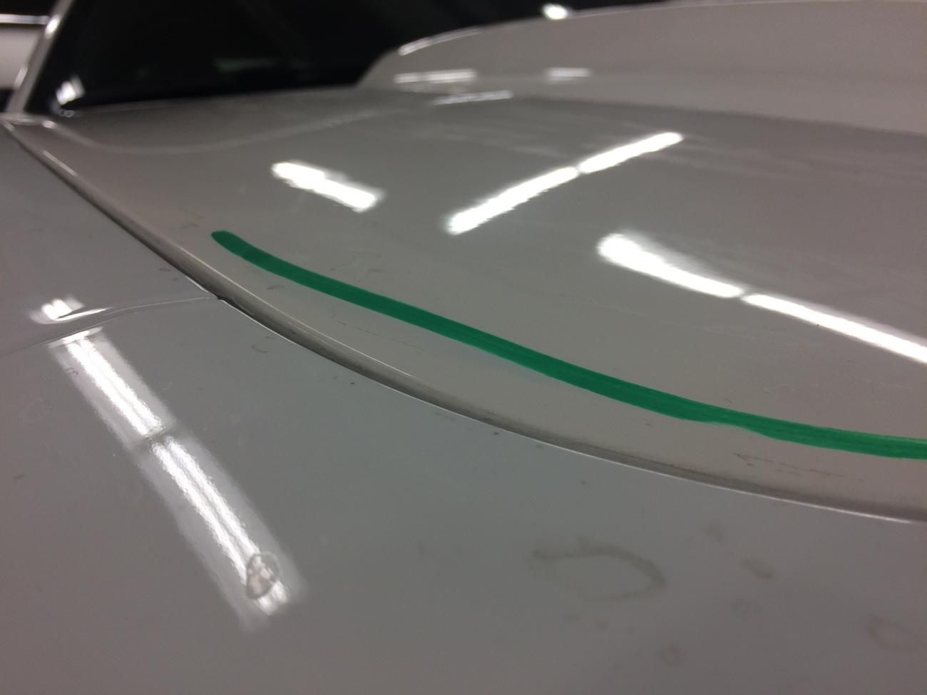

If anyone has tips for adjusting the Sinister hood, I'd greatly appreciate it. Ordered it from PFYC and got it in the other day. The shop called me this morning to come take a look at it. Long story short, two issues -
1. The hood fitment was really bad
2. They wanted to be sure that I was ok with an additional 6 hours of labor because it needed quite a bit of work.
The main thing obviously is the fitment. It's a little hard to see in the light, but basically one side we adjusted the hinge and got almost perfect. However, this made the other side raised quite a bit. And more importantly, a huge dip at the point of the hood.
Obviously I called PFYC and they didn't really have much advice but to put me in touch with the manufacturer. He told me that I was the first to ever have this problem (LOL - seen several threads here that say otherwise), but that if it was not fixable, he graciously offered to take it back and re-ship me a new one. However, he said these are all made the same and most likely it would have the same issue.
The technician thinks that if he takes the bumper off he can adjust it some on to help close the gap but he's not sure. He also hopes that there is enough play in the latch to hopefully close the gap at least some.
I attached some pictures. Other than the front, it's a little tough to see the way it sticks out on the side from the pictures, but is more obvious in person. Hopefully someone here has had a similar issue they were able to remedy. Any advice would be much appreciated. The problem we're having is if we adjust the back sides, it throws the front of the sides off. And the front, we're just not sure.
I know that there's been some issues with these hoods, and bought it thinking it would need some work. Obviously, I don't want it to have the huge red flag of aftermarket hoods when any eye can tell the fitment just sucks. Hopefully we can adjust it.

well, quite a while later with a ton of adjustments including taking off the bumper and playing with it for about 5-6 hours we got it pretty decently lined up. Went ahead and paid for it to be prepped and painted (6 hours) but it looks like there is some issues with the sanding and painting so I'll have to take it back to the shop to have it re-done. The edges are INCREDIBLY rough, and even though they sanded and sanded, there's some spots they didn't do good enough.
Anyways it's dark out, but here's a few pics.
