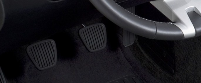

Well I hope these aren't the final numbers ............. but like I said ---this pic speaks for itself!
