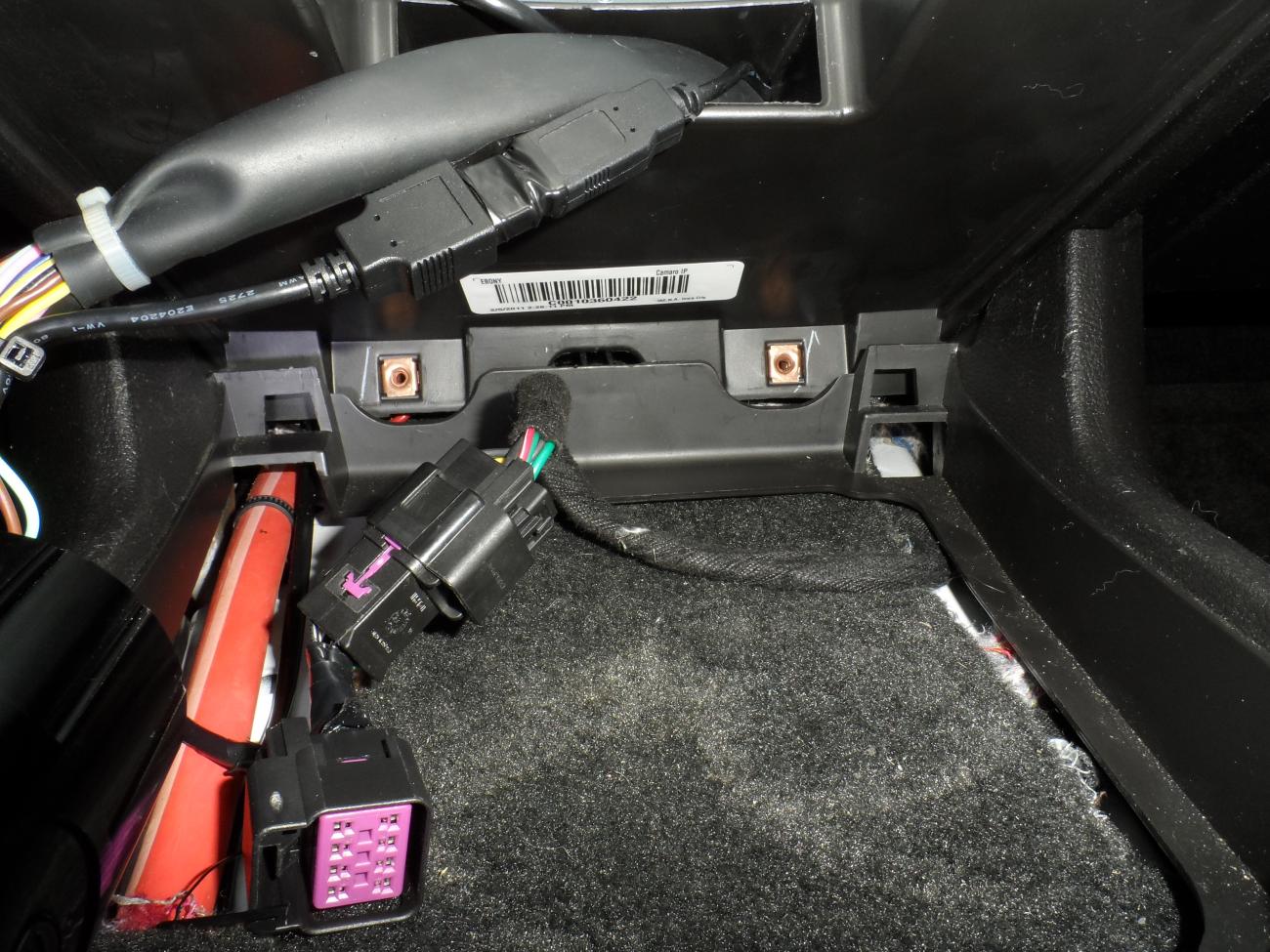

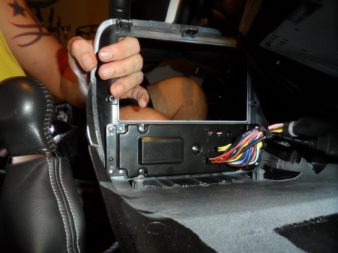

Yeah... here's a better update... I was typing from my phone before, this is a little better..
Unsnap the center console plate... once you get one tab out, work your way around with either your fingers or a trim tool... the 4 pack cluster will pop out with it (if equipped.)
If you do have the gauges, there's a wire harness plug to disconnect before you can get the trim piece out, never dealt with non gauges,assume it's still there for the ac plug and trak. controlls.
There are two screws directly at the back of the dash below the radio that need to be removed
The Scosche plate snaps on. Its cheaply made... and you've got to lift the far back portion (where the screws were) up and over the trim plate in the back but be careful not to break the incredibly cheap plastic weld they used to join the two pieces together... I broke mine on both sides... a lil JB Weld on the inside reinforced w Gorilla tape took care of this.
The unit itself attaches with (4) small phillips head screws, one at each of the furthest outward points. Simply unscrew those and the unit seperates from the plate. Then just unplug the 2 harnesses and your set. Pix below from tonight as I tried "loosening the rear screws" - technical instructions from customer service on how to "fix" my sticking buttons... didn't work, big surprise, huh?
Pic 1: Center console trim removed, with 4 gauge cluster
Pic 2: Harness under trim plate that needs to disconnect (My harness has an additional "segment" which controls my dashboard ABL.)
Pic 3: Rear view of Scosche kit still installed in face plate- note the outer most corner screws that need to be removed (3rd from center top/bottom)
Pic 4: Close up of (2) screw holes that were removed behind cluster before scosche plate removal
Pic 5: Scosche unit removed from trim (screws also removed) and 2 harnesses that need to unplug.
In case anyone is wondering... the black tape on the rear is covering the speaker for the door chimes/turn signals... the beeping annoyed me. This "queted" it. and the black cable is the USB extention to maintain the factory USB hub in the console.

Wow Thank You all so much for the quick replys and help. I will be replacing this interface as soon as possible. I just enlisted back into the army so I have some stuff going on but I will let you all know when I can. Thanks
