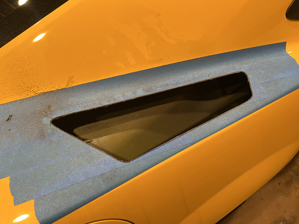

I made some more progress today. I started off by finishing the passenger side. I just wanted to show again how I handle the corners by first removing as much as I can from the center and then I just make a bunch of smaller cuts until the corners are clean.
I was curious to see the back side of the fuel door looked, so while it was open I snapped this photo.

With both holes cut, I was able to lay both ports in to see how they are going to look.

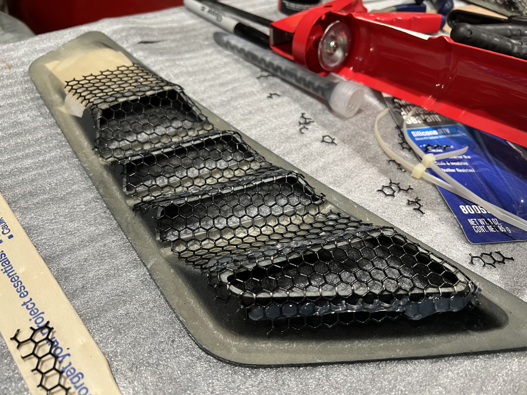

Since the adhesive has to cure for 12 hours, I thought I would do the pans and the mesh grills today. I forgot how hard this stuff is to get out of the tube. Thankfully, I had a tube of clear silicone so I ended up using that on the mesh instead.

After work, I began test fitting and trimming the mesh. This is where having the marks around the edges comes in handy (more on that in a bit). Here’s a before and after shot of the mesh, but basically everything along the sides had to be trimmed.
