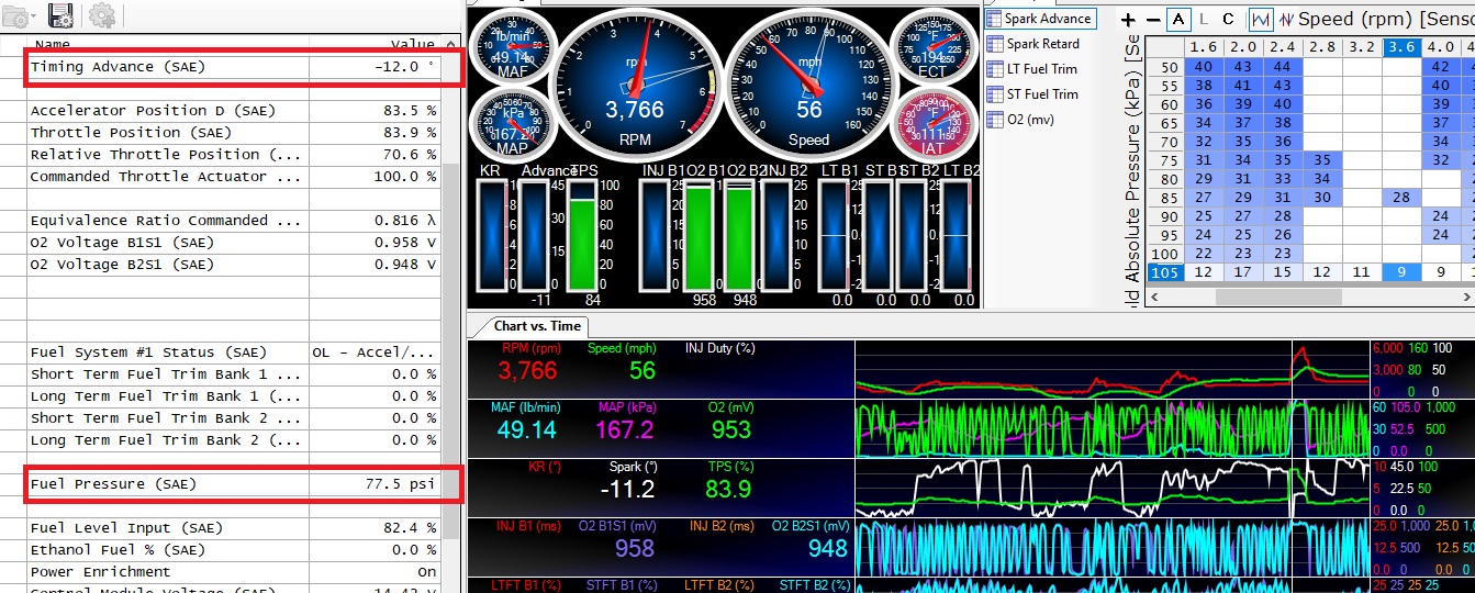

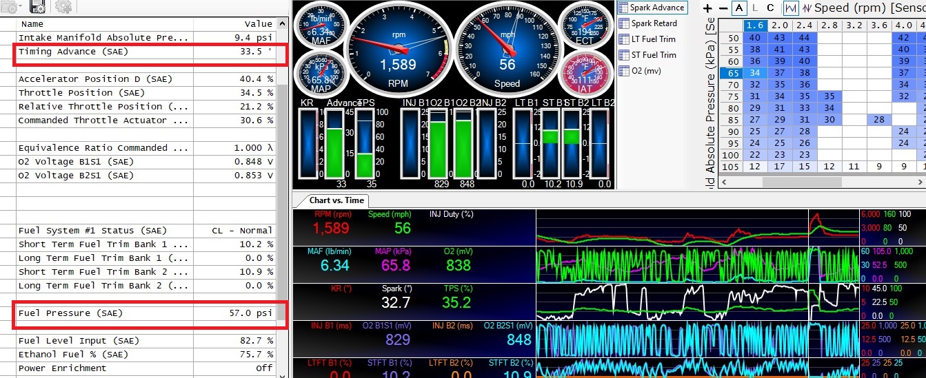

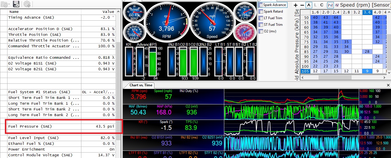

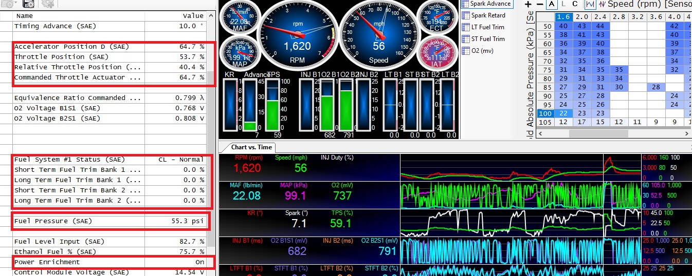

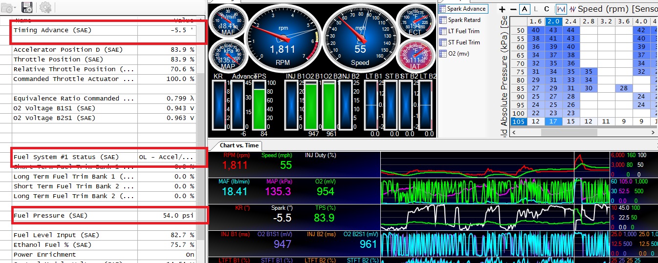

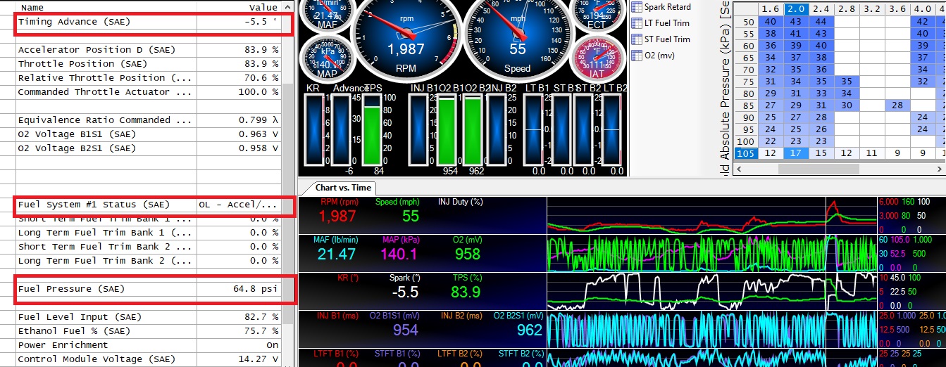

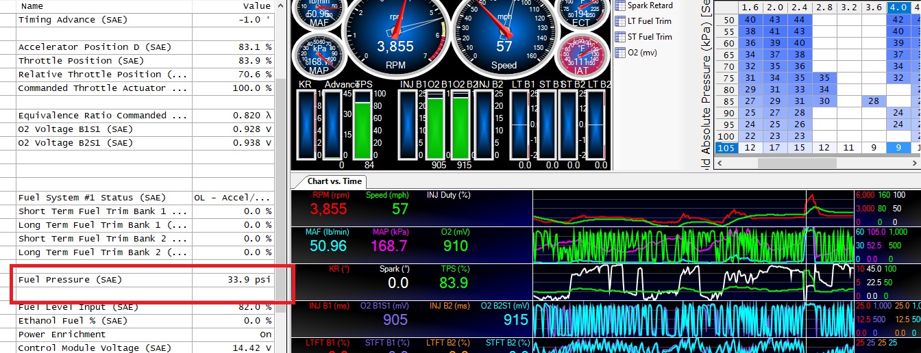

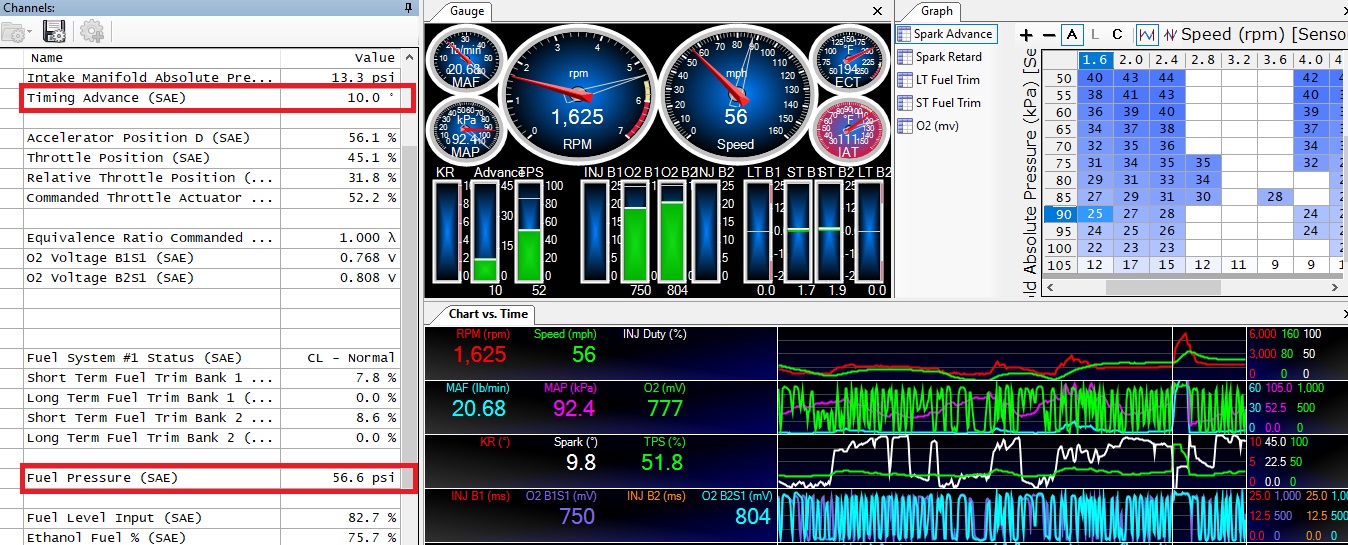

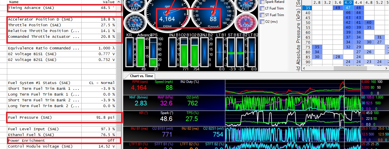

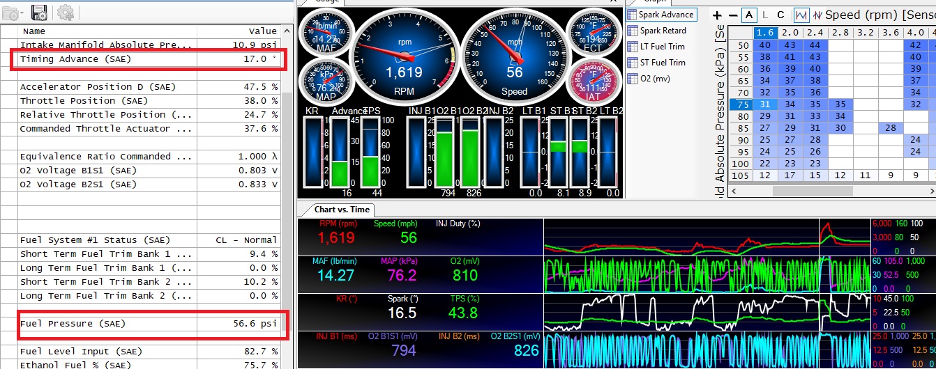

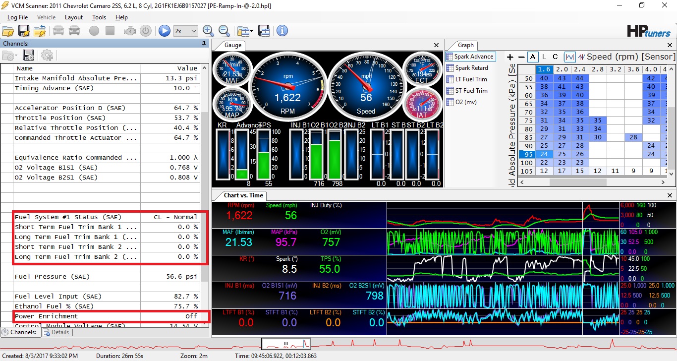

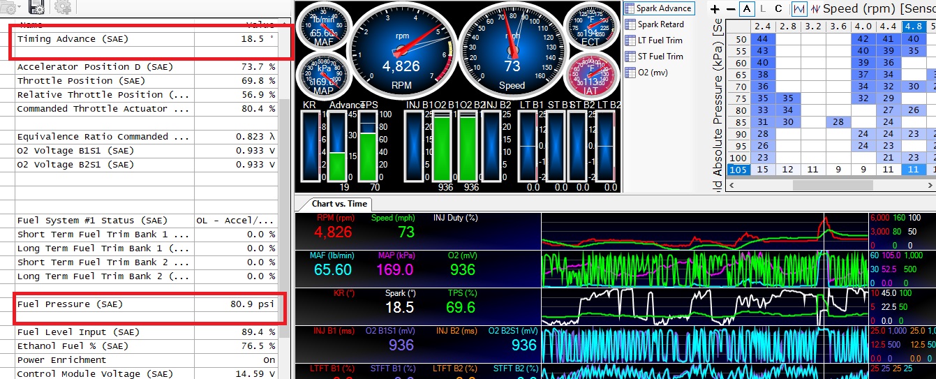

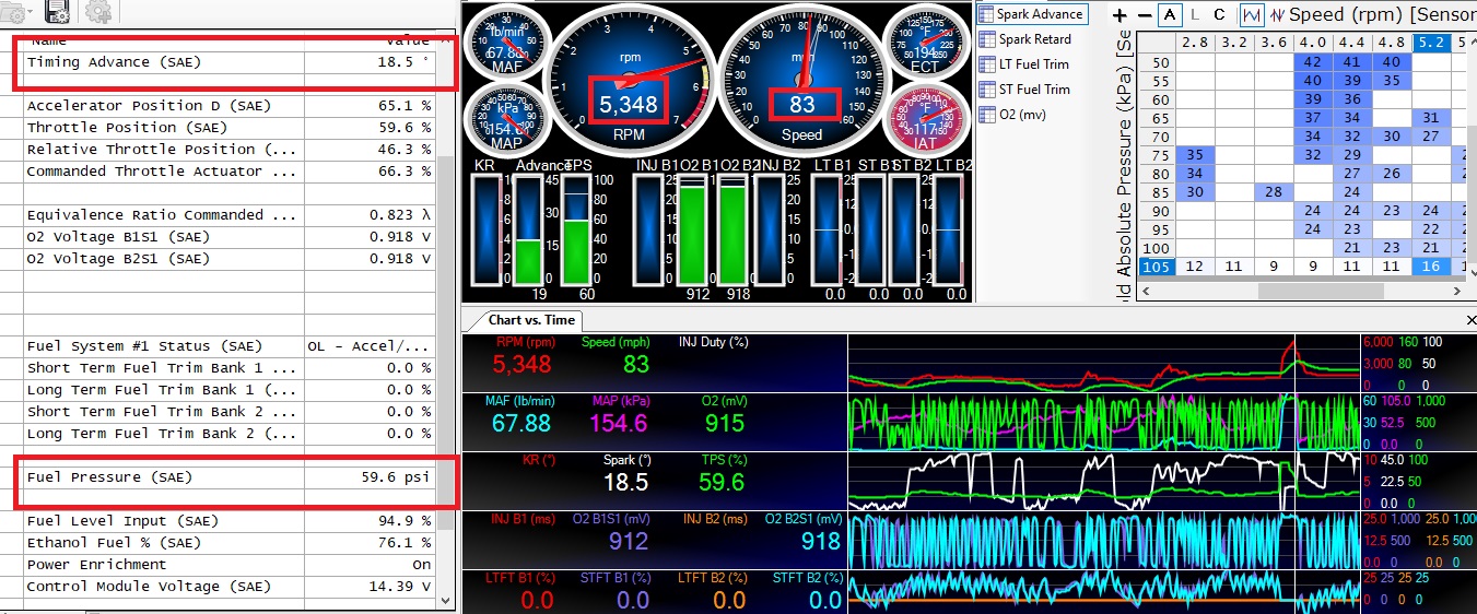

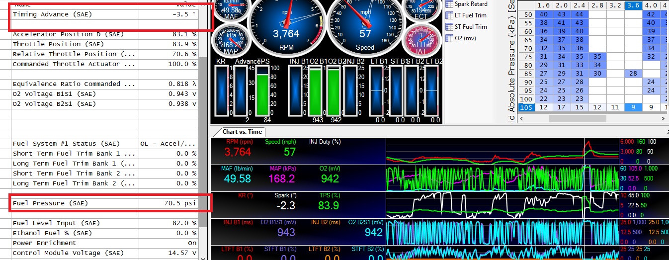

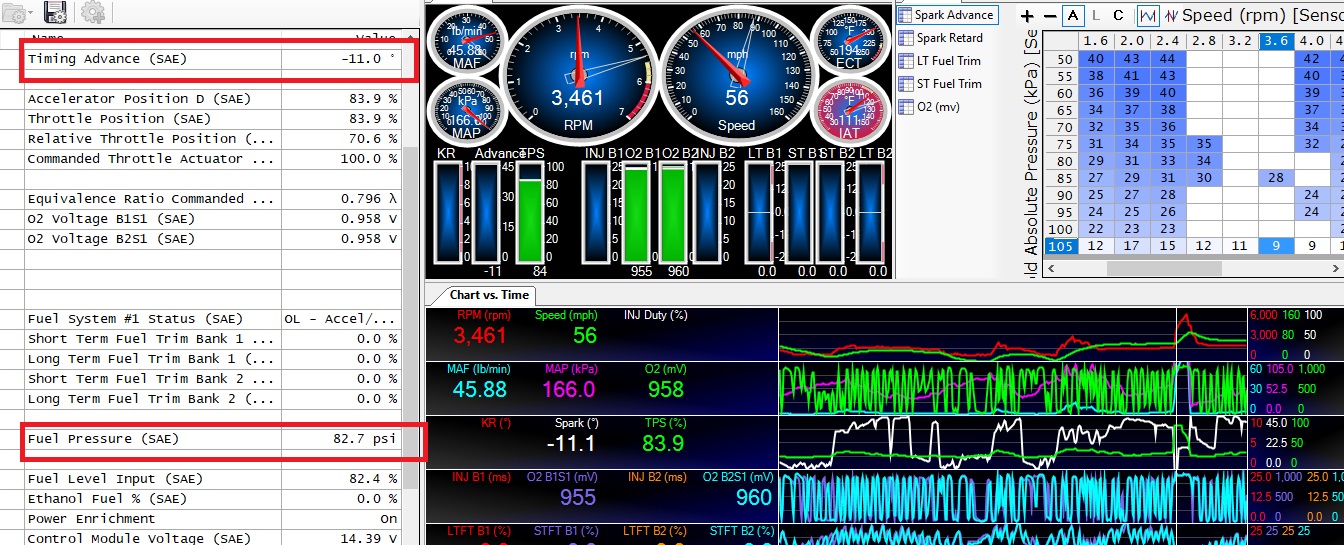

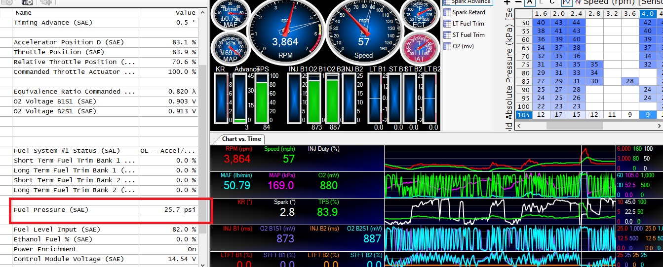

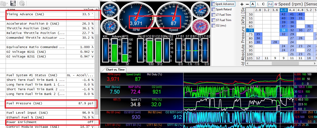

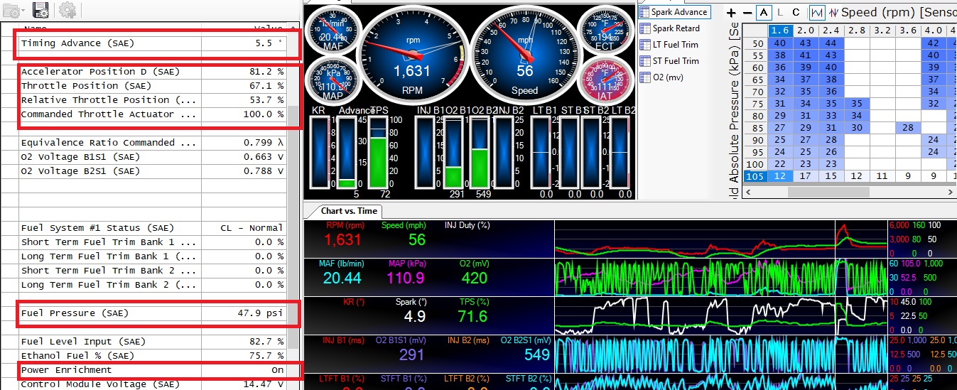

So, I love HP Tuners. I did a scan of my car to find out where the hesitation is. This is gonna be a bit long, but I got 'pictures' ;o). Did all of this testing on a private road a friend let me use...
First a pic before going WOT and getting into the PE settings:
Next start of WOT -- Note the timing being pulled and the fuel pressure:
More timing pulled (NOT in PE yet!):
Getting ready for PE, trims zeroed:
In PE mode:
Pressure dropping, so is timing:
Pressure rising, in FPCM 'acceleration mode', negative timing:
Pressure rising, more timing pulled:
Pressure in the 80's, timing pulled PE Mode still:
Pressure dropping (still good), yet timing advancing:
Major pressure drop, some timing, still in PE mode:
Things rising, still in PE Mode:
Aux Pump kicks in again still in PE Mode:
Out of PE Mode, BIG changes:
So, it looks like 2 issues:
PE Mode, and the Aux pump may need to be tweaked to turn on sooner and stay on for a bit.
Will continue to investigate and look for answers, until Ryan (Or Dave) have time to check this out...
-Don
747 RWHP 794 RWTQ

I need to send you my layout. There's a bunch of other things you should log

Old 08-08-2017, 10:23 PM   #1391
hammdo
'It's an experiment'
hammdo's Avatar
Location: Dallas TX
Posts: 8,709
Thanks!
Well, diag 101 says check for a loose connection, and, based on how the pump was kicking on and off, that is just what I did. I found on the pump the nuts were loosen -- enough that I could move the wires.
So, I'm gonna take it out and see if that was it -- from the pics, it sure looks like that is part of the issue.
I'll give it a try and see. If it solves it, I'll scan it again just to validate.
This scanner is AWESOME -- would not have know to look for a loose connection if I did not see the pump going off/on/off/on again...
I'll keep y'all posted!
-Don
747 RWHP 794 RWTQ

Yeah, its logged -- 75% close to the bottom in the pics ;o)
So, below 2000 rpm, seems to accelerate fine, above that, (2k >) hesitates. So, I'll need to log again to see if it drops fuel pressure again.
I did check the fuel pump connections again, and they are tight -- no, didn't over tighten them -- just tightened enough to make sure they don't move ;o)
So, its still continues, but, I'll find out what I need to log from Dave or Ryan...
-Don
747 RWHP 794 RWTQ

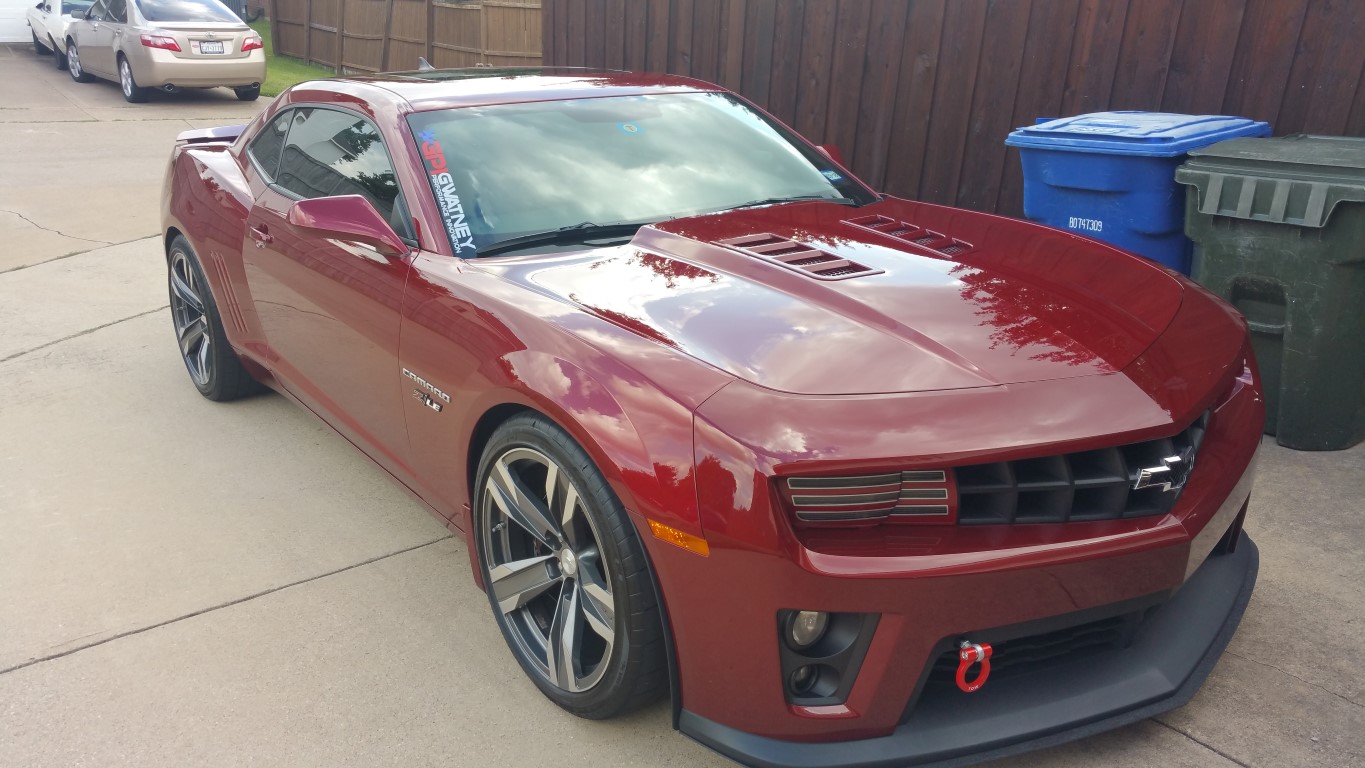

Just got back from ShowroomFx -- Steve does a fantastic job:
It was cloudy today, @ least no rain!
Ready for the Z/28 Cruise this weekend!
-Don

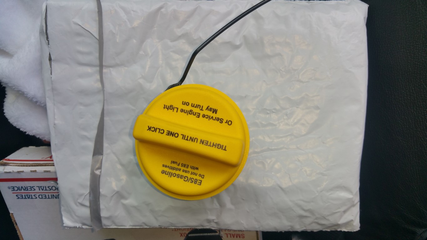

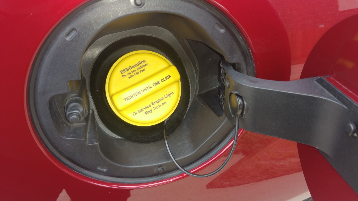

E-85 Gas Cap!
OK, decided to add an E-85 gas cap -- to avoid the panic look I got when I added E-85 in TN ;o)
This is from a 2015/2016 GM SUV:
Part # 22921366 (GT359)
http://www.ebay.com/itm/22921366-GT3...53.m2749.l2649
Fits perfect:
Gonna drive it around and make sure, so far, no issues! BTW, they mean 1 click!
-Don
