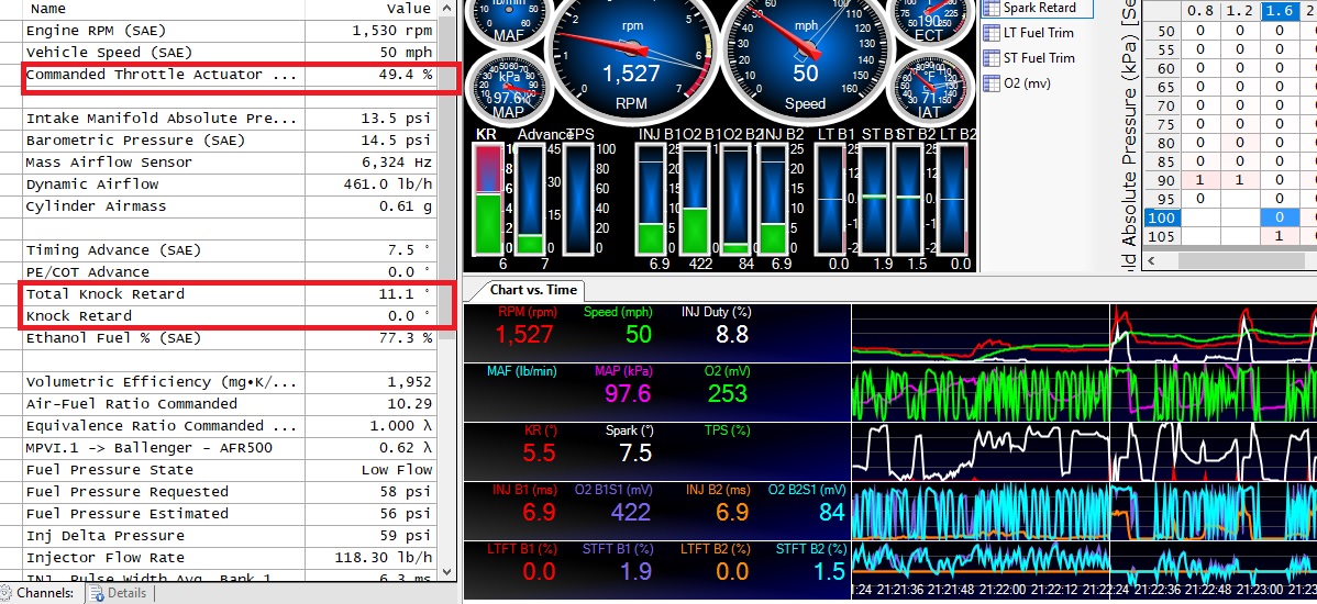

Here you go:
Notice the Total KR (I've seen as much as 1.5 KR as it adjusts, but this is the typical view)
~50% throttle, 11.1 TKR:
100% throttle, negative timing, no TKR or KR (interestingly, the ethanol content is 0%):
OUCH!
All is better now (77% ethanol content now):
-Don

Ok, you should add every possible spark channel to your list. Something is pulling timing that's not in your channels. All of the timing adder and subtractor tables (as I call them).

Posts: 1,673
Oh, just saw your last pic. Looks like you fixed it?

Dave's (DSX) looking over my tune and log. I'm not sure Ryan has time right now he is so busy.
No, that last pic is right after TKR went away, and it finally caught up to itself, then the timing came in and picked up (cough, cough, bam as it were)...
Over on the HP forum, they noted Burst Knock or Torque Management can cause this issue, so I'll wait until I hear back -- but, I'll add the additional items to the config!

OK, logged again, this time with Traction Control Off (but not in sport mode):
Still see timing pulled and Total KR:
Humm... the plot thickens...

I can't tell much from a screenshot. Channel KR isn't matching chart KR. I don't think TPS is in your channels either. It's blank in your chart. Hit the plus button up top a few times to fix the zoom, so that way you can actually read the line behavior on the chart. So it looks kinda like the second pic. Notice the Blue O2's. This will help you diagnose things easier

Got my answer!
Ryan had time to check out the tune and so did Dave.
Turns out it is the Downshift Torque Management. Based on Dave's recommendation, I took the car out and did a 'manual' downshift from 6-3 @ 55 mph and floored it -- took off like a bat out of hell!
Did a 6-4 manual downshift at 75 mph and then floored it -- GONE!
Ryan suggested I do the same thing -- how about that!
It appears, based on both of my excellent tuner's knowledge, I have 'too' much power for the tcm to handle, so, in order to make 'smooth' down shifts 'automatically', it will reduce timing, etc. to enable that smooth downshift. If I do that 'manually', everything is ready to roll, and I can floor it all day.
So, if I want to go WOT, I do the manual downshift, if I just want to 'pass' normally without WOT, the TCM is ready to rock.
