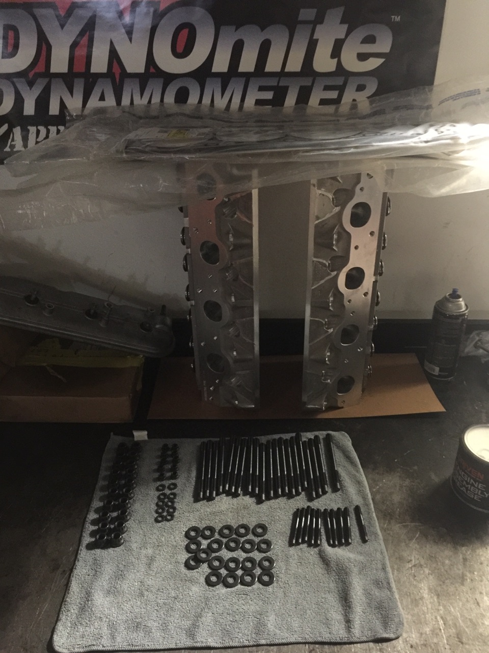

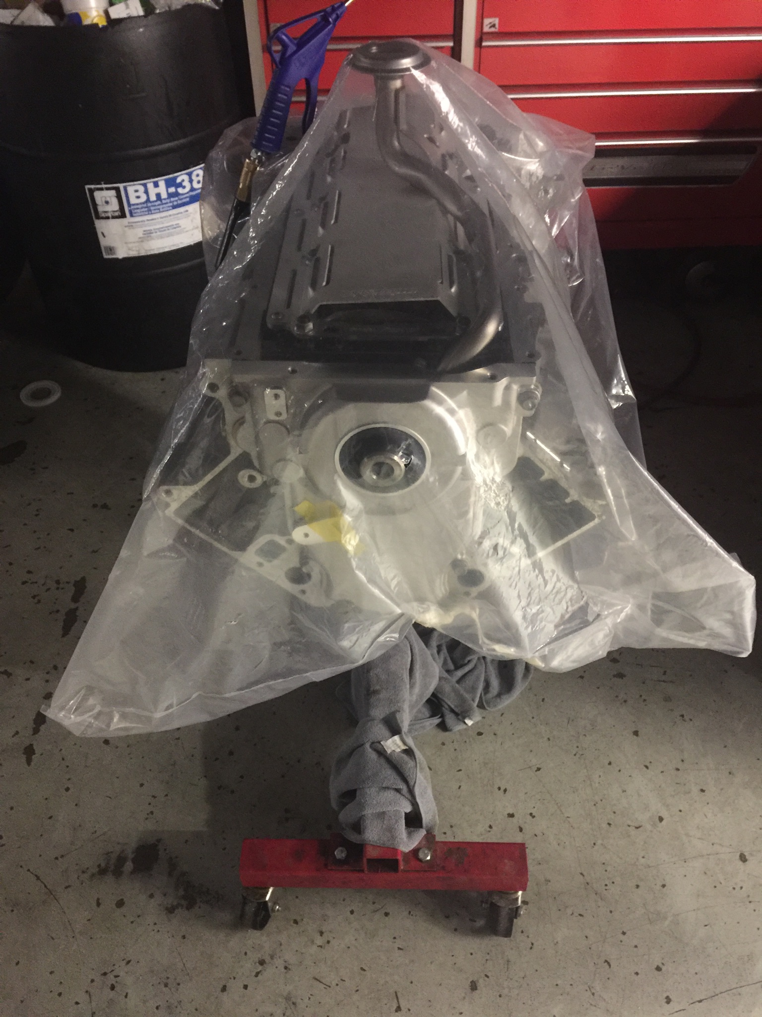

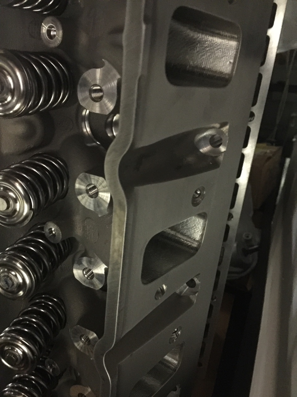

Andy says he has the upgraded pulley kit! Picking that up tomorrow!
Aaron has more 'car porn' for me ;o)
Heads ready to install!
BTR springs on (ARP studs ready to rock):
Ported heads! (Going with the LS9 head gaskets):
Block is ready!:

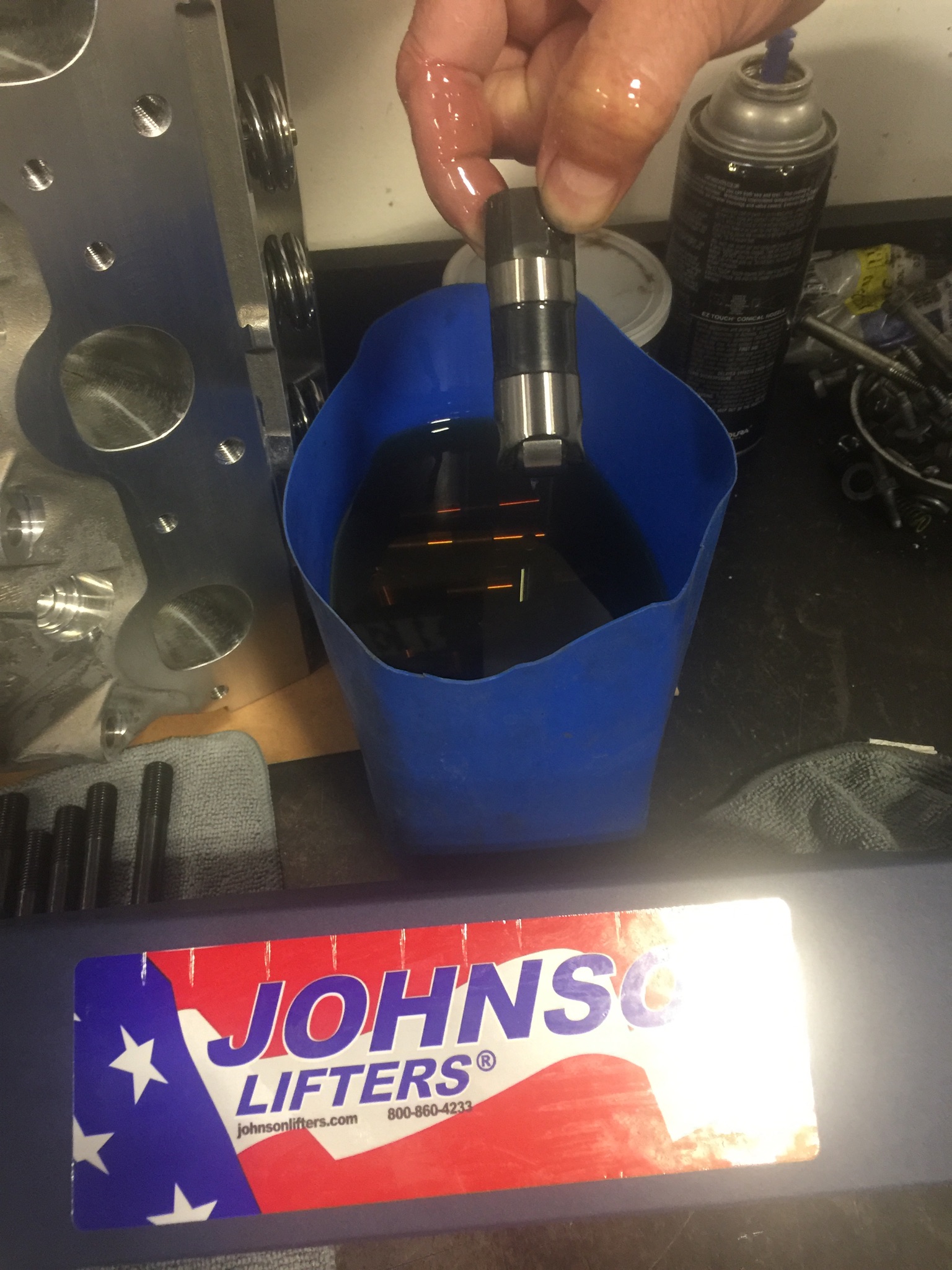

GPI LSA Build Continues!
Johnson lifters being installed! Soon, the ported heads...
