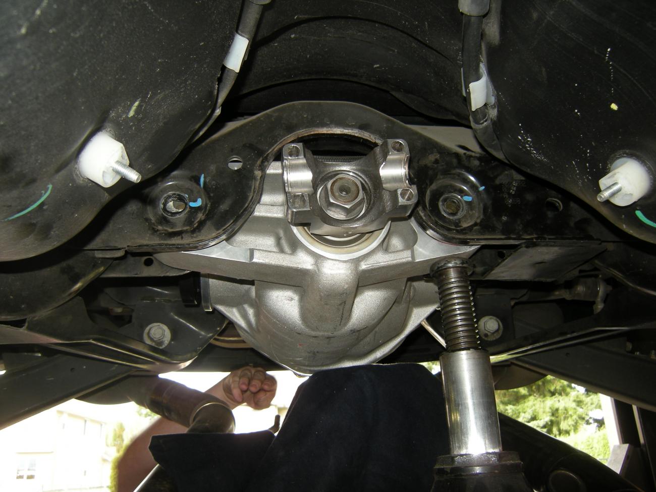

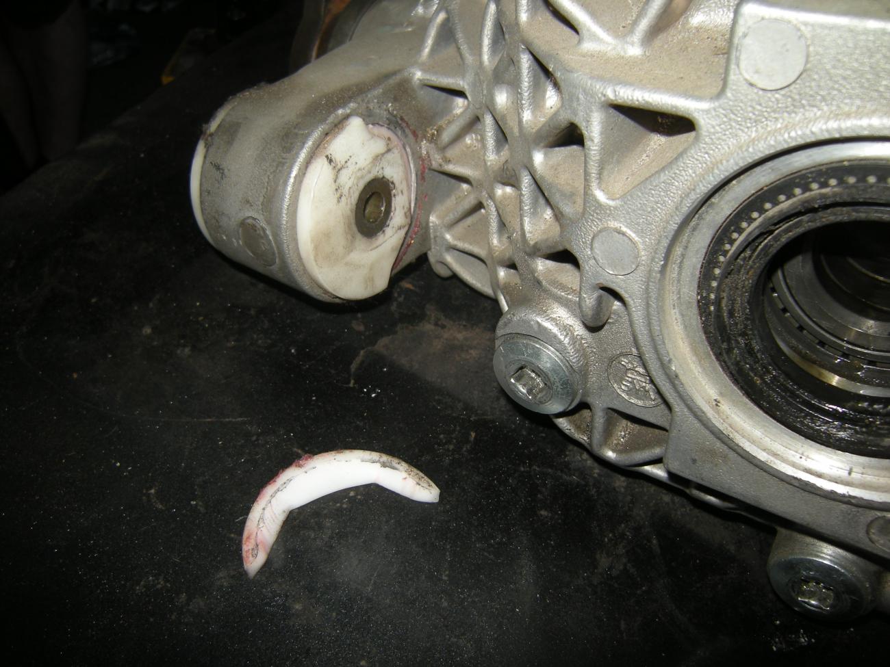

OUCH! Those BMR bushings were suppose to be almost as hard as aluminum ones.

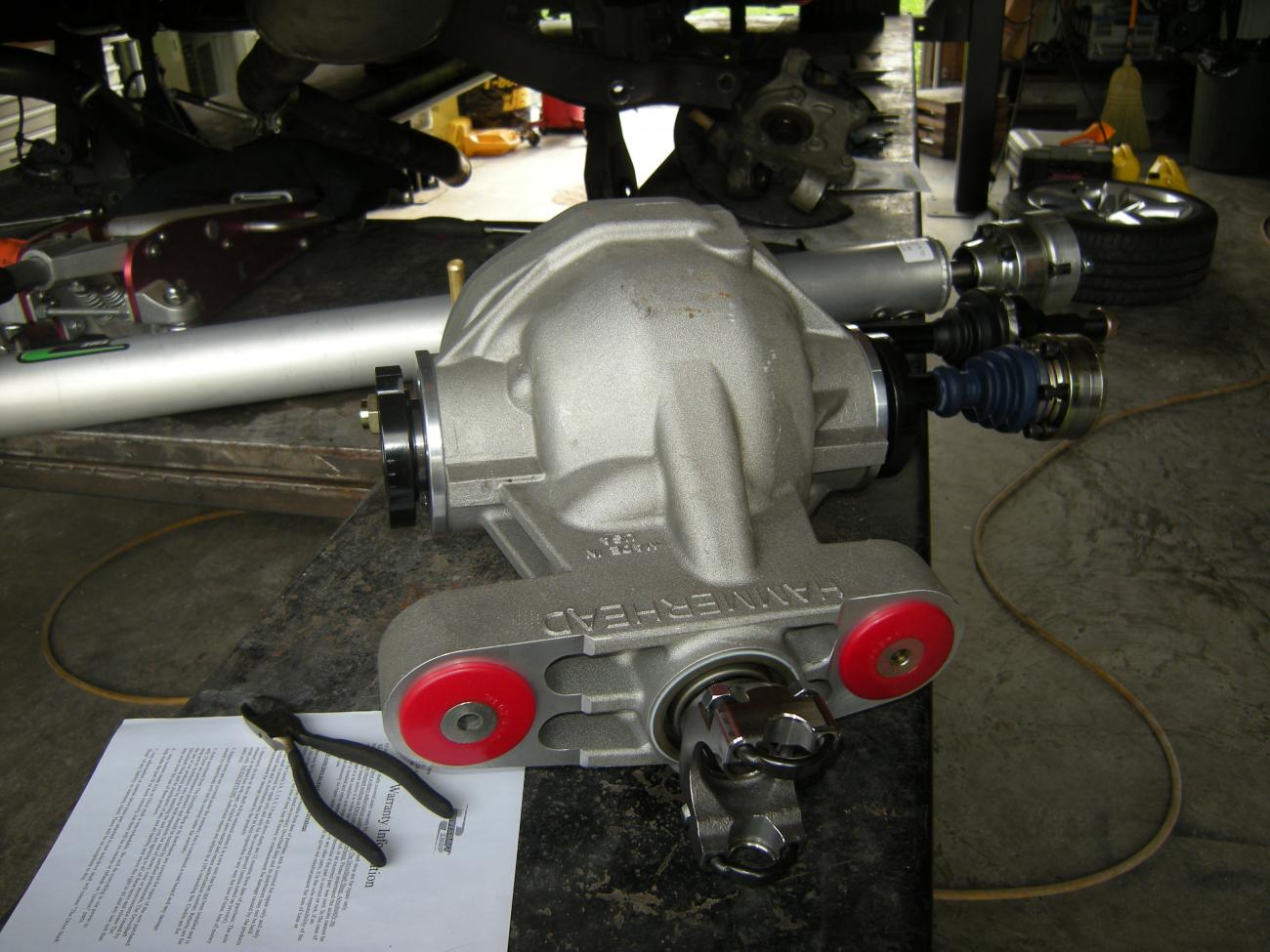

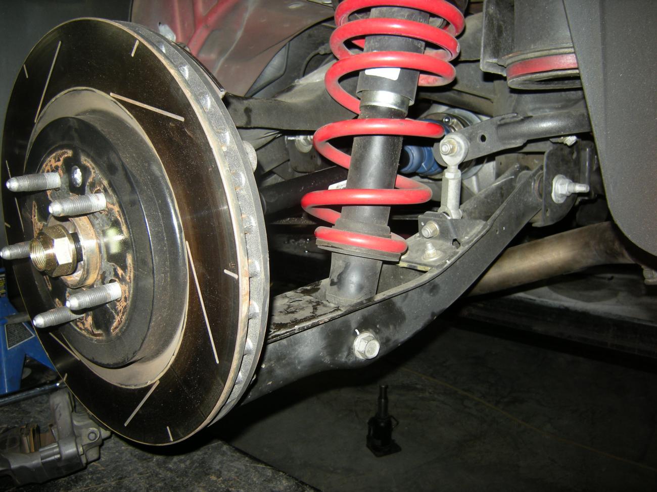

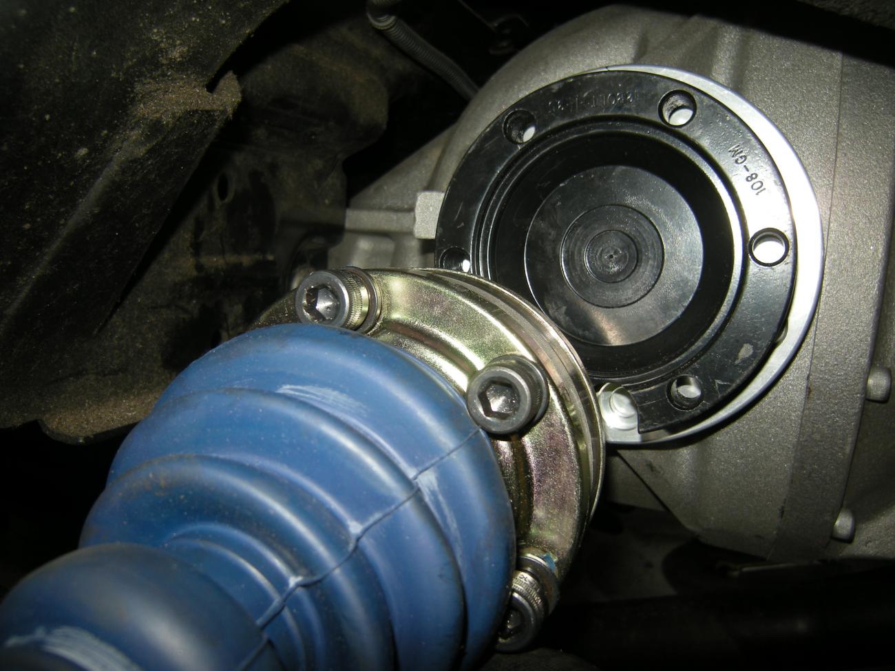

Here we go with part one of the 12 bolt Hammerhead install.

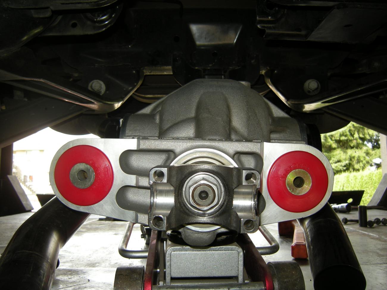

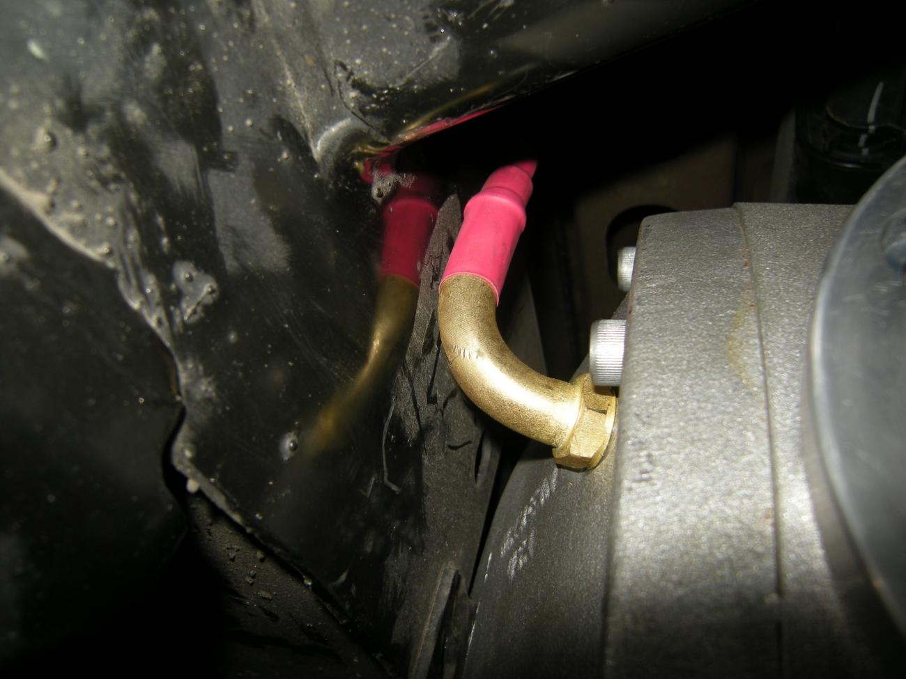

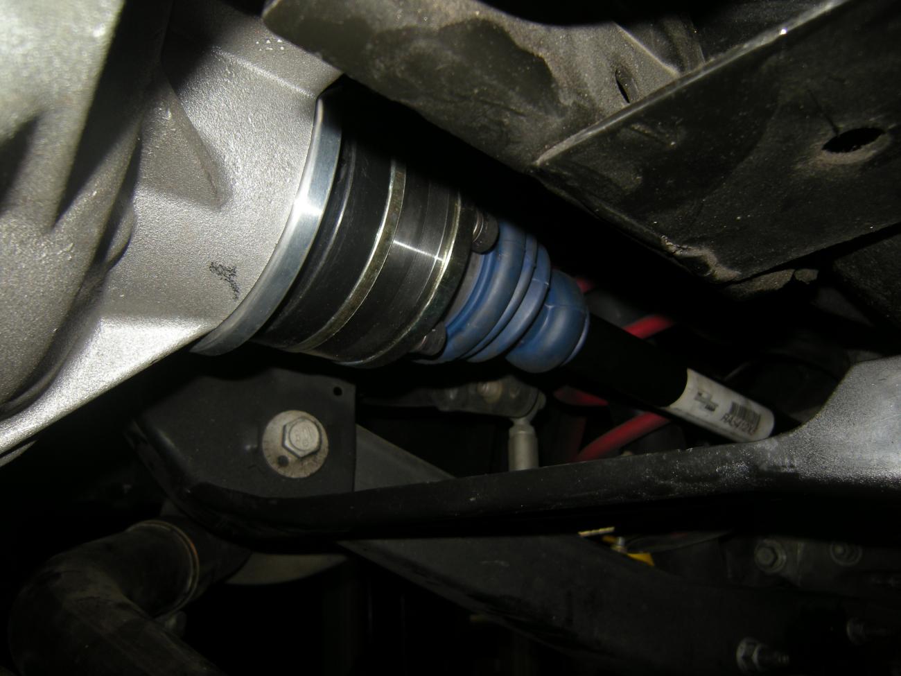

This pic might be one of interest in regards to the diff vent. For the time being we slid a piece of tube inside the the vent fitting then slid the stock vent tube inside of it and used a piece of heat shrink tube to hold it all in place. This fix is temporary til I figure out what AN fittings and hose I want to use.

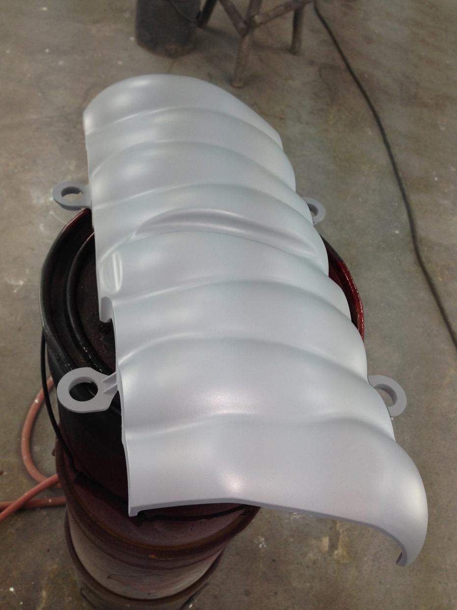

Even Ken at Straddle Craft did a little work on Pumpkin today. Manifold cover ready for final sand and a splash of IOM. Pumpkin will look pretty now even with the engine cover off.

THX! Primer soon to be IOM. Lot's of the time I have the engine cover off for cooling purposes, once I do the heater hose relocation when I swap manifolds out Pumpkin will still look decent.

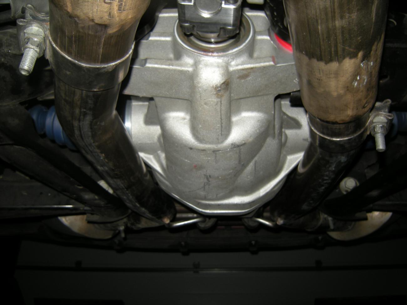

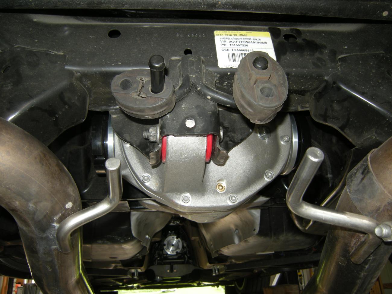

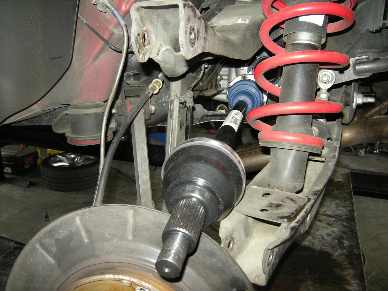

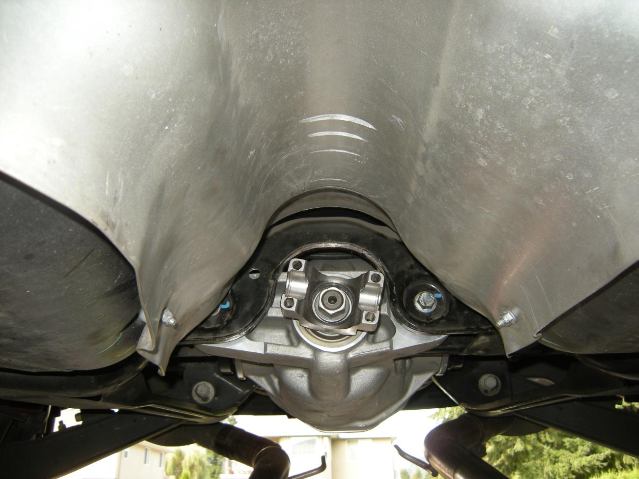

Finally I was able to get back to the Hammerhead project to finish it off last night. We were able to take Pumpkin for the first heat cycle on the new diff between rain storms last night. Here are the last few pic's of the install.

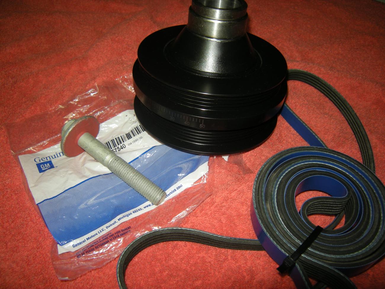

Starting to collect parts for winter time mod's. Got to keep up with the Jones. Thanks to JRE.
