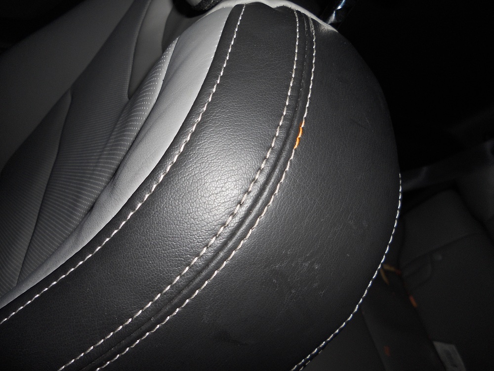

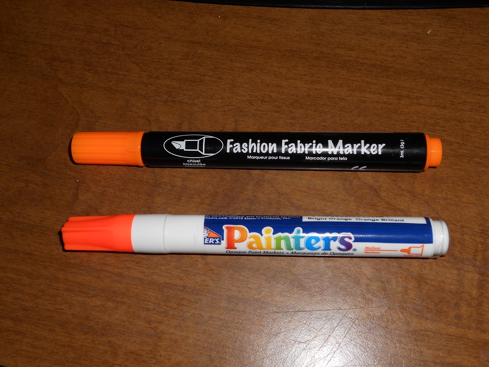

heres the ones i got....
the psinters was got at walmart, and the fabric marker is from michaels craft stores.
my car is synergy green, so im not looking for a match for IOM ,
i am trying to find the closest match to the flo orange that some of the accents on the car are.
im including a pic of the couple stitches i did with the marker,it looks pretty good actualy.
both the markers are labeled "neon orange"

i will say the neon orange most closely matches the other orange accents on the car.

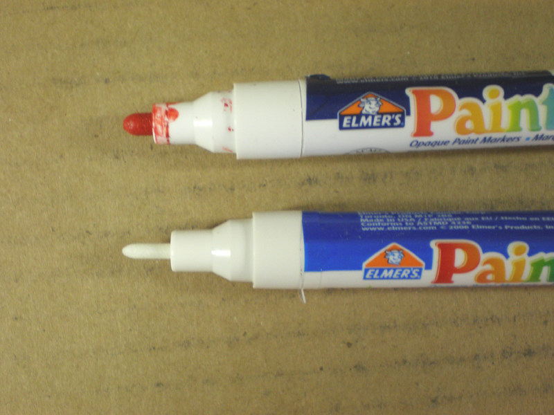

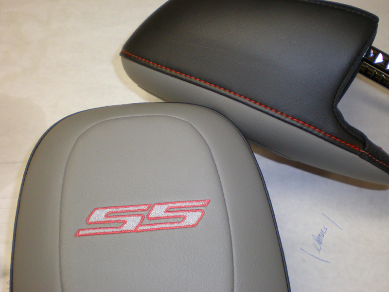

I have tested the 5 different makers/pens used here by all who have posted. Based on my tests results, I am going to do mine with the Elmer's Painter's pens.
I went back to Jo-Ann Fabrics and get a second pen and I noticed that they come in two different sizes of tips; a medium (used by most people here) and a fine. The medium tip is about 3/16" (.081"/2.05mm) and the fine is about half that size, (.043"/1.1mm).
I'm thinking that the fine tip may be a better way to go (see photo). Less wasted paint, less paint on unwanted areas, less paint to wipe off and certainly wide enough to cover the stitching. I bought two fine tips to do my entire interior.
I also have attached a couple photos showing the dyed stitching and logo outline on my headrests. The stitching was done with Elmer's Painter's pen and red outline on the logo was done with Fabric Mate. The logo needs to be darkened...a little too pink.

Lookin good! Were you able to do the stitching on the cloth parts (around the base of the seats, etc) without incident?
Yes, and the bottom of the headrests are cloth also. I used the Fabric Mate fine tip on the cloth areas....one stitch at a time.
