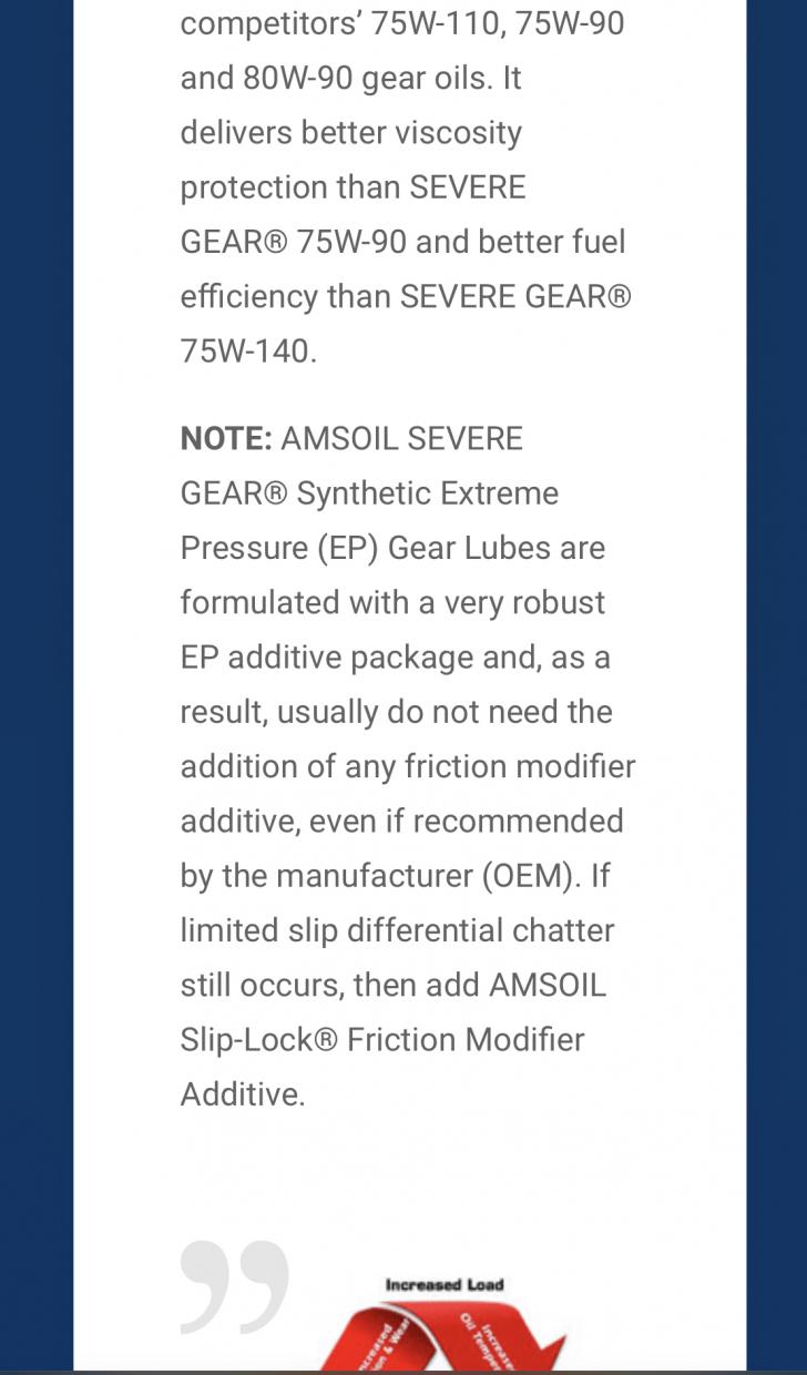

Just did this over the weekend (I'm at 35K). You guys weren't kidding, that stuff stinks. Replaced with Amsoil and their additive. I'm not sure how much of this is in my head but it seems smoother especially at low speeds. Good stuff.
I’m looking on Amsoil site and can’t find anything on a separate additive. Could you let me know what you used?
Thanks
Found this note:

Originally Posted by SIM GhostrdrZ View Post
Found this note:
Much appreciated!
