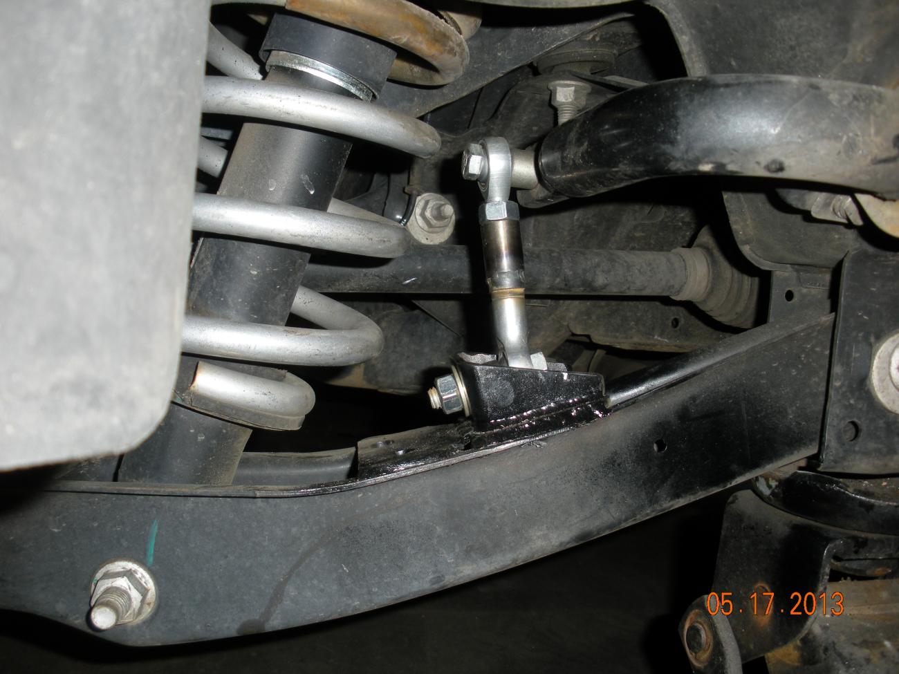

Had a chance to deal with the broken endlink and mounting brackets. I made new brackets out of much heavier stock, I also made a plate that lays across the control arm boxing it for extra strength and more rigidity, I also increased the hole diameter to 7/16 so I could utilize larger Heim joints for the endlinks I made. Here are a few pics of the project.

Out of curiousity, why didnt you just got with the Pedders reinforcement brackets? Not trying to discredit what you did, just curious why you went the DIY route versus an existing fix.

Many reasons, the Pedders bracket is to reinforce the existing one, mine was destroyed. My bracket is heavier and gives the control arm added strength, my set up utilizes larger links for more strength and mine was made of in house materials costing me nothing but a little time. Why would I buy something I can make better and cheaper.

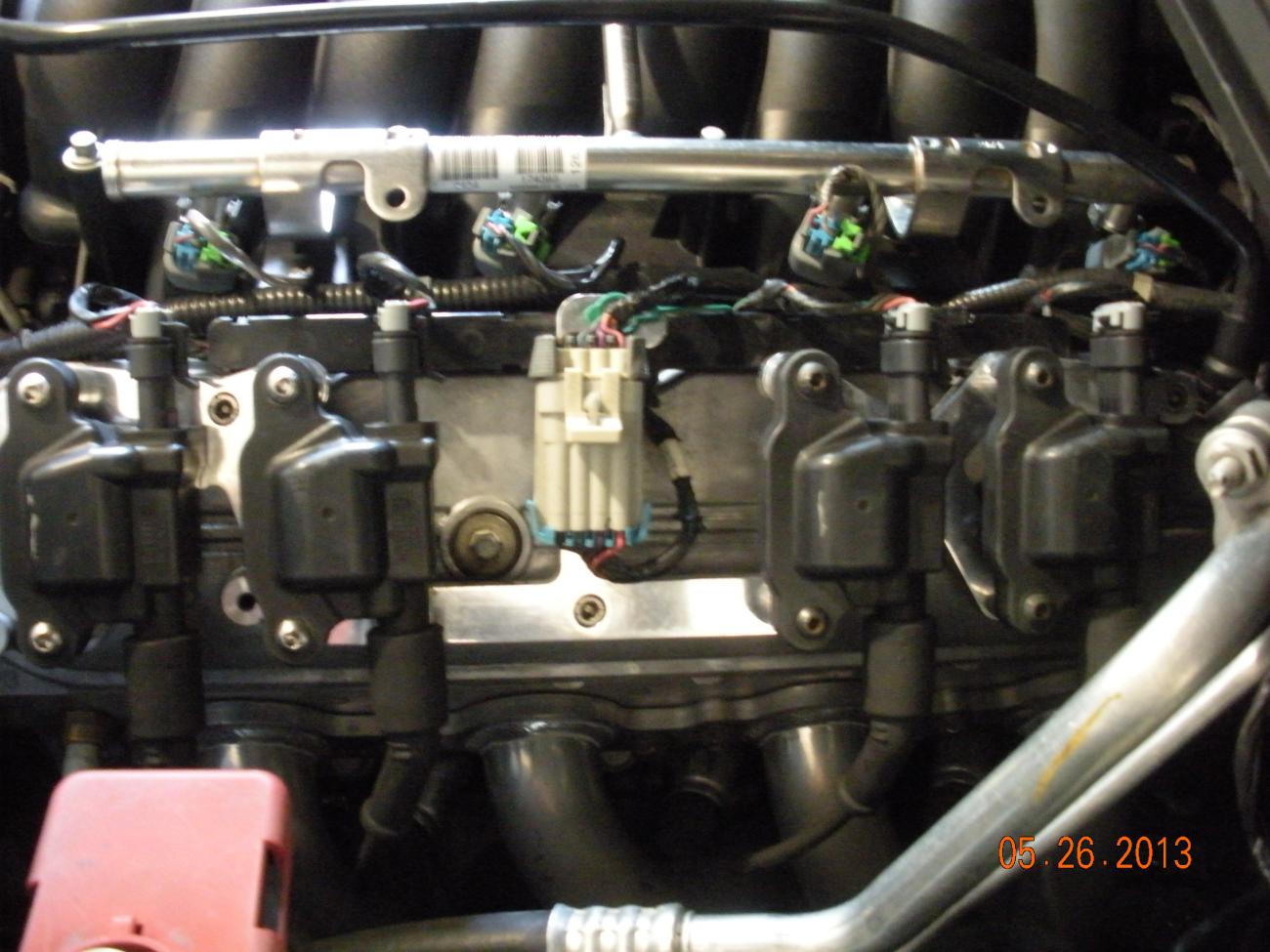

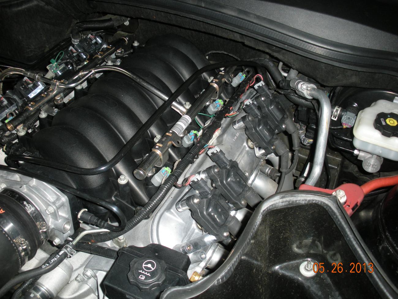

Had a chance to play with my car a bit so decided to finish up with my coil mounts. The ones I've had on my car, in the first photo, directly replaces the stock ones, utilizing the mounting for the plug and harness. I decided to go with a two piece version which allowed me to get rid of the stock wiring housing to the injectors and form the harness to fit more naturally and cosmetically pleasing. The pictures below show the two piece brackets with the stock harness and with the stock harness modified. No cutting of wires or unplugging pins. Also uses the stock plug wires. I will be adding these to the one piece mounts I have been selling as soon as I finish a few small things I'm thinking of such as a bracket/cover for the wiring harness. I'll post pics as I get further into it.

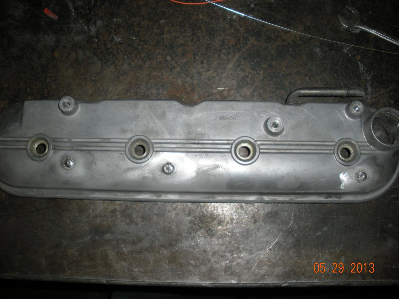

Working on my valve covers. First I cut off the unused tabs, ground them down and welded the remaining holes and cleaned them up for powdercoating (I decided to coat them textured black instead of polishing them). The pictures below are up to where they are now, the last picture compares one that is ready to a virgin one. I will update this as I proceed.
