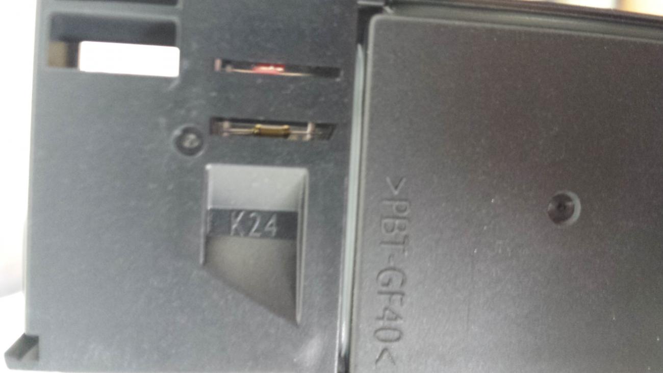

I have a K24 but my car bucks at idle and sometimes has a hard time trying to get started. Not a hard time kicking over, just hard time starting. I did the #5 and 20 fuse pull and the idle has gotten better, but it is still somewhat noticeable that it bucks. What are other symptoms of a bad mass airflow sensor and also how do you clean one? I thought for sure until I pulled mine out that it would be a weak one.
You can find Mass Airflow Cleaner in most auto parts stores.

Posts: 7,069
pull it out of the car after you have driven it 20min or so so its hot then spray it with MAF cleaner let it dry then put it back in.

Posts: 7,079
This is my before picture on my MAF sensor. Am I just crazy or does it look clean already?
