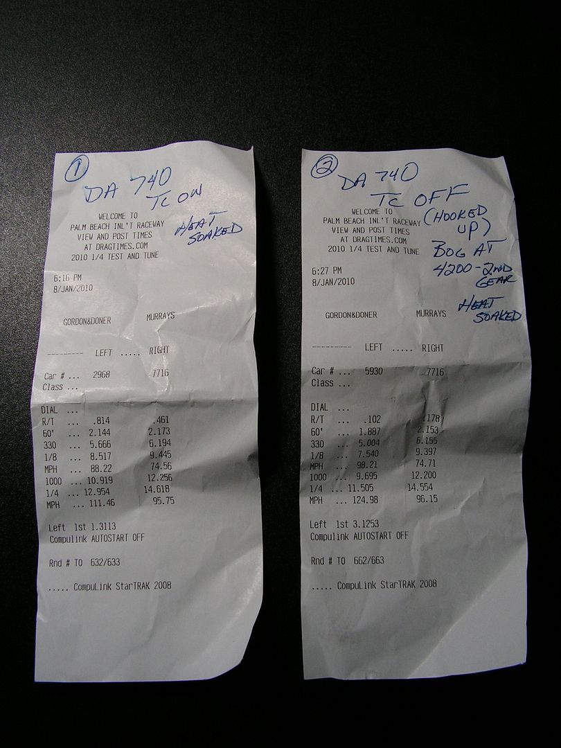

On the subject of the Trifecta Tune... I did my first runs at the track on the tune with NO improvement in either time or, more importantly, MPH! I did not have the tranny tune installed for these first runs so I could give a read of how much just the engine tune helped in the 1/4 mile. I loaded the TCM tune and was in the lanes when the rain came Friday nite so I didn't get a run with it installed.
Here are my 2 runs... You will notice that both are lower than my best of 14.18@ 96.42 MPH. I did not have the same good conditions this time so, some slowing is expected... like .2-.3 seconds. I also posted slower 60' times! I lost .10 from my previous there which could be heat soaked IAT to some degree.
Now, I know these 2 runs should have shown some improvement it ET and MPH if there was really a 24 HP gain from the tune... even if the conditions were not good traction wise the additional HP should have shown up in more MPH! I'm just not seeing it!
Like Scrming, I logged the runs and will send them to Vince for review and possibly a tweak here or there..... It is possible that the AFR Vince has set in this tune is "safe" but doesn't make HP on this engine and we will need to go leaner/richer to get the results....
I must also report that I've shown a loss in gas milage of 2-3 MPG in town on this tune.
I did also try out the tranny tune and find the shifting to be somewhat better but not enough for my tastes!
I would suggest anyone considering this tune to wait a couple of weeks till we get this sorted out better and can give definitive results on the gains.
I'm reminded of an old saying... "just because you can doesn't mean that you should!" yet!

Ok... just to add what Beauwulf said...
I did in fact dyno my car yesterday. We started out with Vince's tune in the car and remember this is with the JBAs... We did 3 pulls. The results were from 250 RWHP to 254 RWHP and 228 RWTQ to 233 RWTQ. My previous best dyno session was 255 RWHP to 233 RWTQ.
I then loaded the stock tune back into the car and we made 2 more pulls. They were 254 and 253 RWHP with 231 RWTQ.
Today I went out and did a 0-60 run... Absolutely identical to my last 0-60 run before the JBAs and Tune...
So basically the cars performance is unchanged with the JBAs and Vince's Tune. And to me this goes along exactly with what Beauwulf found... For some reason our cars just aren't responding to the tune...
Now, I did log both a tuned and untuned pull on the dyno... So i have that data...
I think before we all rush to judgment on all of this we need to wait for Vince to get back and review all Beauwulf's data and mine... Definitely want to be as fair as possible!
I am a bit embarrassed though... I made some casual observations and it's apparent that my butt dyno 2000 needs to be recalibrated! I should have known better to comment on things without have all my data! argh...
So now I just need to wait until Vince gets back...
