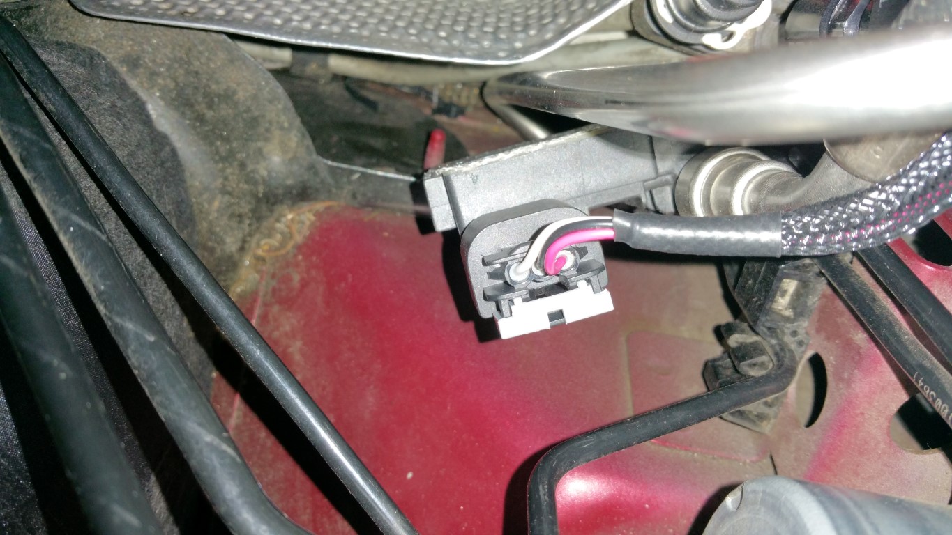

Doing some logging... found the alcohol content goes from 79% to 0% around 5k rpm -- AFR is still commanded between 8.75 and 10.25. No KR, no DTCs -- looks totally electrical. Checking the wiring to see if a wire is pinched or not. Moved the connector from one coil to another... still did it. I ordered a new harness from Dave @ DSX (this is not something wrong with his work, I had to splice into the harness to test, so, rather make sure 100%) -- he's great to work with. What can I say, ah the fun of modding...

I did ;o), I think a wire pinched or, heat related due to where I have the sensor. This sensor, I bought from a GM dealer when the last one went out. I have a pass through obdll Bluetooth unit coming so I can do some testing/logging. I can use my phone to monitor alcohol content while I log with hp tuners as I fiddle with the wiring and sensor....
Dave did sent me a replacement so I have that one also...
Gm has had issues with the flex fuel sensors in the past... looking to see if any where heat related...

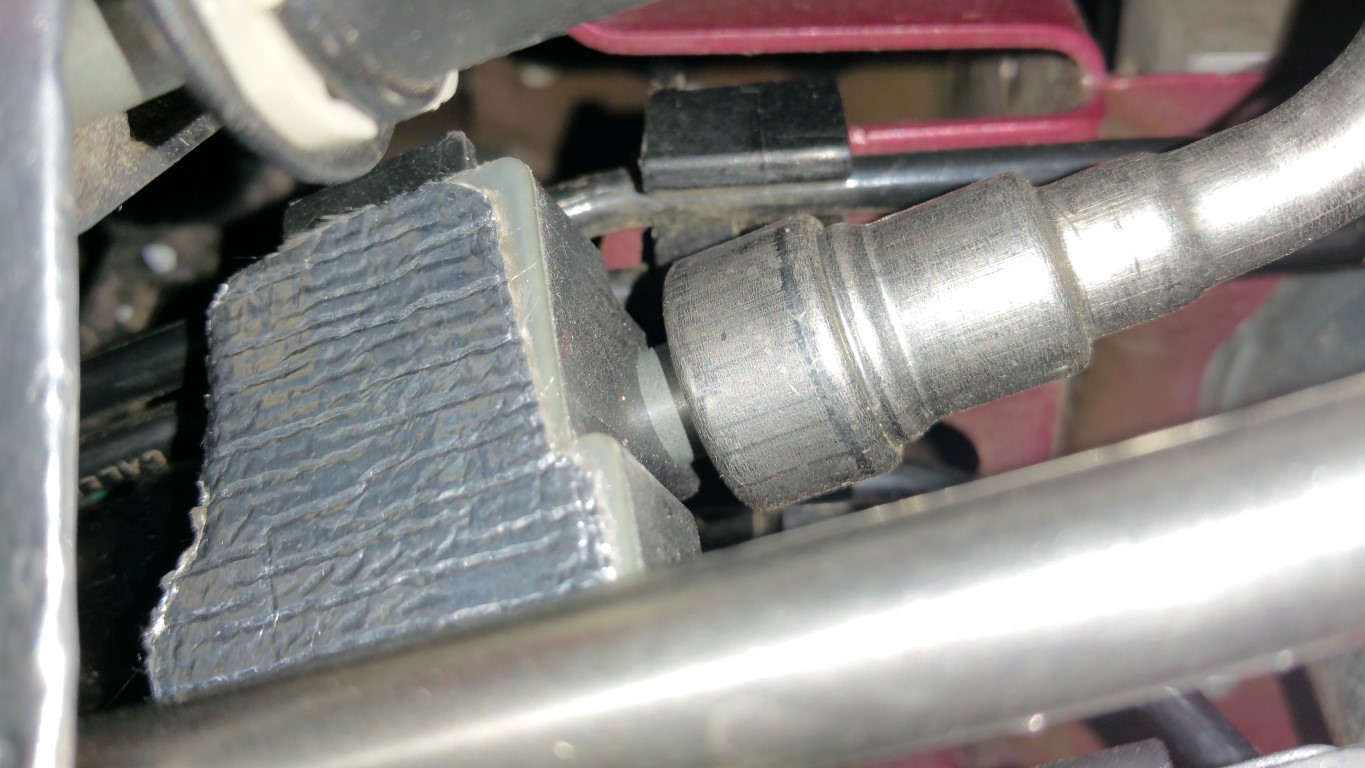

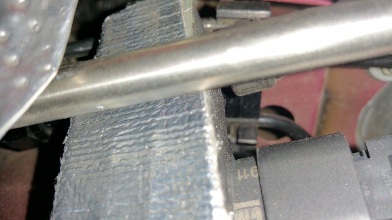

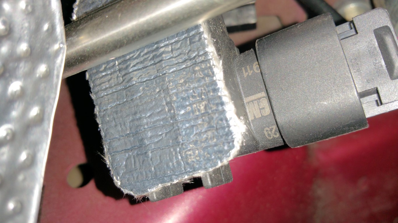

Flex Fuel Sensor Issue 2

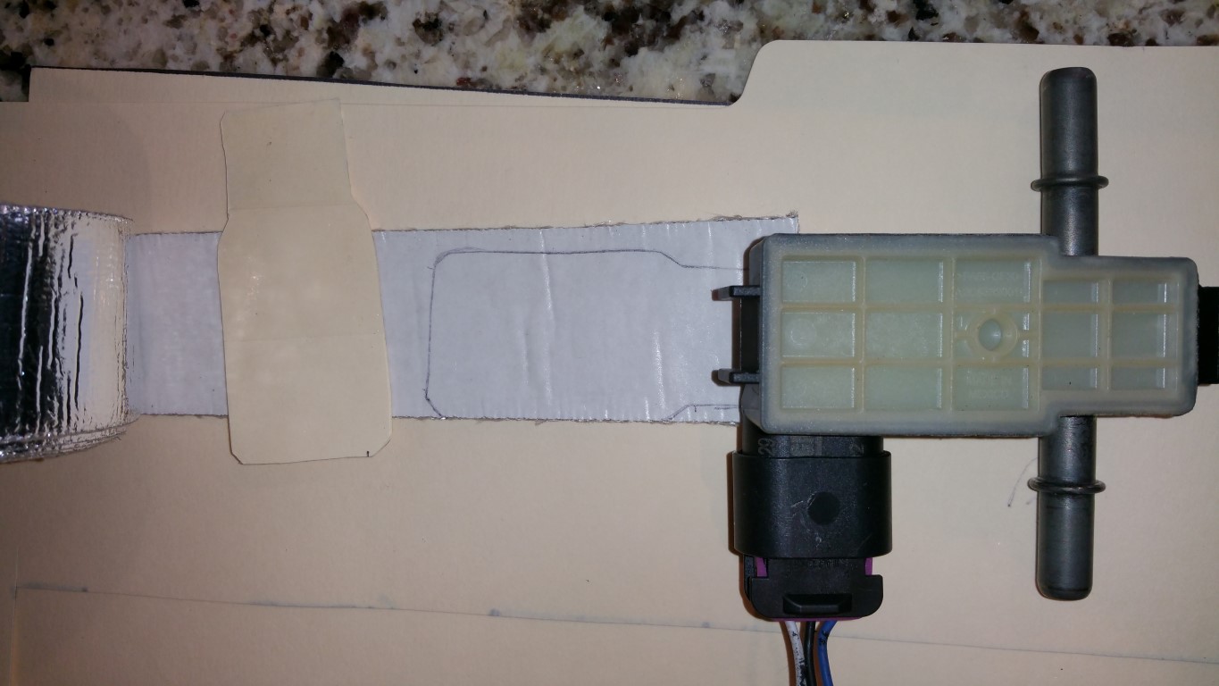

As a precaution -- since this sensor is so close to the headers, I added the Kevlar aluminized shielding to the back of the sensor -- this is to help not only with the heat from the headers, but, heat from the SS Fuel line that runs right behind the sensor. Also, I'm going to 'immobilize' the sensor so it does not move around:
so, that should be a testable item now -- if the sensor did not fry from the heat ;o).
I'll give this a go, and should have my harness by Wednesday to verify if this does not fix it -- if after the harness it still does it, I do have a new flex fuel sensor to install -- glad I have that!
what is odd is the fact I tripped no DTC. I fill up the car after every drive so none of the fuel has been there too long. In fact, I drove almost all of the E85 out Saturday -- then filled up again (same place though). If water was in it, I'd expect to see closer to 100% -- going to zero is the exact opposite...
