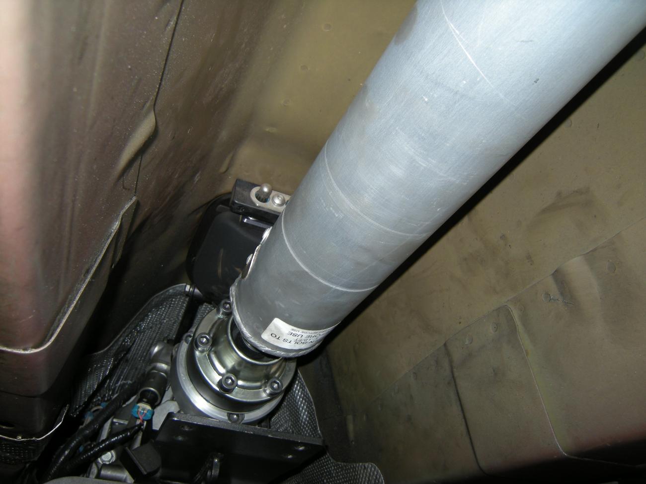

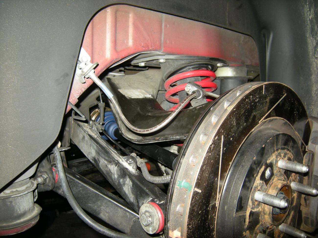

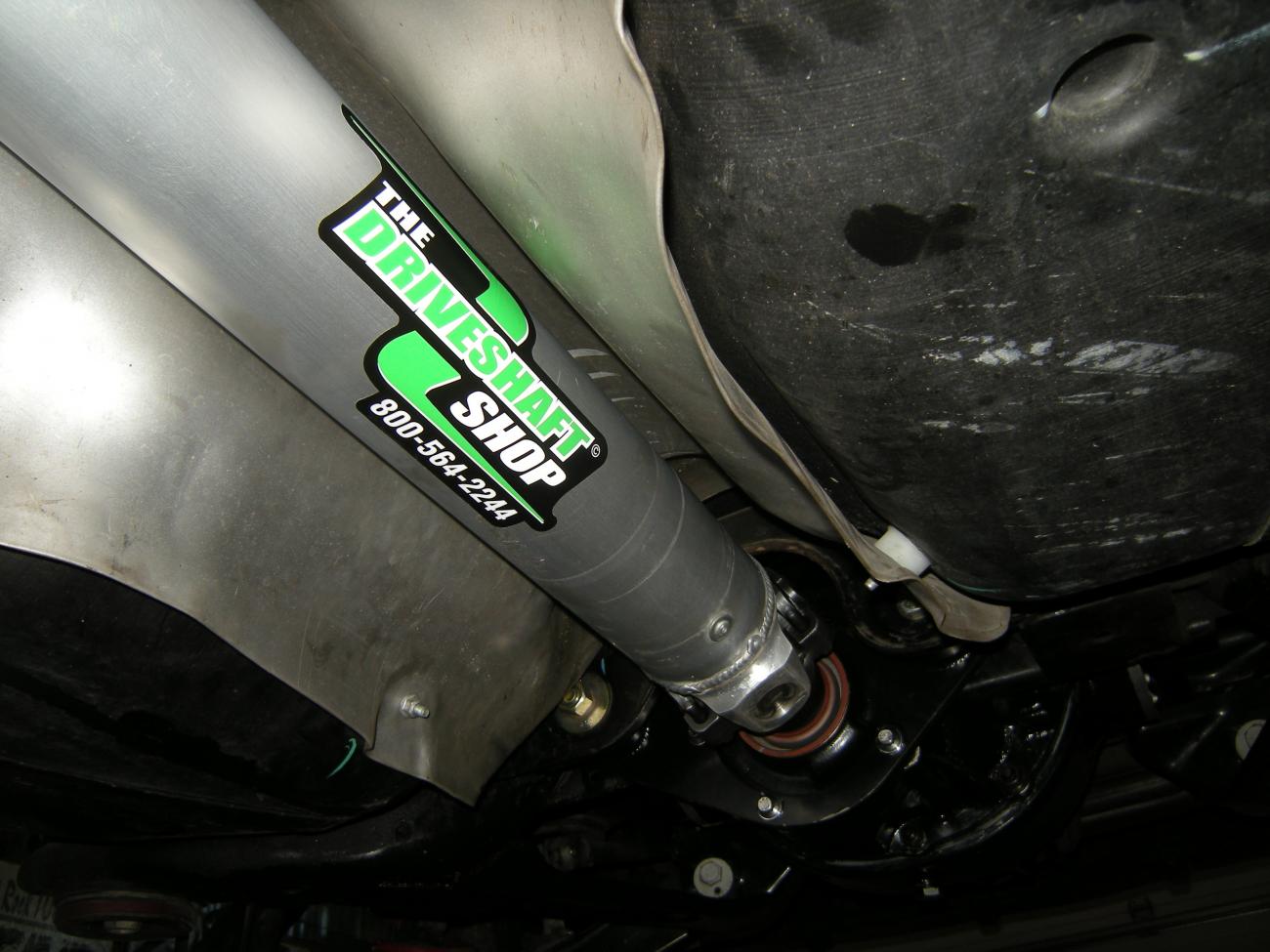

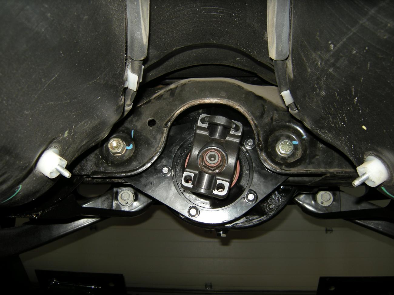

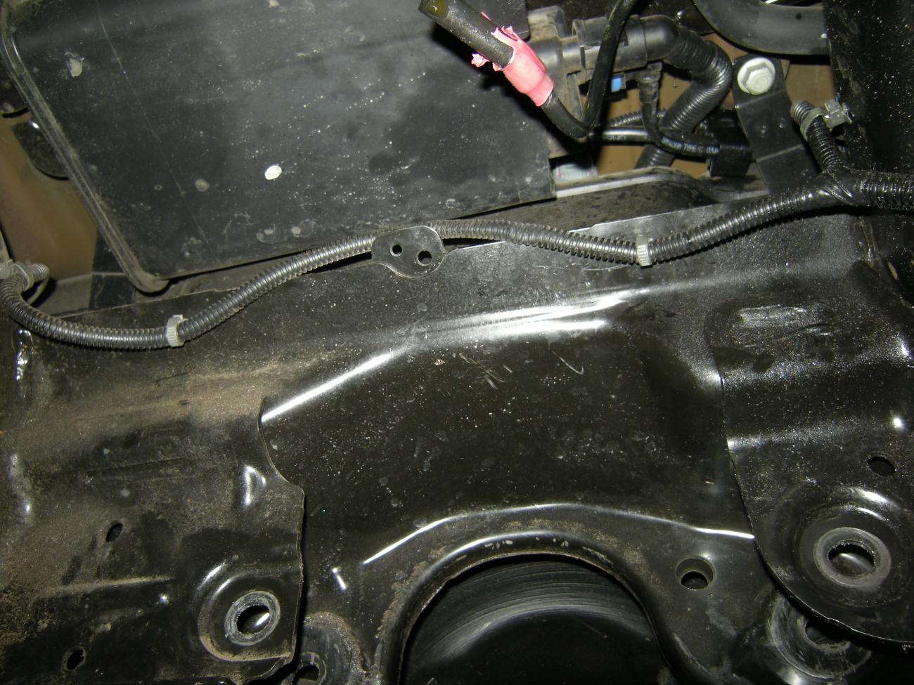

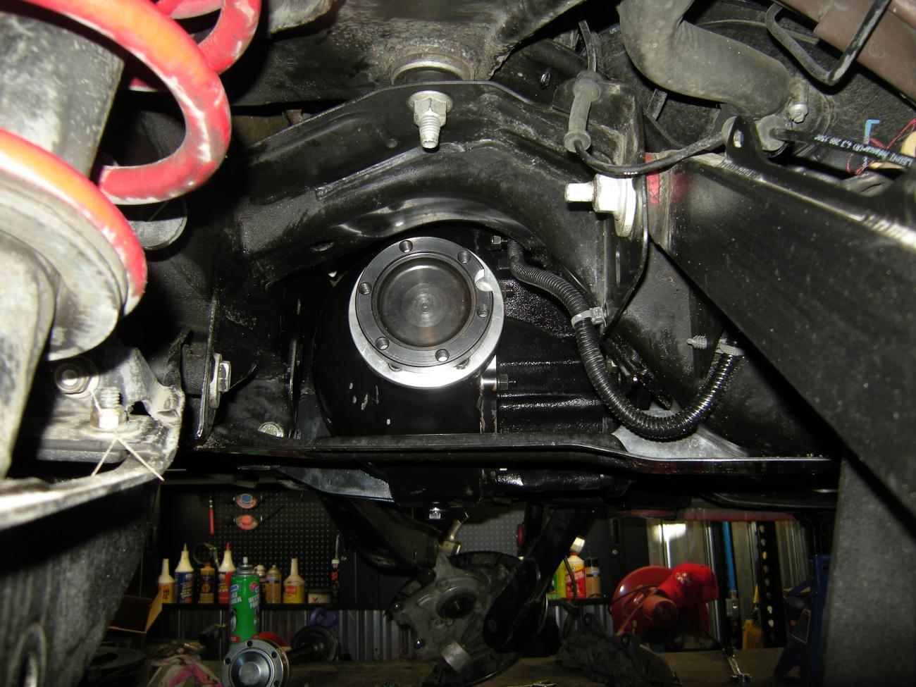

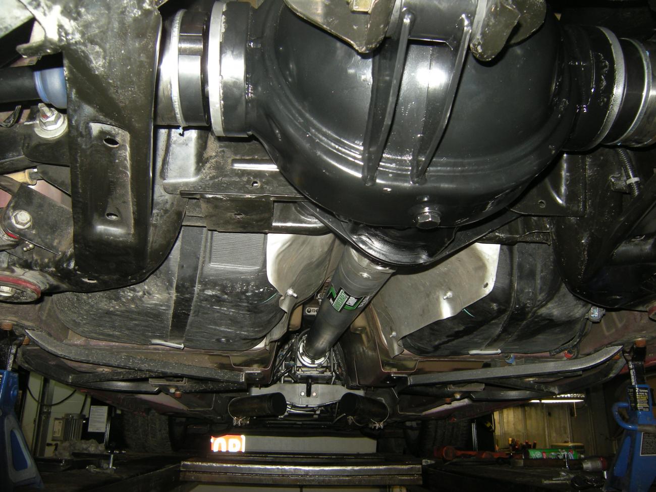

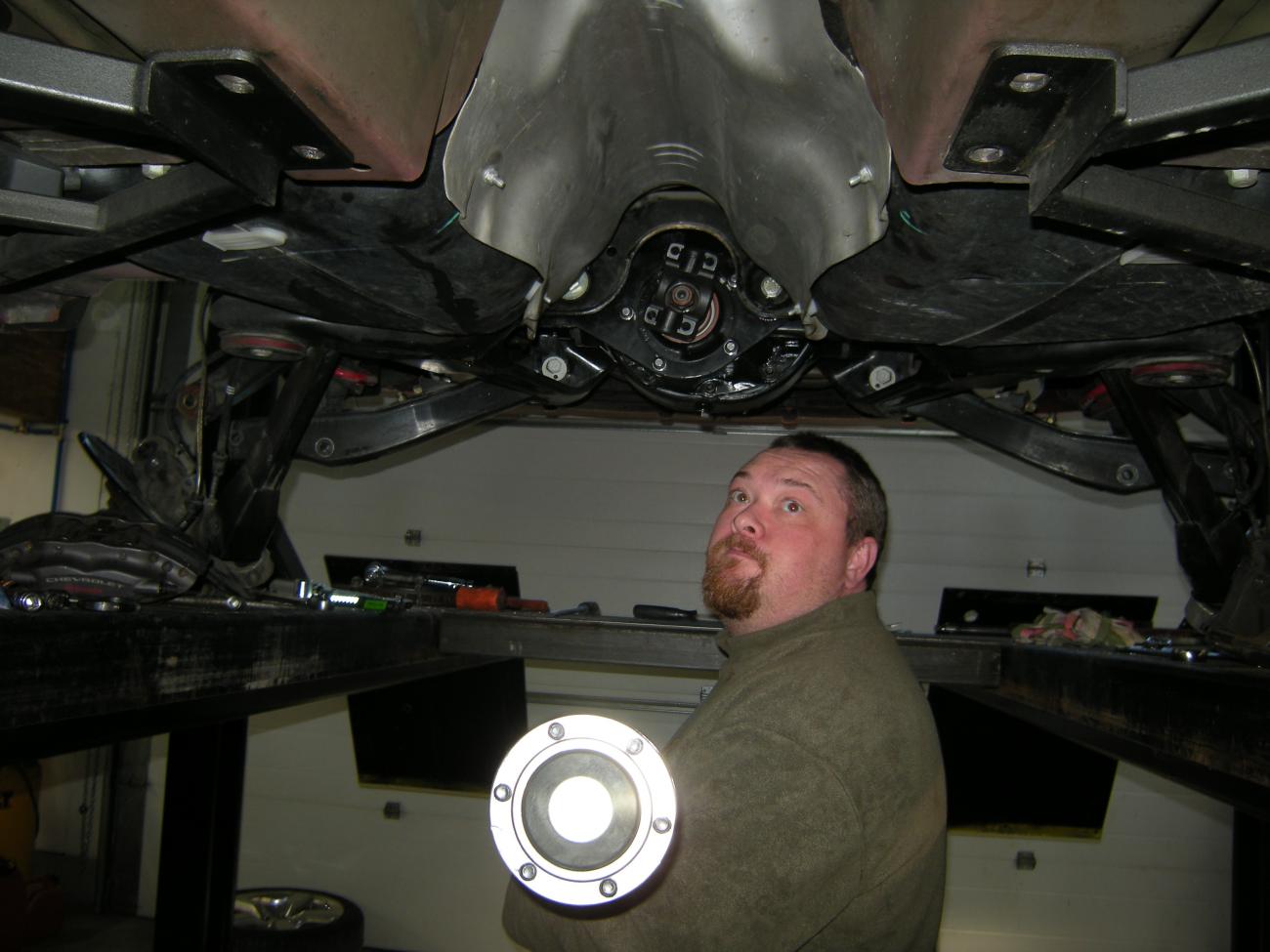

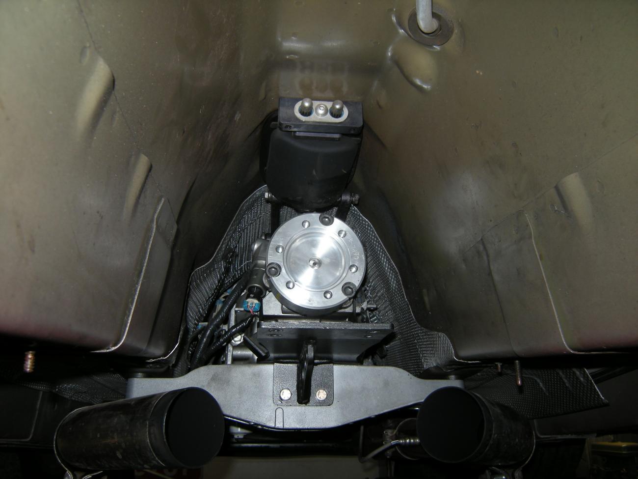

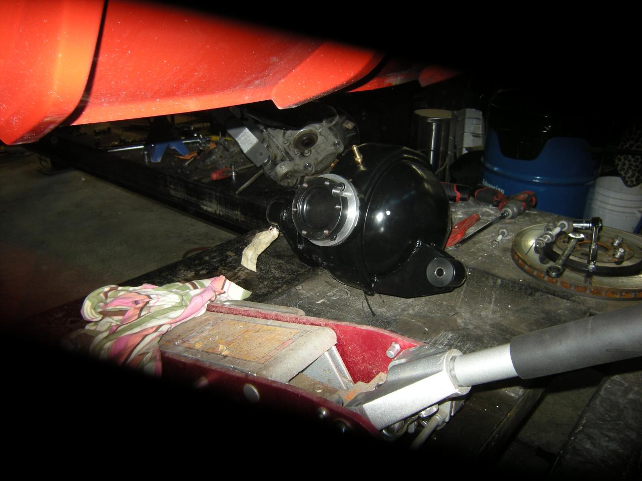

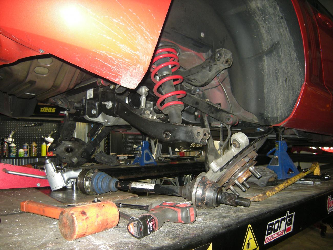

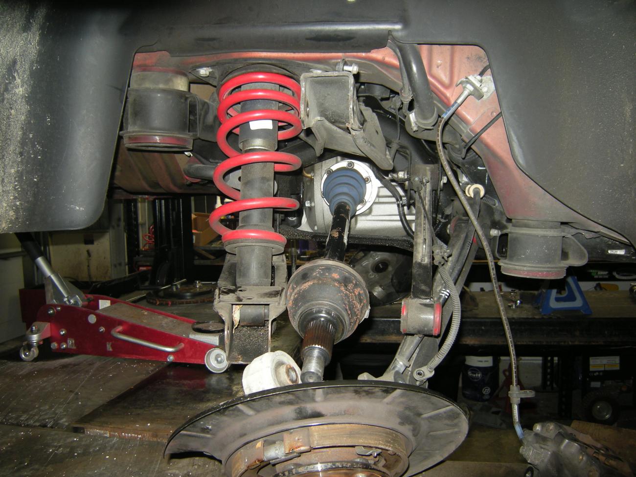

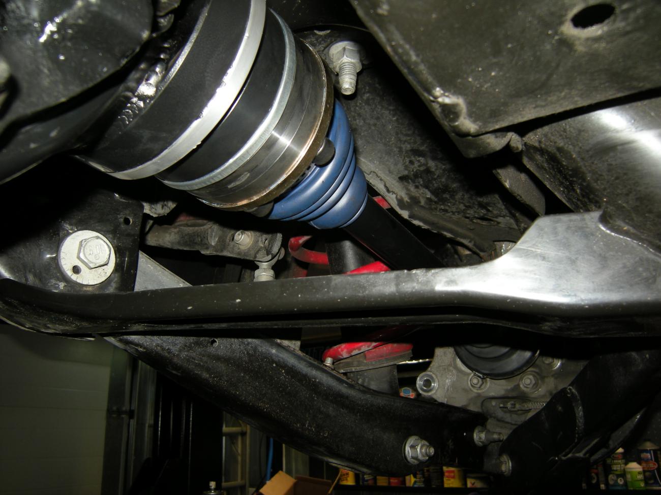

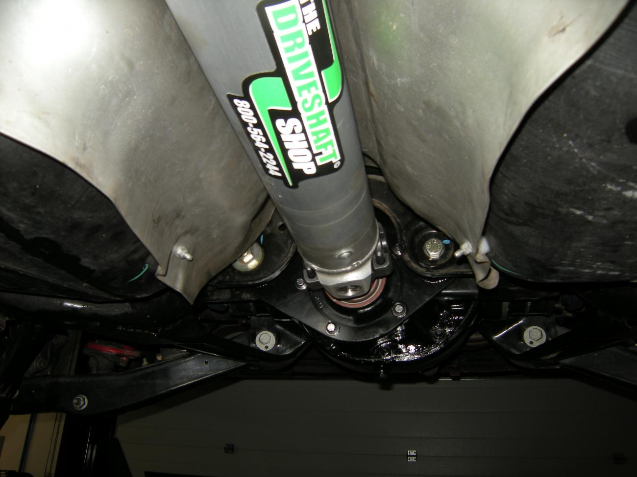

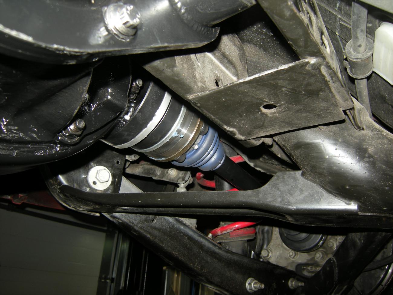

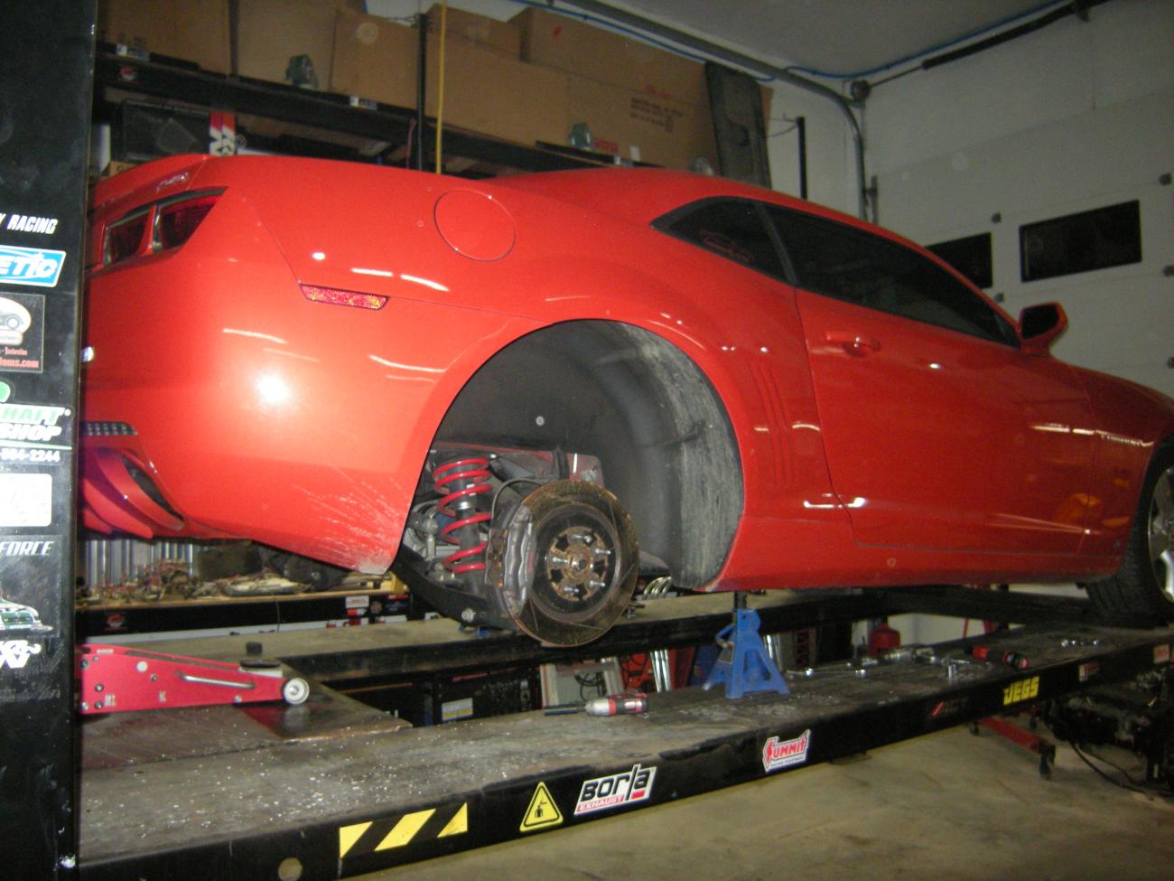

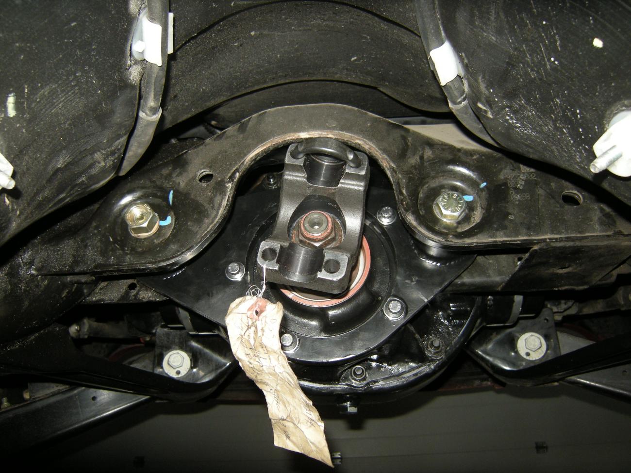

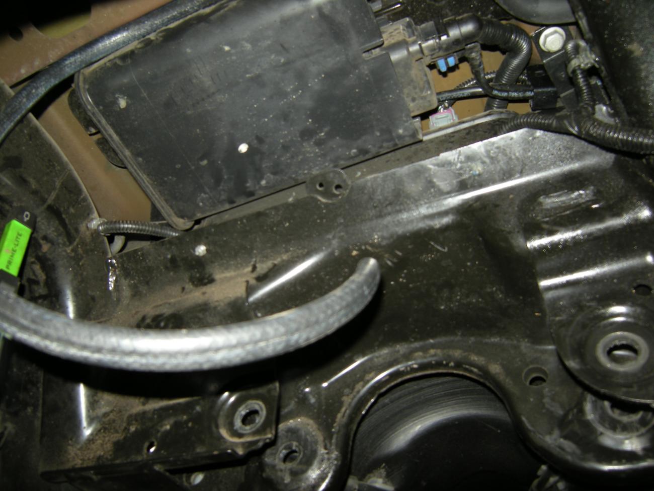

Rolling Pumpkin off the hoist for a quick road test today. Here the pic's from the install. Only small modifications as you can see in the pic's is a wiring harness above the case moved to the top side of the cradle and the diff mounting holes had to be slightly enlarged to suit the 9/16 bolts.

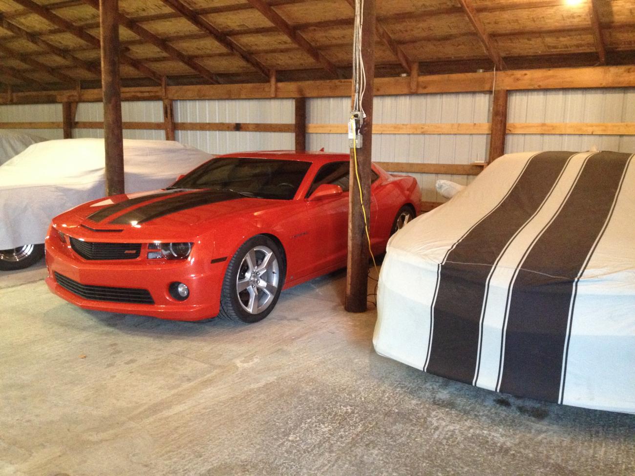

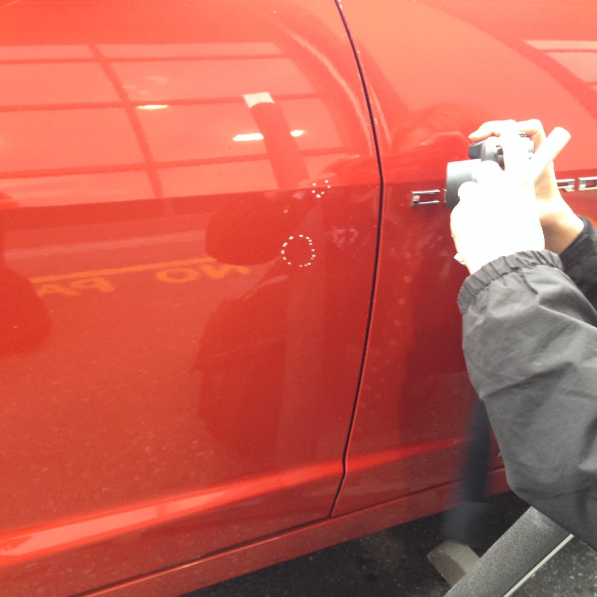

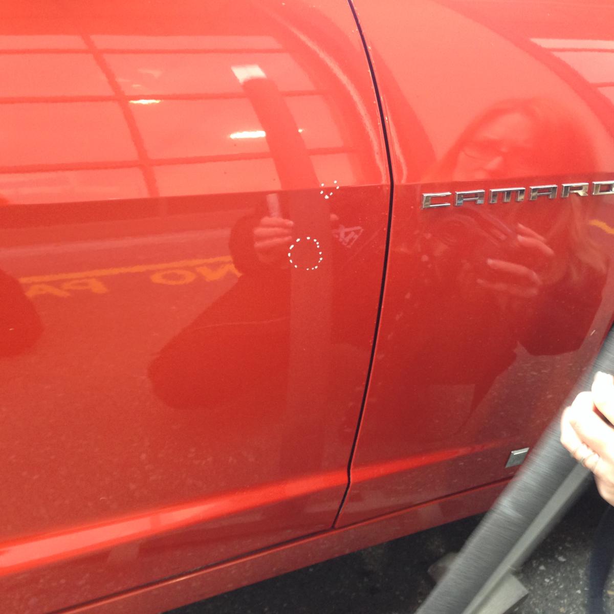

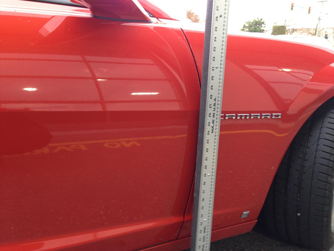

Today was the day to move Pumpkin into hibernation for the winter, but not before a trip to the local body shop to have a door dent estimated. Some careless SOB put a door ding in Pumpkin. Close to a thousand to repair it.
Managed to get a couple more heat cycles on DSS 9", sounds as smooth as silk.
Pumpkin all tucked in next to Skitso for the winter, just have to go back once it's dry for a quick wipe with detail spray and put on the cover.
